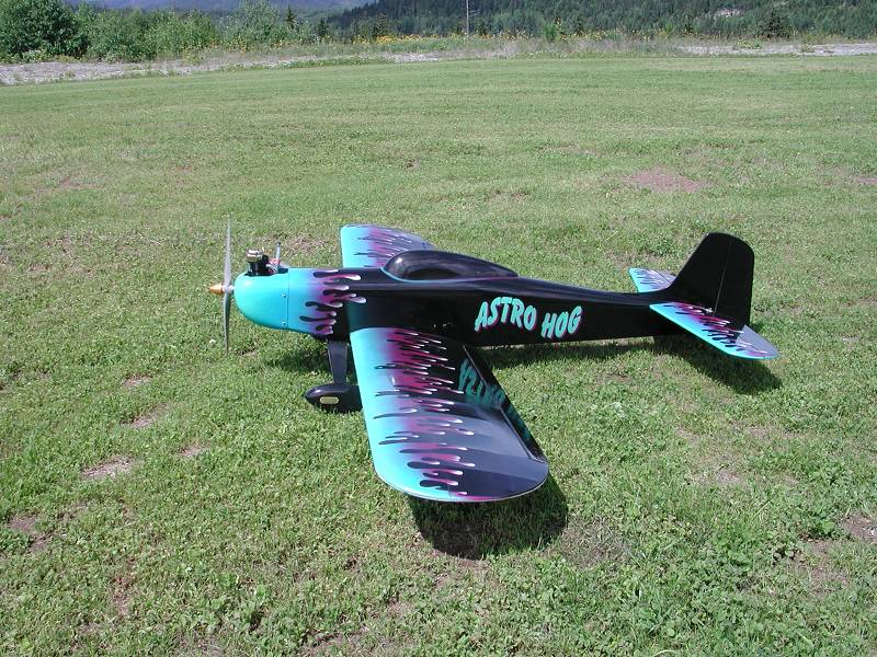

Here is a pic of my hog
Saito 91
extended rudder
2 aileron servos
changed and moved landing gear forward

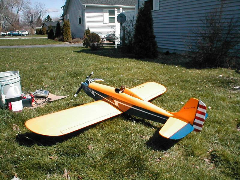

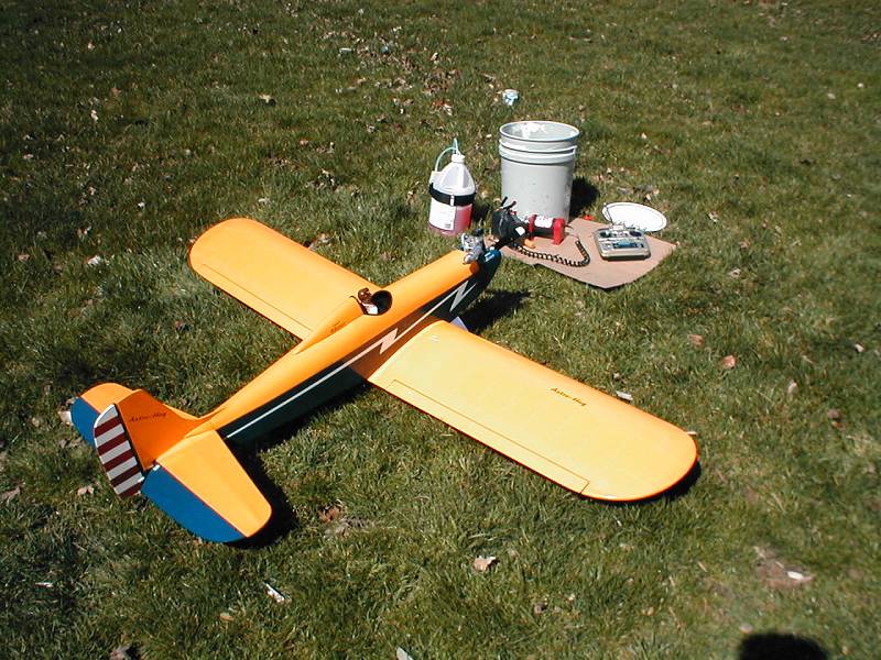

My Astro Hog
O.S. 70 Surpass 4-Stroke 13-6 prop, duel aileron servo's, took out half the dihedral plans called for, mounted landing gear under fusalage to prevent nose-overs. Futaba 3004 standard servo's. Camera takes bad color pics. It is covered in cub yellow and insignia blue monokote. Windshield, canopy and cockpit moulding are on but pic below is not up to date. Lots of carving and sanding on this hog after 3 months. Looks a lot better in person and lots of work building it.
Thanks for all the help and advise on here.
big dan

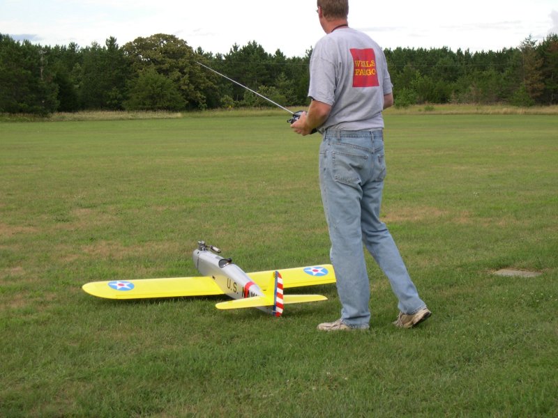

Here's a pic of mine -
Thunder Tiger .91 4-stroke with a MA 14x6. 1/2 the dihedral. Dual standard airleron servo's. I also mounted the main gear on the fuse.
Great flyer.
Scott.

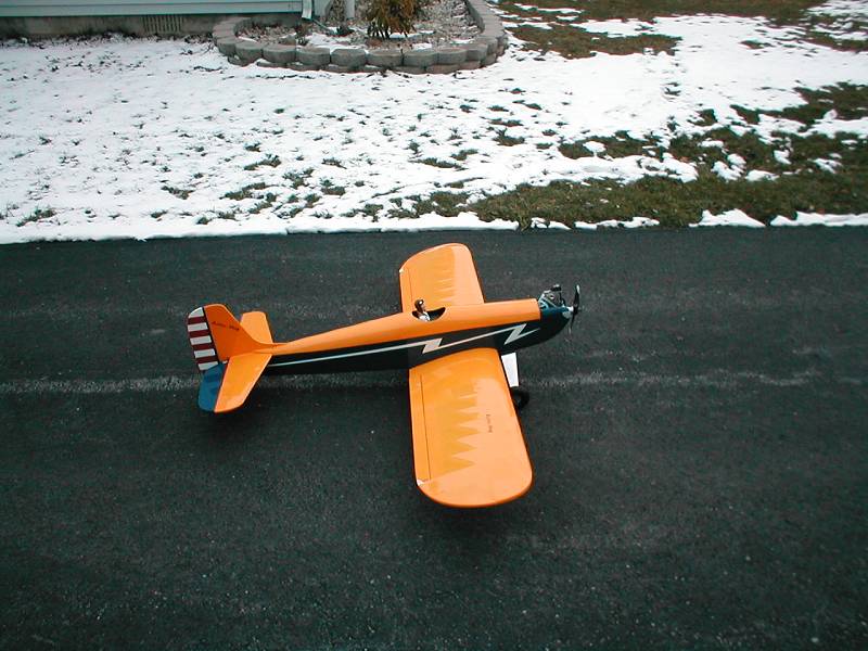

My astro hog again with the canopy on it. Colors are still bad from my camera. Can't wait to fly it.

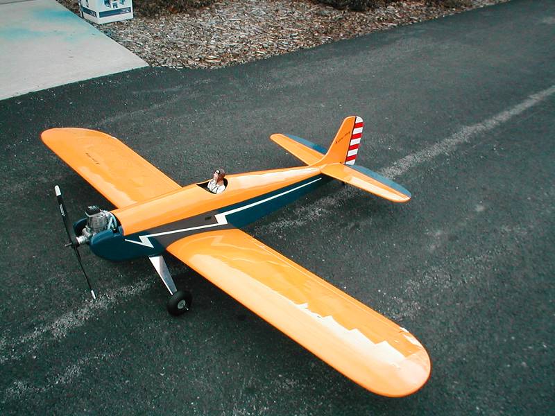

Well, I started breaking in my 4 stroke. Now I'm just waiting for a nice day to try it out.
I have the balance point about 1/8 of an inch towards the rear from the suggested point. I hope that 70 surpass has enough power to get it airborne on it's maiden flight.
Thanks for all the help.
big dan
