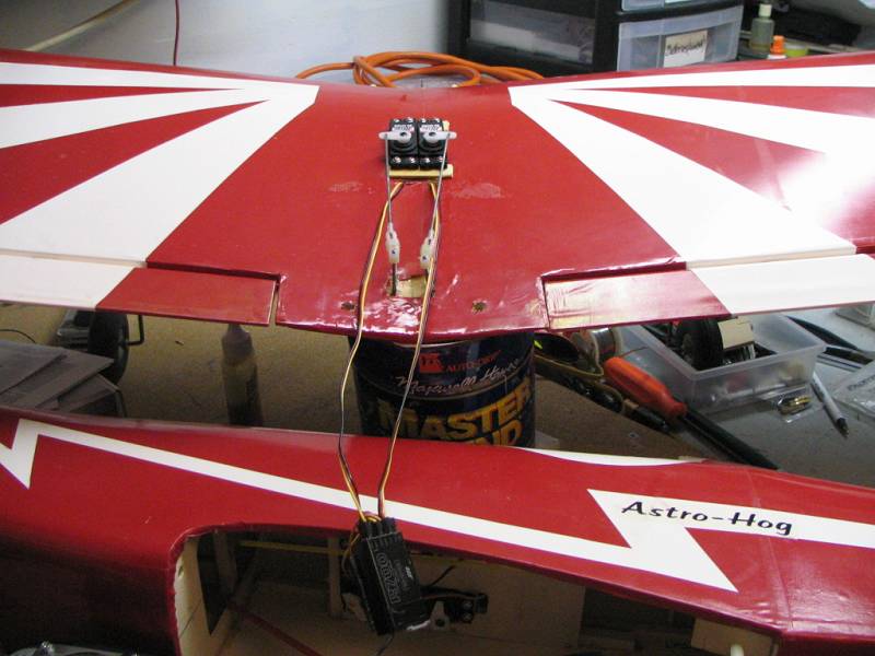

I just mounted two standard servos on the outside. No muss, No fuss. Works fine, and easy acess...Keep the pushrods short, Davy !

Mounting the servos is not the problem. I will have to cut into the wing so I can run the wires towards the center and then out where the original servo hole is. Those four or so ribs will have to have holes in them so the wires can run thru. That is exactly what I did on my buddy's wing.

I under stand....you have to have a path for the servo wires. That's gonna be a pain in the butt. but will be worth it in the end. I know, easy for me to say ! LOL !
Before you start cutting, try it with ONE servo. maybe you'll like it. Just don't pull to many "G"'s

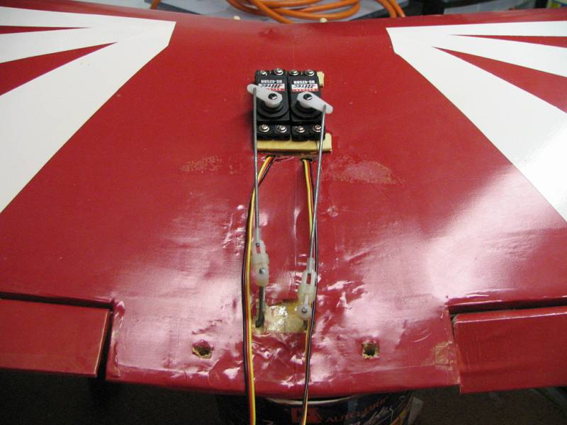

OK boys...it is all under control now. I took a little spare time and widened the single servo hole so I can wedge two servos in....one for each aileron! That was a quick and easy fix and no messing up my pretty wing!!!
Dave

Excellent Sulution !!

Old 06-08-2006 | 09:22 PM
  #60
imsofaman's Avatar
Posts: 1,131
From: Hawthorne, NJ
Default RE: Sig Astro Hog "Engine recomendations
Ugo...please check out my photos! I am also mounting the other servos and control rods. The engine goes in this weekend. I will be flying for sure next weekend!!!!
Dave

NICE WORK, DAVY ! That aught to do the trick ! Good Luck with your test flight..Remember, Be gentle with her. Don't horse her around ! Let us know how it went...

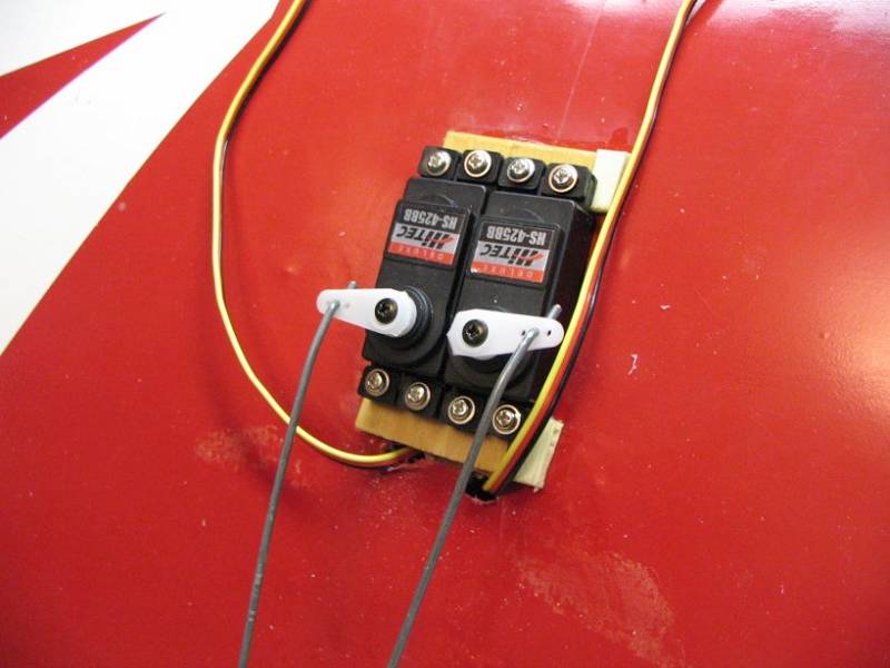

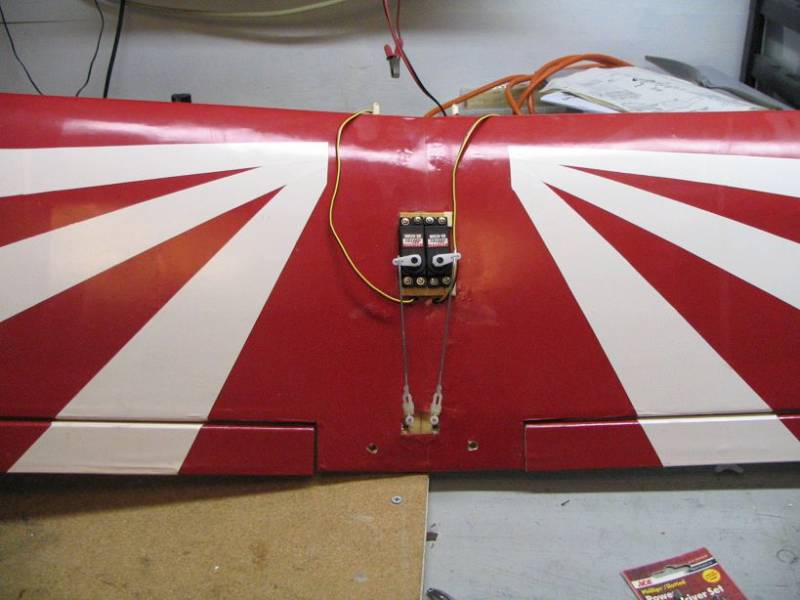

OK....I made a servo tray today and installed it. I went ahead and hooked up the reciever and set the flaperons. They will be activated my the mode switch in the Landing position. It is looking pretty good so far!
