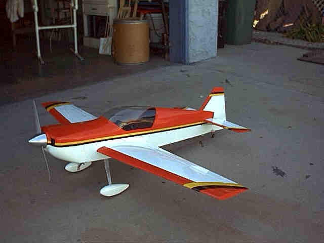

Old 02-10-2002 | 03:48 AM
Posts: 6,378
From: Bloomington, IL
Default Funny!
Mine has,
*normal size wheels
*stock gear location ( no shim )
*wheel pants
No problem flying off grass or taxiing.
Old 02-10-2002 | 02:41 PM
Bryant330L's Avatar
My Feedback: (126)
Posts: 955
From: Salem, IN
Default Giles
Hey, that is a great looking plane. I like your scheme. My giles would not roll 3 feet without nosing over with the stock gear setup. That was in short grass. Here is a picture of mine before a radio failure made it into another branch on a pine tree.......

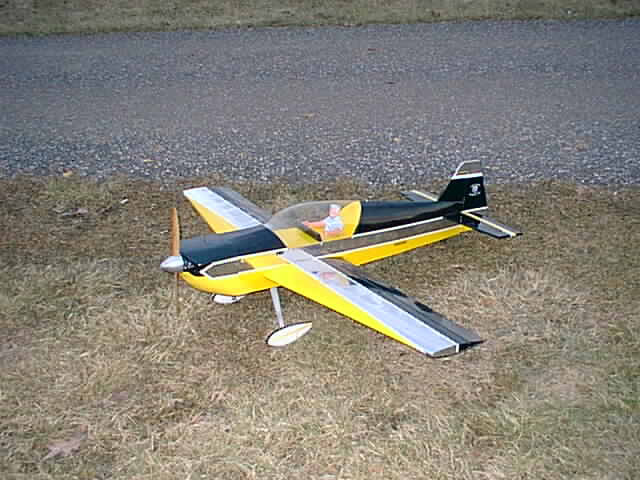

Old 02-16-2002 | 03:51 PM
Posts: 97
From: greensboro, NC
Default GP Giles kit
thought I'd post a picture of my Giles---this was prior to maiden flight, before I figured out that the "stock" wheels and wheel pants wouldn't work on my grass field. I'm using an OS 91FS and a 14x6 prop. Couple of tips: 1. study the wing plan closely---I personally found the directions/plans a little hard to follow, but once I figured it out, the full span webs and overall kit/parts engineering here is excellent. 2. if you don't already own a GP Slot Machine, buy one. I used the old Xacto knife method of slotting my hinge pockets and it was hard, sloppy work. A Slot Machine will give outstanding results, with almost no effort. For $25, it can't be beat.
Edited Feb 21: Attached revised picture format

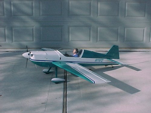

Old 02-17-2002 | 01:24 AM
My Feedback: (23)
Posts: 1,192
From:
Default GP Giles 202 40
The biggest problem for me was the rear turtle deck.....If I did it again I would have used thin ply
hundreds of flights now...almost 2 years old

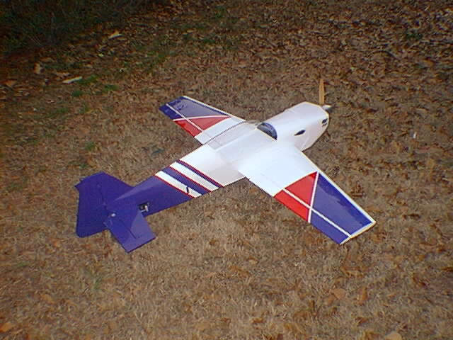

Old 02-18-2002 | 04:06 AM
Posts: 254
From: Weatherford, OK
I found the building very enjoyable. I didn't like having to paint the canopy. I had no trouble with the rear deck. I fly from grass and built some offset in the gear plate as opposed to shimming. I had zero ground handling issues off grass. I used pants from a SE kit and they have held up well. I have a cowl from Stan's. I used a Saito 100 and 15x6 APC. Rear mounted rudder servo and the battery is pretty far aft.

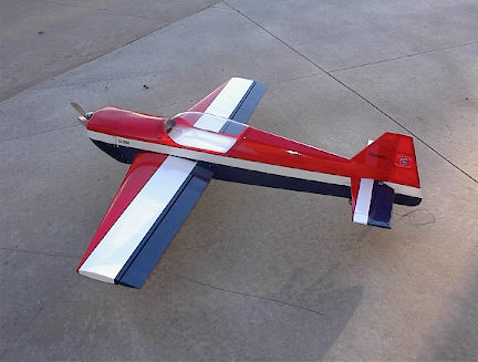

Old 05-11-2002 | 01:30 AM
Posts: 8,456
From: Waseca, MN
Default G202
Since alot of others have posted pics, so will I. The plane was an absolute pleasure to build. I powered with an O.S. .91 Surpass II and my final weight was 6lbs 11 oz.
I don't share the unbelievable flight performance as most others. I thought it was an OK flying plane, nothing more, nothing less. I only got about 20 flights on it before a mid air with a trainer. The plane snapped far to easily in my opinion, elevator throw had to be set at a minimal or it would snap out of loops.
The plane is currently awaiting rebuild, its far from being destroyed, but due to the un-impressive flights I had with it, the rebuild has been shelved for the time being.
I will say, my voice in regards to this plane has been by far in the minority. Most others have absolutely loved this plane, I'm just not one of them. If I had to do it over, I would have put a .91 two stroke in this plane.
