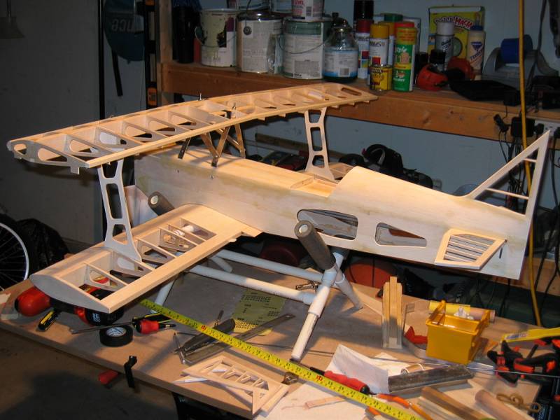

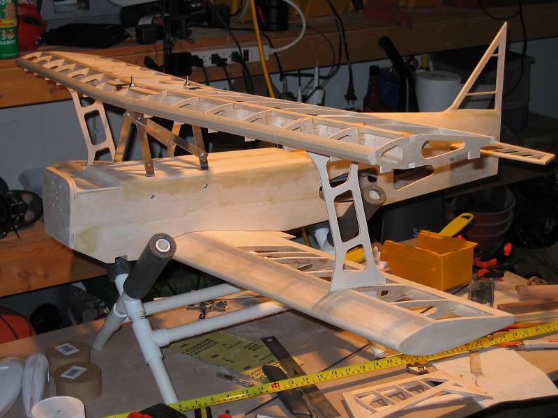

I'm moving slowly on this one. 4 weeks is about the time I've spend sanding the cowl and wheel pants.[
Maybe I should order the fiberglass cowls as well.
longanjoel: Glad to hear that the plane flies nice. I'm anxious about flying mine as well, but it probably won't be for another couple of monts.
Here's where I'm at.
-tychoc
]Maybe I should order the fiberglass cowls as well.
-tychoc

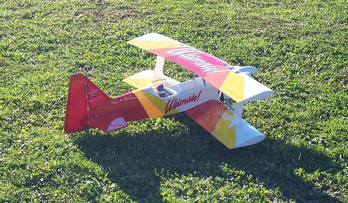

I maidened mine Sunday after a 1.5 year build (life kept getting in the way.)
Magnum .61 2 stroke on mine, with a 12x6 APC prop. Stans cowling, and U-can-do .46 wheelpants (~$15 from Tower)
Came out to 7.35lbs RTF on a calibrated/certified digital scale.
flew very nice after some trimming - but needed about 6 clicks of down, and kept trying to climb at full throttle. Inverted it wanted to dive with centered sticks, so I'm thinking it needs a little downthrust added to the motormount.
They day was breezy - with some 6-8mph gusts, and the little plane didn't seem to mind at all. I had mixed in a little up elevator to rudder mixing, but it was pulling to the canopy in Knife-edge flight so I took the mixing out for now. Once I get the downthrust put in, I might need to add the mixing back.
Snaprolls were awesome, and if you hold the elevator a little longer than you normally need, it just comes to a dead stop in a hover, every time. Not that this is a 3-d plane, but I wish my U-can-do 60 had this trait.
It liked to be landed pretty hot though, but had the best ground handling traits I have had in a while - plane taxiied and rolled out better than a lot of my other planes.
Landing gear seemed a little soft, and I did bounce it in on a dead-stick landing (lean low-speed needle).
In all - great flying plane, and though I'm now moving into larger scale airframes, I'm not going to be in a hurry to get rid of this one.

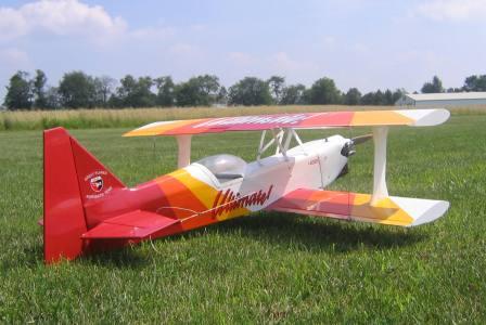

Finally!!! The Ultimate is finished and went for its maiden flight on Monday July 3. This was an 11 month build.
Ground handling was excellent with no tendency to nose over in grass at all. Flying charcteristics were nice. Nice axial rolls. Quite responsive, although not like my 3D profiles. Nearly unlimited vertical. I'm still getting used to the visuals of a biplane in flight, so I didn't try too much. Landings tended to be fast. I'm thinking I may need some more elevator deflection or add some tail weight. Although, inverted flignt required almost no down elevator. It was a gusty day, I'll know more when I fly it in calm weather.
I noticed that for level flight I had a fair amount of down trim. I'm wondering if my wing incidence is not quite right.
Final weight came in a 6 lbs 14 oz, about a half pound heavier than I estimated. I'm using a Saito 72 with a 13x6 APC prop. Cowl is from fiberglass specialties. I didn't use the wheel pants. I mounted the batteries behind the wings in a compartment I added to the fuse. Did not have to add any weight for balance.
Best part is I can fit the Ultimate in the back of my Cherokee without taking off the wings. Also, I have an exhaust extension and cleanup is a one paper towel affair.
