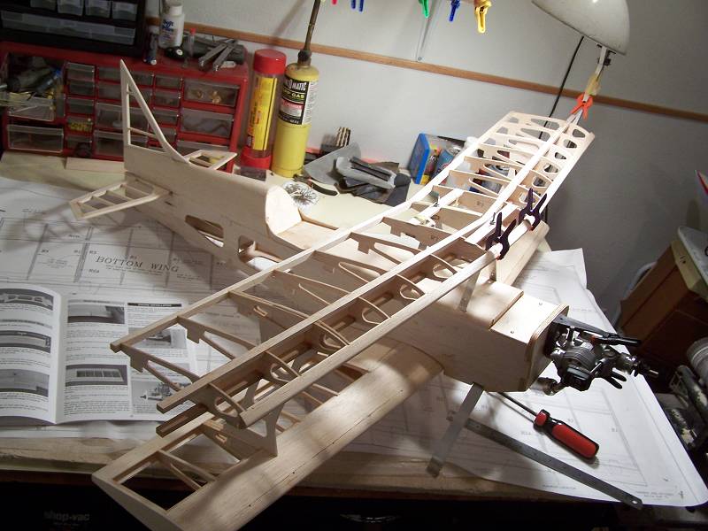

Here are some pictures of what I have done so far. This is about 5 nights of working till midnight or one in the morning. I see what you meant about the fuse sides being tricky. The firewall is not epoxied in yet. My father-in-law borrowed my quick clamps and has not returned them yet.

Your work looks nice Tim.
I'll post some pictures of mine tonight from home.
I ran into trouble getting the fuse to fit together. The tabs didn't line up very well and I had to modify the slots a bit. I used every clamp I had (about a dozen) together with several string tourniquets and eastic bands to force the fuse sides into the tapered shape. I also had trouble with the fuse plywood delaminating. I had to break apart some areas and reglue them. I worked through the problems and the end result is decent enough. A more experienced builder would probably have had no trouble.
I have three rolls of white ultracoat left over from a previous build, so I'll first cover everyting in white. Then I'll add some design to the fuse and wing top surfaces in missile red. I plan to cover alternating bays of the underside of the wings with a dark color. I want the bottom to be obvious to help me keep orientation in flight.
I trial mounted the Saito 72 last night. It fit the stock engine mount perfectly. I drilled and tapped the holes - don't like self-threading screws. I'm wondering though how well the stock mount will hold up to a 4-stroke. I'd like to hear from anyone else who has used the stock mount.

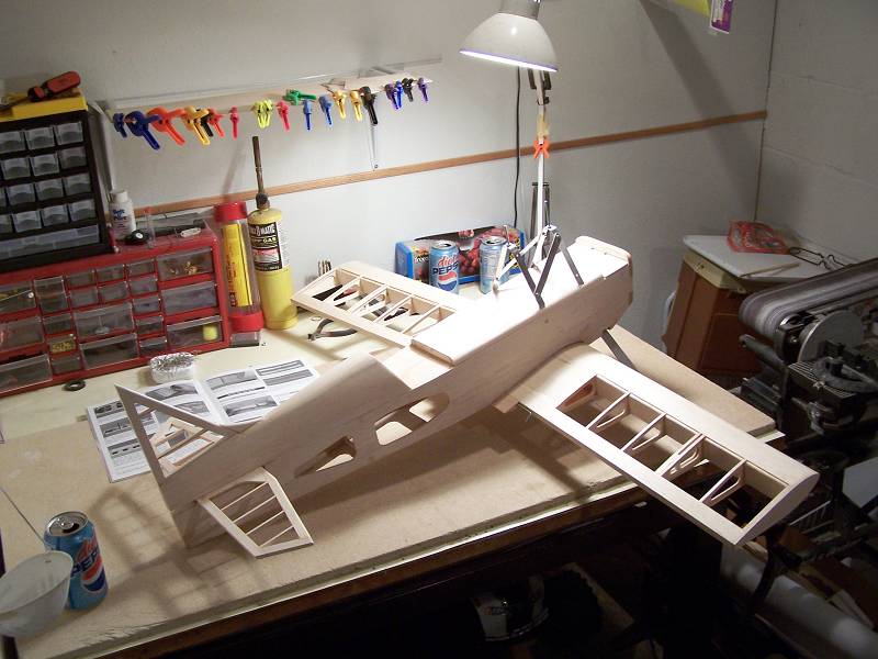

This is what I got acomplished this weekend. Everything was pretty simple except when I got ahead of myself and sheeted the top of the fuse before cutting the slots for the metal cabanes.[:@]
I also started on the top wing. Spars were warped pretty bad. I hope it turns out ok. I set them so the counter react with each other. Also found time to assemble the abs cowl to start my fiberglass project. My wing ,stab, and fin alignment came out perfectly.
and the wing seam is pretty tight with no gaps. All in all, I am very happy with this build so far. GP has made a very nice and easy to build airplane.

I finished framing the top wing last night and mounted it on the cabanes to check for alignment. This thing lined up perfectly. I put the cockpit sides on also. Modified them a tad to make them look more appealing. Hopefully I will be able to start covering it this weekend. I think I am going to cover it in ultracote. Either pearl blue or purple over magic yellow/red with a pearl white base. I have the graphics done so tonight maybe I will post the for some feedback. I will also post my progress to see if anyone likes my very small modifications.

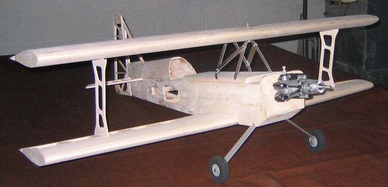

Here are the pictures of what I got done last night. I pretty much have the top wing done tonight. I just have to sheet the bottom TE and cap the ends.

Just finished the top wing on mine. I also finished bonding my cowl together and filling and sanding the seams. Everything fits great. Some final filling and sanding and I should be able to start covering it this weekend. I think I am going to build the wheel pants.I am going to make them so they clip on and off easily because we have a grass field that loves to eat wheel pants.
My fiberglass cowl seemed to be working ok, but I decided to scrap the thing when I discovered the cost of making it myself would exceed the cost of just ordering one. I am going to try to use what i have done to make a cowl for my hog bipe though.
I will post pictures tomorrow of the thing totally framed up and this wekend when I start covering it.
