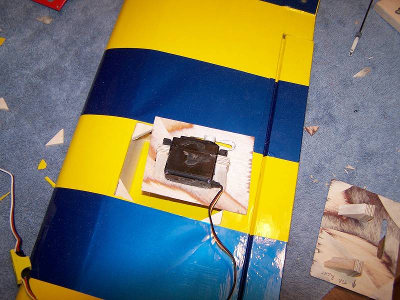

The only thing I did not like about the kit was the single aileron servo. I just could not get enough throw on the ailerons,and I was afraid one servo may not handle four ailerons in extreme manuevers. So I decided to build sevo bays in the wings. This was done after the plane was built and flown several times with the single servo. With the dual servos I get much better response and a little more throw.

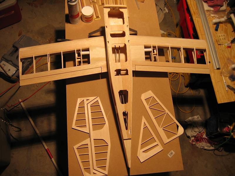

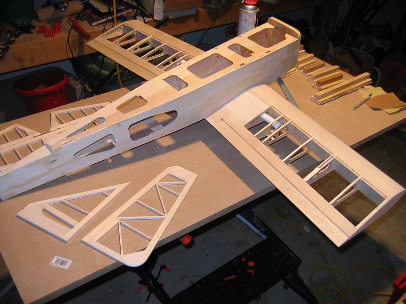

Ok, so here's my progress so far.
-tychoc

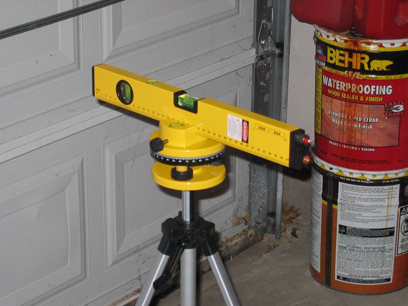

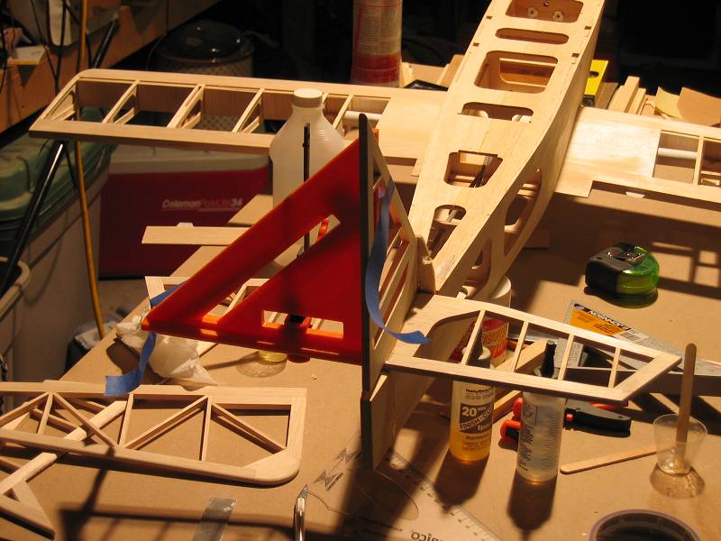

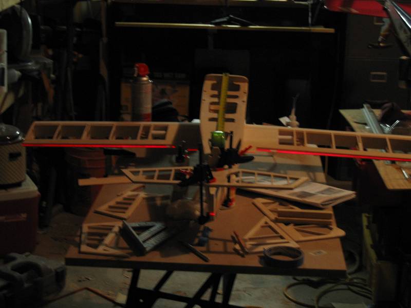

Glued the stab to the fuse tonight. Made sure the stab and wing are parallell using a laser.
Tomorrow morning before work, I will glue the fin and then start the turtledeck assembly this weekend.
Those of you that have finished the Ultimate and are using a 4stroke engine, can you take a picture of the throttle linkage for me? I'm unsure as to how it should be routed.

By the way, very nice job on the framing of your plane. I see you decided to go with an aileron servo per side of the wing. I kind of wished I had done the same thing. Some of the flying I do involves the use of flaperons and with just one servo I can't do it. I will probably redo it next fall, or maybe make the single servo bay wider and mount 2 of them side by side. I don't know yet.
Looks good, Keep them picts coming.

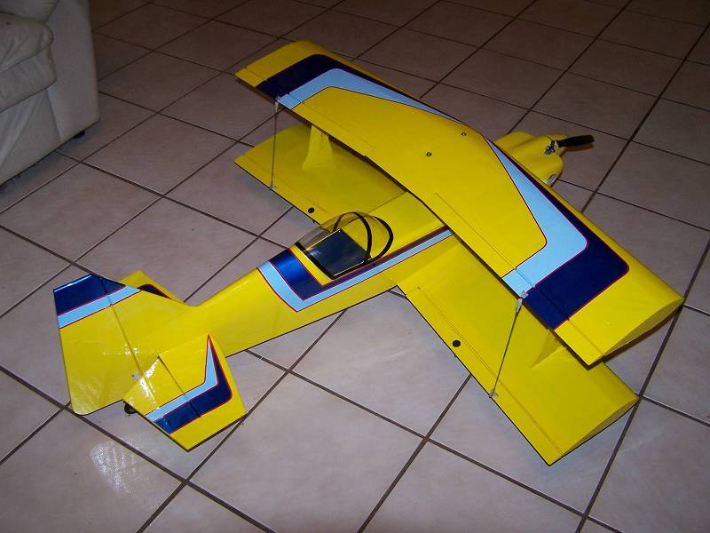

Cool acam37. How about a picture of the whole airplane
Here is mine. The yellow really shows up good in the sky. And the stripes help with orientation.

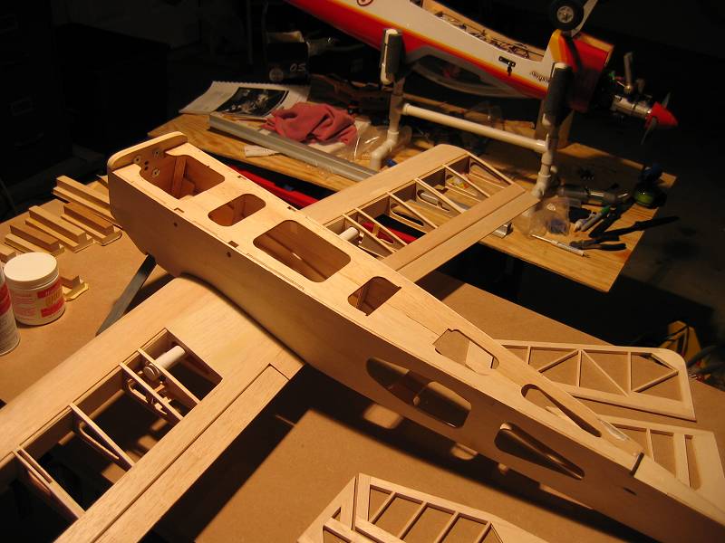

Here's this mornings progress.
tychoc

I just tried the incidence meter today, and I have a -0.5 deg incidence between the stab and the bottom wing. Should I try to correct this?
thanks,
