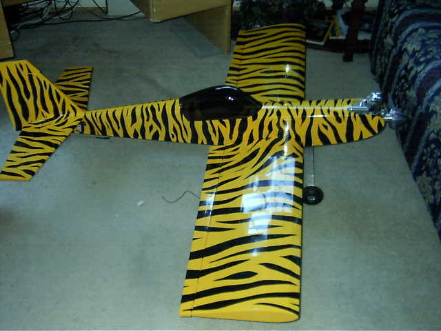

i just finished my 4* 60 and bashed it the same way, I have on hand a saito 80 but its going on my proctor antic bipe when its completed , but will be on the star for break in , (and until i can afford the correct engine) which is the 100 as posted already. PS here's a pic of mine , I luv to show it off
