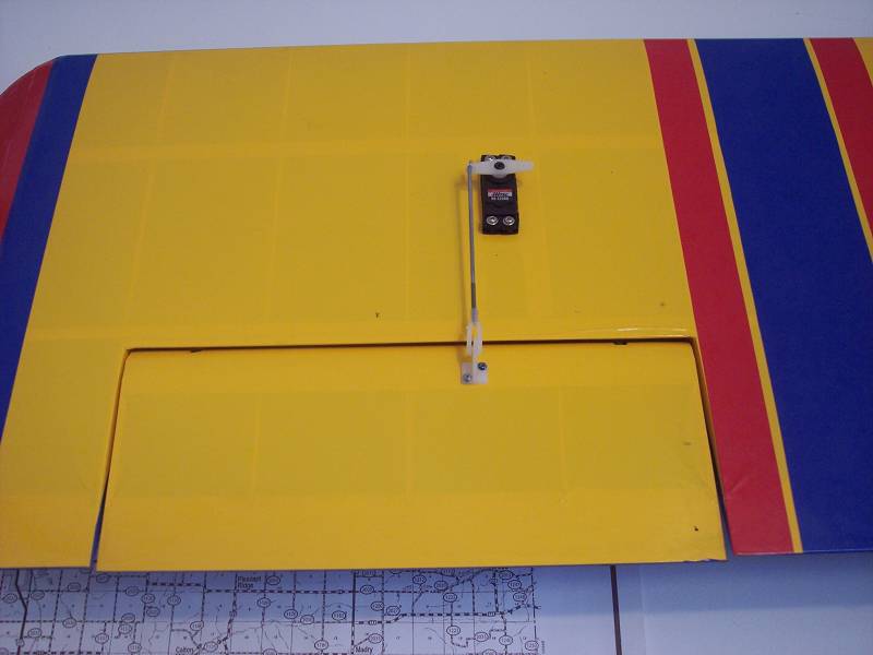

So, for barn door ailerons, how big?
I built mine 4 rib bays wide, starting at the second rib from the tip, leading edge at the rear spar. That makes it 10.5"x4.25" approx.

That's one big barn door?
I bet it does a mean snap roll?

Yep. Bhole must have the world's only 3D Seniorita
