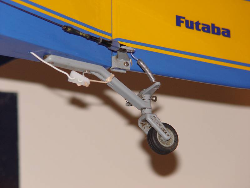

Dump that Sullivan tail wheel and get a Klett unit; looks better and is MUCH more durable. You'll probably have to order direct from Klett in Texas, but its worth it.
I'll post a photo of mine tonight if you have trouble finding one; I think they still have a web site.

I would be interested in the tailwheel pictures, it looks a little more scale than the sullivan in the pictures I found. I'm not trying to build a scale Ultimate, but hey, if it looks better.

P.S.: I'll post a pic of the tailwheel this evening. I looked for a Klett web site yesterday, with no luck. I did have their phone number in Texas; I'll look for it too.

You're welcome; guess I need to clean that puppy, eh?
