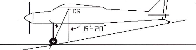

Hi Chris, I see hits but no info, so here you go. A tail dragger gear should be setup by locating the CG and the datum line(this line runs along the fuselage side) on your aircraft. The datum line is used to have a reference of 90 degrees for the 15 to 20 angle you will need. CG(forwardmost)-Do this with the wing on the plane and mark the location on the fuselage side with a vertical line use low tack tape or pencil, once you have this marked remove the wing. Now using the datum line for a 90 degree angle mark your CG line from top to bottom of the fuse side. Now mark a line 15 to 20 degrees in front of this(vertical line) starting at the top of the fuse side where it will intersect with the CG line. You can use a yardstick or whatever you have that is perfectly straight to bring this line below the fuse side. You can now take the mains and rest them against the bottom of the fuse, move the gear until the axle contacts the yardstick or what you have used then make sure the main gear is square to the fuse and mark the front and back side of the main gear. Use a solid main gear (aluminum or wire) as this absorbs landing shock. Make sure that you reinforce the new area for the gear with 1/4 ply. The tailwheel area should be reinforced also with a piece of 1/8 ply if mounting on fuse bottom; ie when using Sullivan TW this assembly uses two screws and blind nuts. This sounds more complicated than it really is. You can PM me if you have any questions. Ben

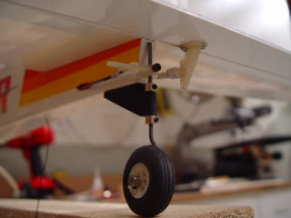

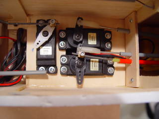

What I do routinely is to epoxy a brass tube vertically into the rear of the fuse. This is where the tail gear wire goes. But before inserting the wire into the tube, put a wheel collar on the straight piece of the wire with a long (~1â€) hex head bolt. After all is tight and the bolt head is pointing straight back (a flat spot filed onto the wire where the hex head bolt tightens will help keep alignment), slip a piece of fuel tubing all the way on to the bolt, with another inch or two of tubing left past the bolt. At the end of the fuel tubing use a wood screw to attach the tubing into the bottom of the rudder. This not only allows complete tail wheel control, but does so with shock protection.
I’ve attached a photo that shows this on one of my planes. I use this method for all my planes up to and including a couple that are 80†wingspan. In the picture, ignore the line coming off the tail wheel area at a 45 degree angle to the lower right. It’s a result of me taking the picture in the garage and the plane hanging from the ceiling.

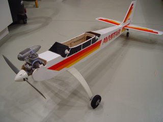

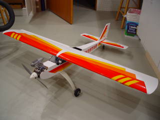

Here's how I did my Avistar: I used a set of DuBro main gear mounted just behind the LE anchored to an additional ply plate epoxied behind the front bulkhead in the radio compartment and then used a sharpened brass tube in the drill to run another ny-rod from the new tail wheel to the rudder servo.

Thank you......... that's what i'll do.

I just completed the conversion yesterday, so no flight info. I don't expect any significant differences other than take-off / landing.
