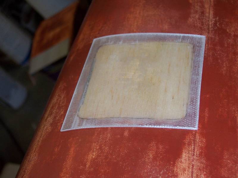

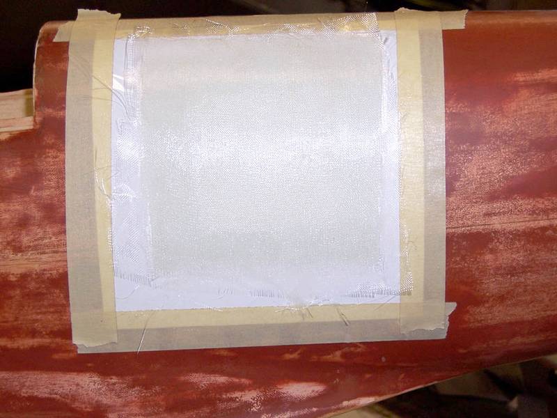

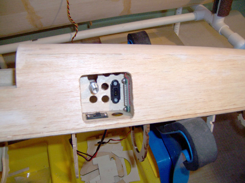

Well, here's the start of the hatch cover. First photo is of the accessories mounted. I've since glassed the fuse and filled the weave with primer and sanded the area smooth. To make the hatch, I first tack glued the material removed with a gap filling CA (second photo).
I then cut a piece of ultracote in a 5" square and taped it over the area with masking tape. I then hit it with a heat gun to pull any wrinkles out. I cut 4, 4" x 4" squares of 5 oz cloth, and 1 square of 1/2 oz cloth. I mixed up a batch of West Systems epoxy, using the slow hardener and added about 20% denatured alcohol. I used an acid brush and coated the area with epoxy. Then I laid the first cloth down and using more epoxy, fully whetted the cloth. I added a second layer of cloth brushing on more epoxy. I then used a piece of plastic to squeegee down the two layers, and remove excess epoxy. I added the next two layers in the same manor and again squeegeed the cloth. I finally added the last layer of 1/2 oz cloth, squeegeed the area, then brushed on a final coat of epoxy. (Third Photo)
Tomorrow should show the results.
Scott
Scott

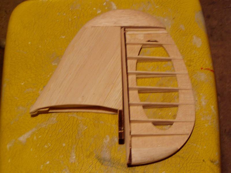

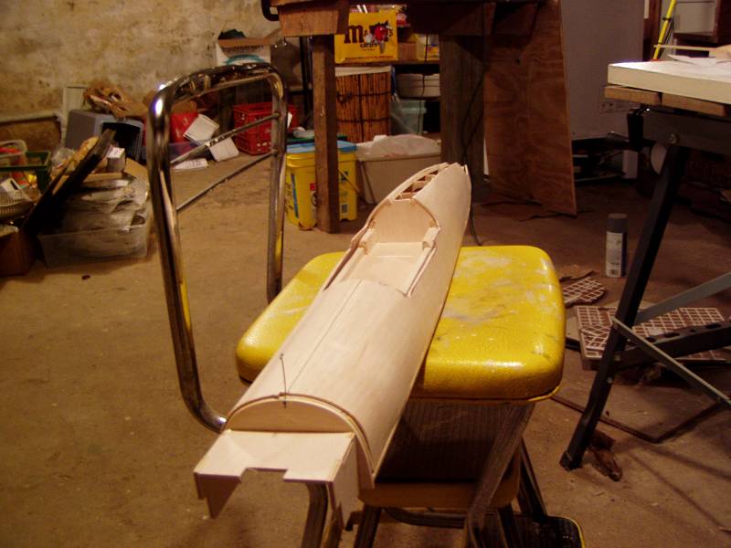

Well looking at your pictures gave me an idea, so I dusted off the ol'camera and here are where I am so far
I used Tubig idea on the elevator shape
I have shaped and glued the top of the rudder then realixed the directions said not yet, well!!
The top fuse look OK I did not show the left side with the slight crack over the cawling, I guess it gives her characte
And finally the wing as 10 minutes ago.
Let me know if you see something massively wrong I appreciate it.

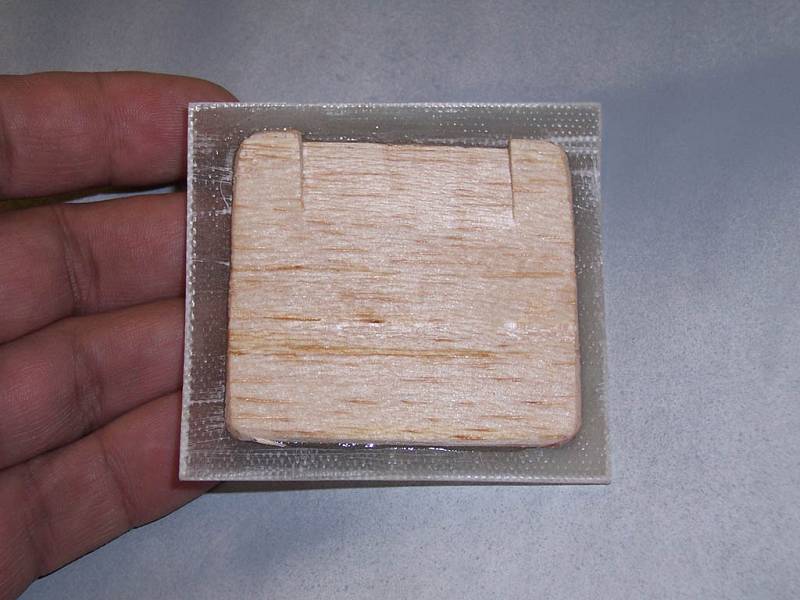

Well, made progress on the hatch.
Photo 1, I removed the fiberglass skin and mounted the balsa cutout onto it and trimmed it to within about 1/8". You can see where I made a flat to which the hinge will be mounted. It is tapered too, so the hinge line will be as close to the surface as possible.
Photo 2, a test fit.
Photo 3, This is a tool that I really like. it is a set of mini rabbiting bits. It will make 3 or 4 different size rabbits with an adjustable depth. I'll use this to create a recess around the hatch opening that the fiberglass skin will fit into.

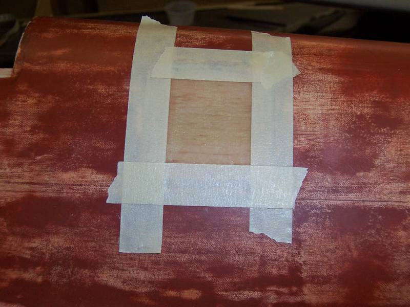

Photos 4 & 5, I made a small template that matches the curve of the fuse. I only used this to draw lines that will be 1/32" past the balsa for a trim guide.
Photo 6, After trimming the fiberglass, I found the hatch opening was a little off.
Scott
Scott

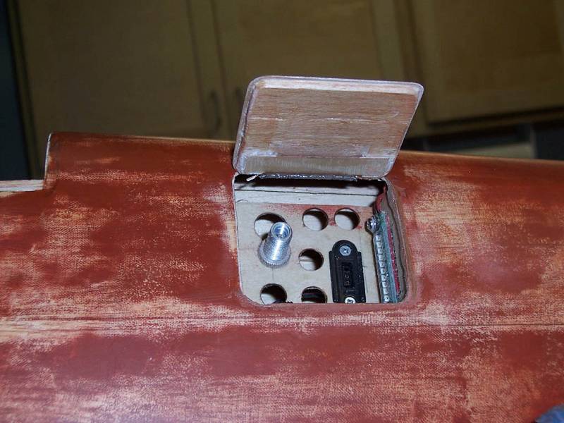

Photo 1, I applied a mold release wax to the hatch around the edges, mixed up some epoxy with micro balloons, built up the rear and bottom edges of the hatch opening and pressed the hatch into place. I added a bit more epoxy mix to the outside of the bottom and rear seams and let it set.
Photo 2, I sanded the micro balloons flush once set. The door popped off easily leaving a seamless fit. Actually, the fit was a little too tight, so I sanded a little around the rear and bottom of the door for a little relief. I also trimmed back the balsa about 1/64" all away around. Here's the result of the micro balloons. Sorry that the photo is a little blurred.
Photo 3 & 4, Next I made the hinge from two Dubro pinned hinges. I removed the original pins and made a new one that goes through both hinges from piano wire. I covered the hinge joint with Vaseline and epoxied the hinge to a flat I sanded into the fuse, like the one sanded onto the back of the door. I also backed the hinge with a strip of 1/32 ply. This forms a pocket and should add strength to the hinge.
Photo 5, I added another strip of ply to the back side of the door to make a pocket, added epoxy to the hinge and pocket, slipped the door onto the hinges and taped the door shut to insure alignment as the epoxy set.
Photo 6, 7 & 8, Here is the door finally mounted, shown both open and shut. In photo 7, you can clearly see the ply strip that formed the pocket the hinge fits in. Notice in photo 8 that there ended up being a little gap between the top of the door and the opening. This was needed in order for the door to clear when open. If I could have gotten the hinge line above the surface, I would have been able to avoid the gap. In all, I am satisfied with the results.
All that's left is to add a magnetic latch, add some sort of handle to open the hatch, final finish and detail.
Scott
Scott
