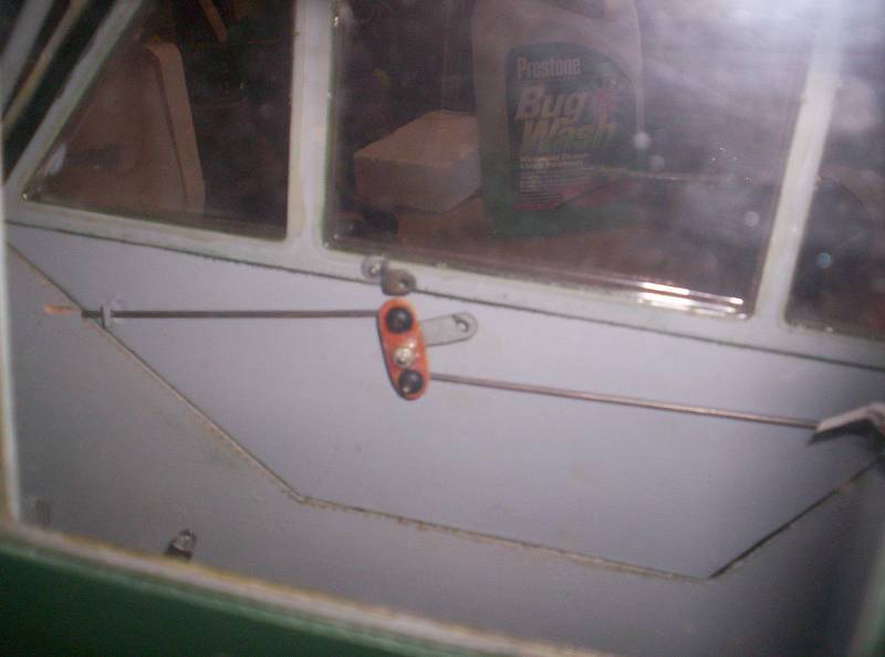

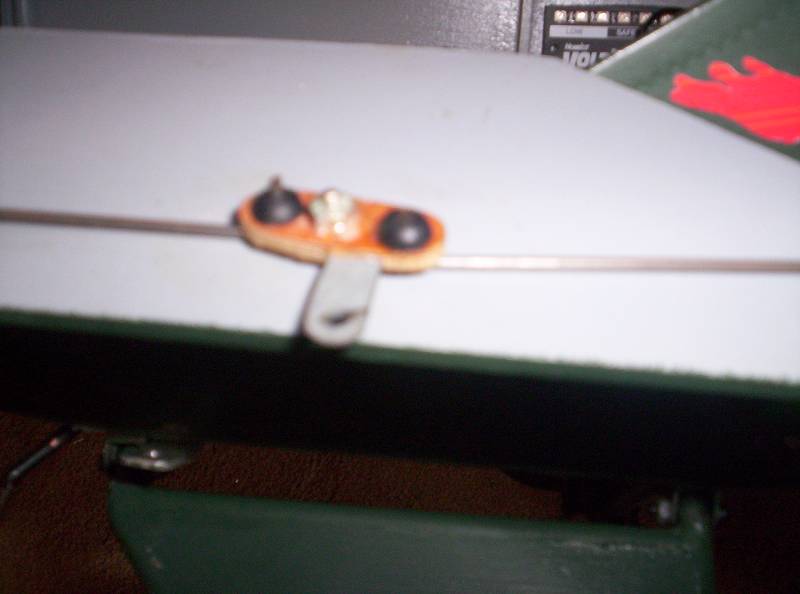

The manual says that the opening window will stay shut without help while in flight. Mine didn't, flapped like a sheet in the wind, even at idle. I fashioned a latch that works with the included door latch, and allows the door and window to be opened independently, and does not modify the kit design. I've included a picture.

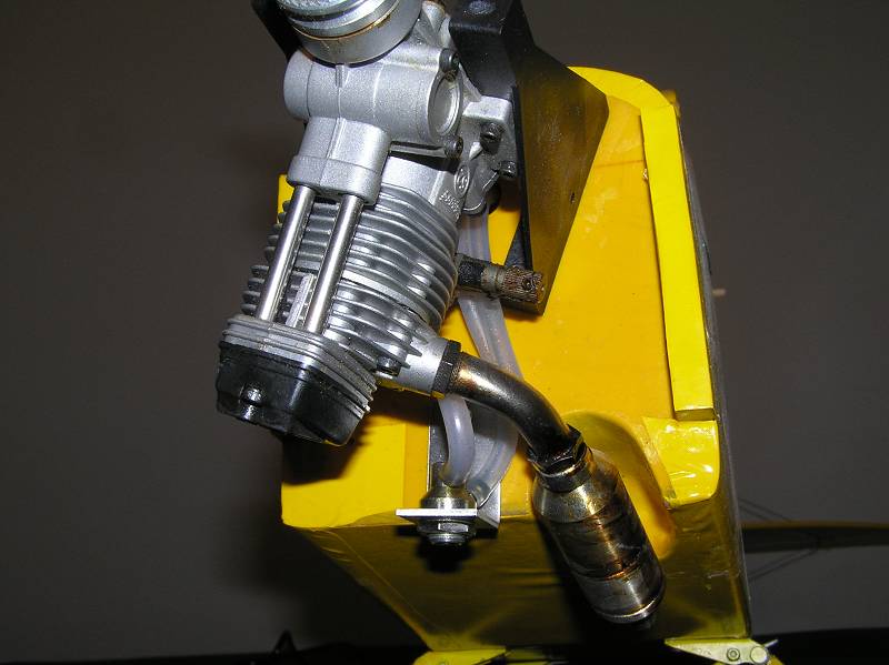

Here's a shot of an OS .52 in mine.
