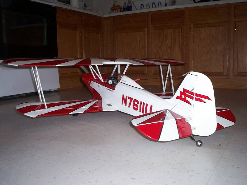

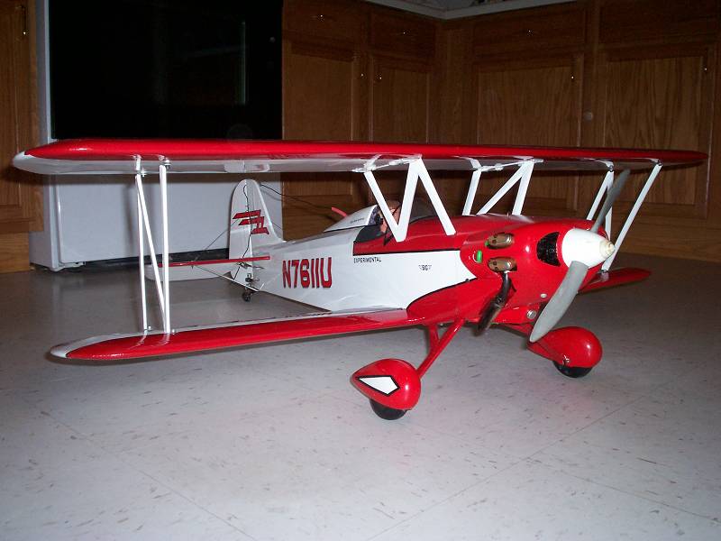

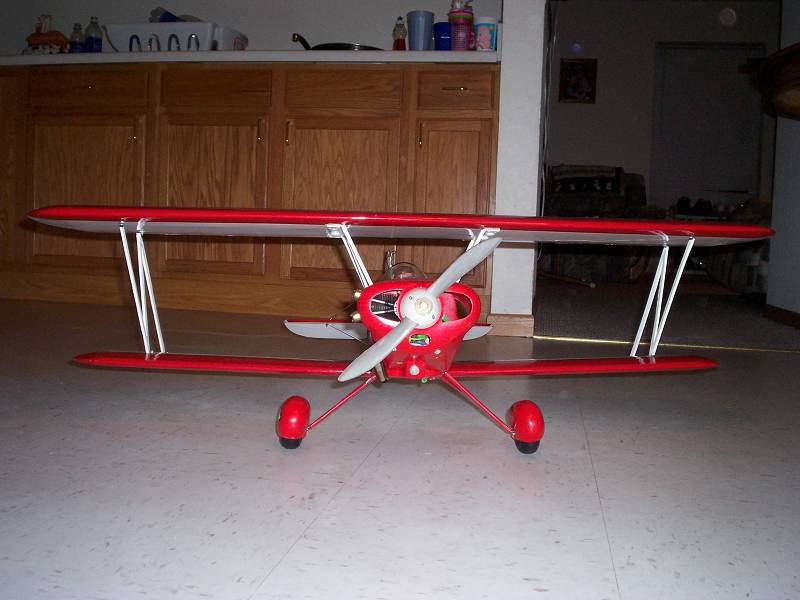

What equipment are you going to install onboard?
I changed the way the N-struts attached to the wings. the stock way always seemed to unscrew, and then the rod would poke holes in the covering. I'll post a picture in a little while.
My miniplane built heavy.-My own fault. Its on the upper end of 6.5lbs, but she'll still glide in slower than most low-wing trainers! GREAT PLANE bar NONE!!!
You can see my mini in my gallery icon.

You did an excellent job on your Mini. Never seen one that nicely finished before. If I had one that looked like that i'd probably never fly it.
