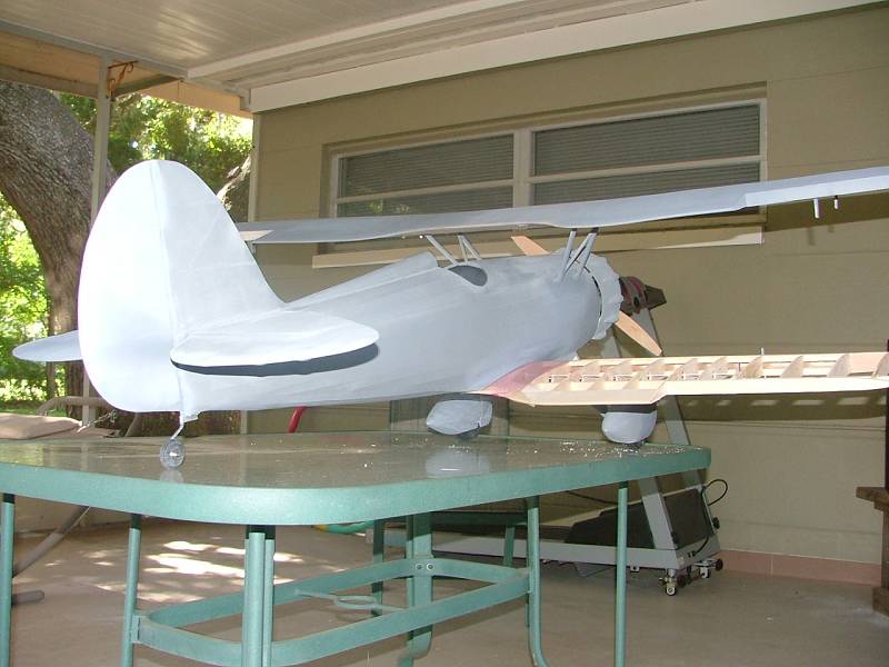

I am in the process of priming my WACO at this time. I brushed on 3 coats of nitrate dope reduced 50% with thinner. After sanding to knock down the fuzz, i have applied 2 coats of primer to the fuselage and empannage. I am waiting about 1 week for the last coat of primer to shrink before the final wet sanding, and I am using single stage automotive paint. I may add clear after the fact in order to customize the gloss. You can enlarge these pictures by clicking on the lower right corner of the pic.
Bill, AMA 4720
Bill, AMA 4720

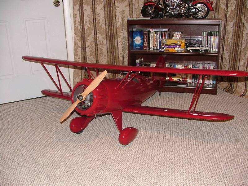

I know that you guys are getting tired of seeing my plane/s, but I have the base color on the WACO. The sheeted areas appear as metal. There is the faintest hint of weave in the open areas. Just what I was hoping for. I still need to add the trim color, and the graphics. The difference in weight before application of paint and after is less than 20 ounces. That may sound like a lot of weight, but on an airplane this size, it's not much.
Bill, AMA 4720
WACO Brotherhood #1
Bill, AMA 4720
WACO Brotherhood #1
