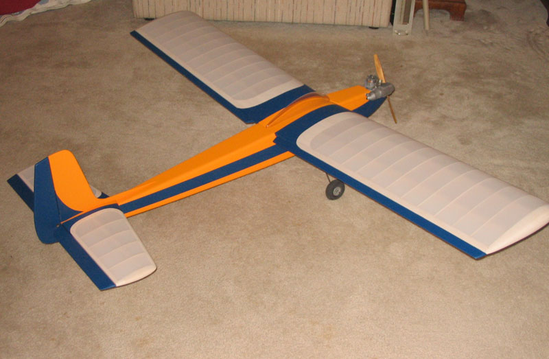

Here is my koveral and dope covered LT-40.
http://www.rcuniverse.com/forum/LT%2...1963113/tm.htm
That was three years ago. No wrinkles yet
Definitely not a job for the impatient....
I doped the koverall on to the frame. No StixIt. Various tips and suggestions on this forum were all helpful.
!Definitely not a job for the impatient....

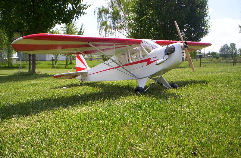

I didn't find it hard. That was my first attempt. The LT-40 was a practice run for a 1/4 scale cub (which still hasn't been done).
The time consuming part was masking and painting the trim. The initial covering, nitrate dope, and base butyrate coats, where pretty quick. I avoided numerous pit falls by reading all I could here first. I expect the cub to be simpler since it is all yellow with just a bit of black trim (if I ever get to it).
(I had some experience with tissue and dope on Guillow models as a kid... I suppose that helped a bit. The smell of Nitrate dope was immediatly familar when I got started with the LT-40.).

The modified LT-40 looked great , I noticed the wire on the tail section , great idea .
