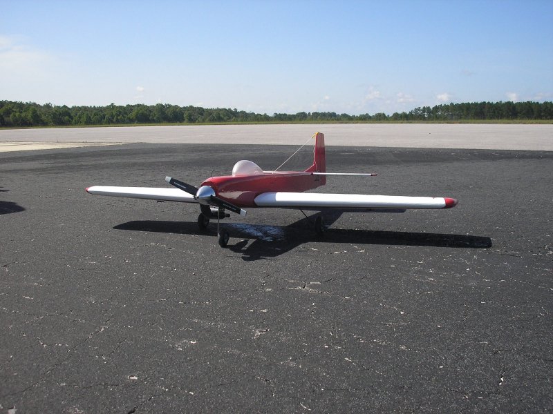

Here is my 'Killer' on wheels and floats with a Rossi 61RE.

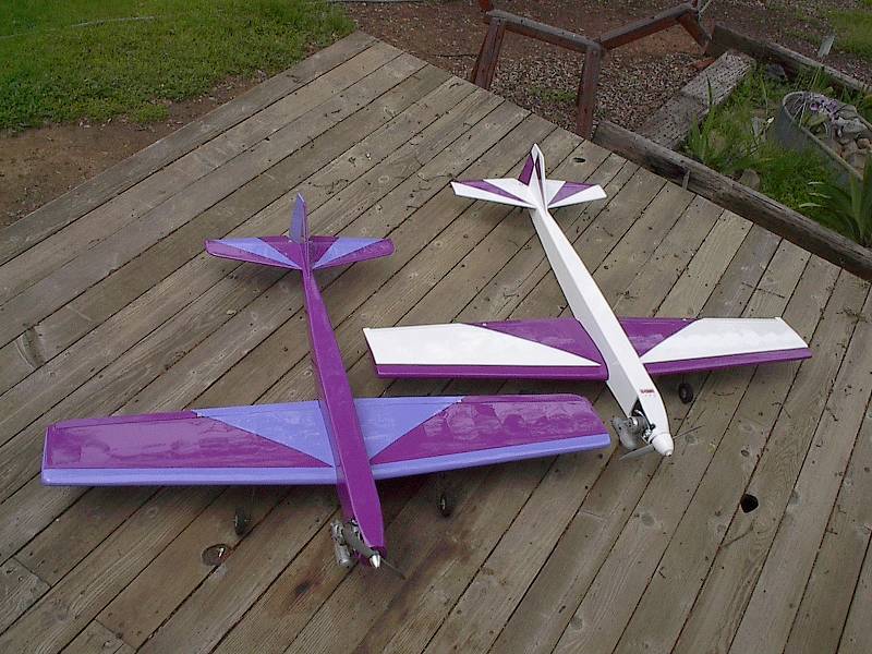

Can't see enough Kaos!! I do keep as much throw in my rudder as I can, for some reason mine doesn't respond as well as I would like to rudder input?? Maybe I'm just spoiled from my other planes? At the time I had the MDS 68 {junk} engine in mine and an OS 60 in the other one. Today I am running the YS 110. Can you say over kill??? I have A lot of planes but the old Kaos is the one that gets the most air time. This photo was done after I recovered both planes, dark one is for A friend. At this time mine is ready for another cover job and some wood work. Both planes were old when we got them and just keep being rebuilt as needed.

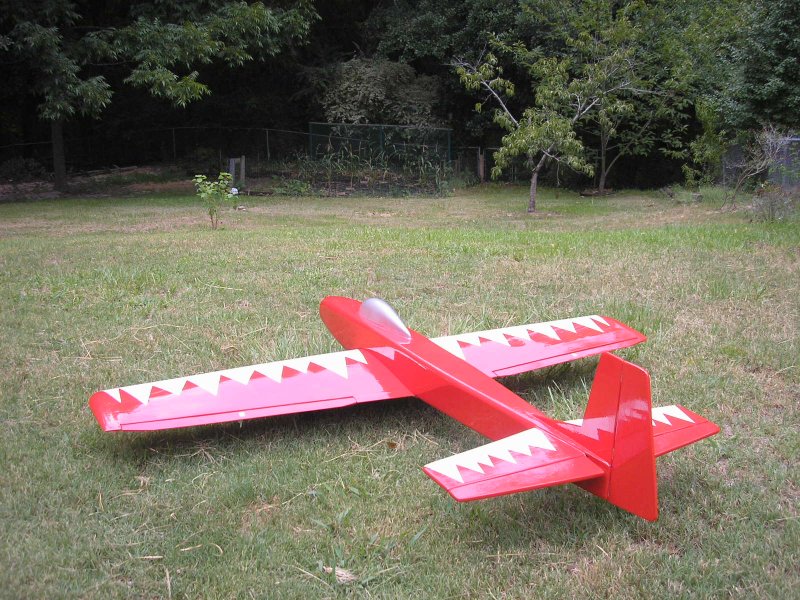

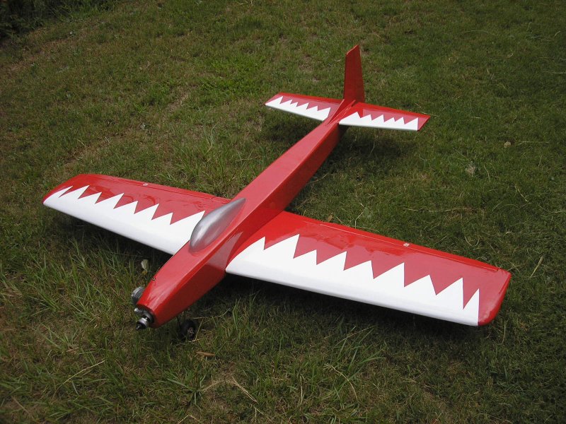

Here's some pics. It's a little red, ain't it?! Do you think I should do any more trim? Maybe something on the vert stab/rudder? You can't see it in these pics, but I painted the inside of the canopy with silver glitter paint. It gives it a translucent look and it sparkles in the sun. Ooooooo.... [8D]
Maybe, but it needs lettering and numbers. AMA numbers were and still are required for competition. So I would put your AMA number on one wing, KAOS on the other wing, and KAOS on the fin.

I really appreciate all the feedback. I'm thinking about putting some bright yellow stripes on the bottom of the wing and stab (leading to trailing edge) for contrast. I'll talk to guys in our club about how to do lettering as I've never attempted to do that covering technique yet. I suppose that I could use my computer to print the letters and then transfer it and cut it from the covering material.

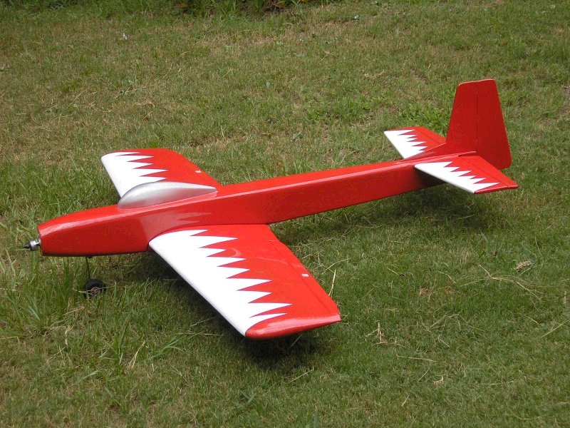

Well, a maiden and six tanks of flying later, I have to report that this is THE best flying aircraft I've had the privilege to fly. The control throws were set at 18 degrees for aileron (about 75 percent at dual rate), and 12 degrees elevator. The elevator was a little hot for me, so I've toned it down a bit. Roll rate at 18 degrees is perfect. I left the bottom of the wing solid red, and the white on top is so brilliant against the red that it's easy to maintain orientation when churning. Landing this thing is awesome, it flares beautifully, and it sticks at touch down for a scale roll-out. It's makes ya look good. What more could you ask for? Not bad for a 30 year old aircraft...I'm not sure, but I think I'm in love. Here are some pics I took at the end of the flying this morning. Thanks for the help guys.
