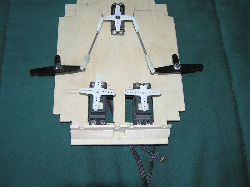

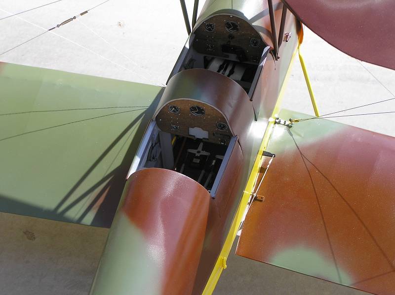

Pick up a set of Pull-Pull cables from Dubro...4-40 size if you are overpowering your plane. VERY easy to set up, just look at the instructions.......(on the cables)....Use a ball bering servo and just run two lines (one from each side of the servo arm), one the one side of the rudder, the other to the opposite side.
Once you do one, you will always want to do more!
Even did one 'scale'....
