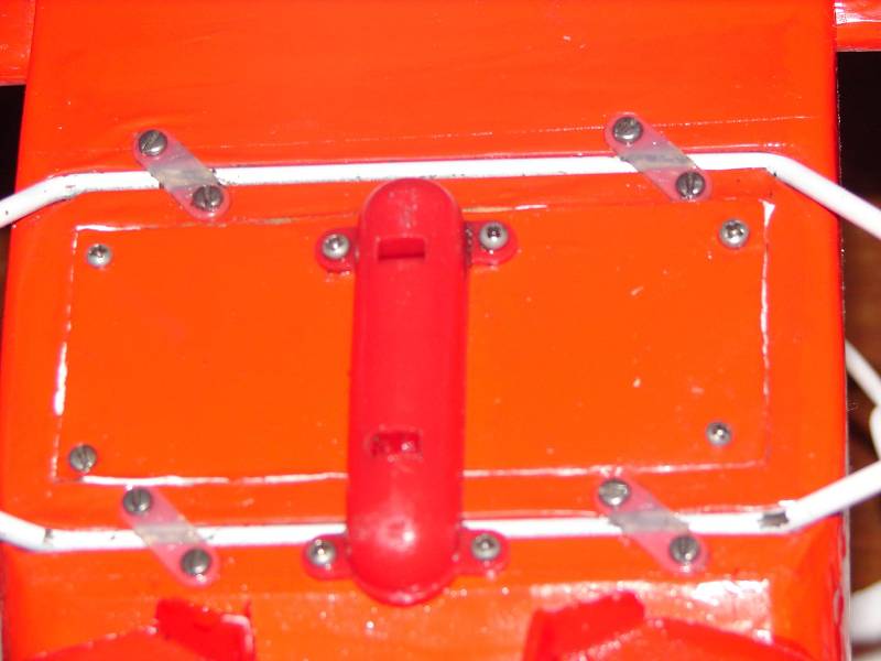

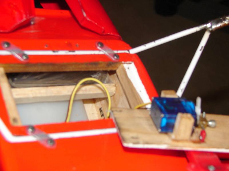

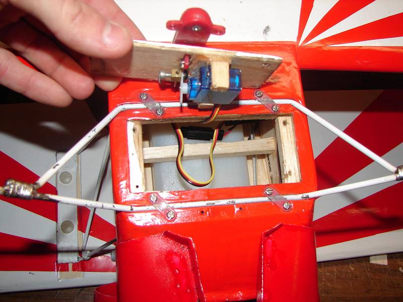

well here are my pics of my hatch. i also have a bomb drop as you can see, for the hatch i just glue spars along the side and put some screws to hold the hatch in, you can see the battery tucked under in front of the landing gear, right behind the firewall. simple and effective
ID:	595277   Click image for larger version
ID:	595278   Click image for larger version

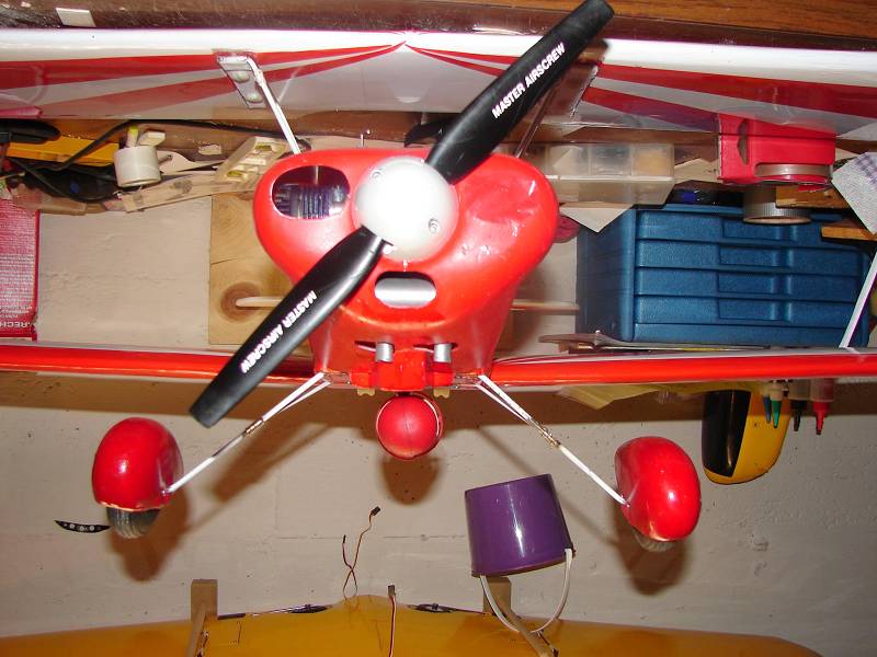

one more pic of the bomb inbetween the landing gear.

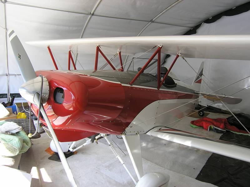

2 pictures of the real thing, finished by a friend and then sold on-line:-)
A beautiful plane and you really understand why it is called "mini", the plane and the cockpit is very small... Good for short and not fat pilots (at least the one pictured)...:-)

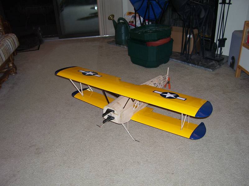

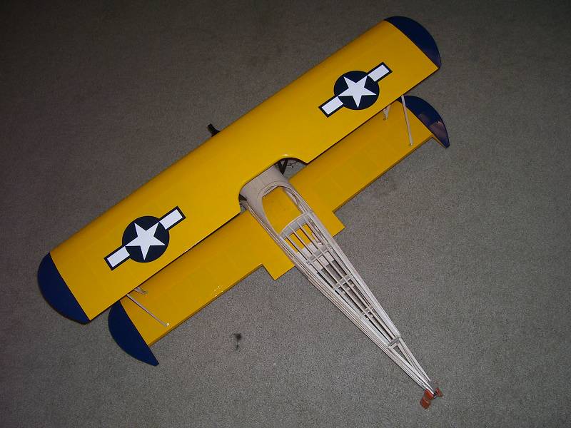

Hey all, sorry for the loooong break, but I finally have some progress pictures for your enjoyment. This has been one heck of a project, and the necessary attention to detail just burned me out for a while.
Here are a couple pics of the finished wings mounted on the fuse.

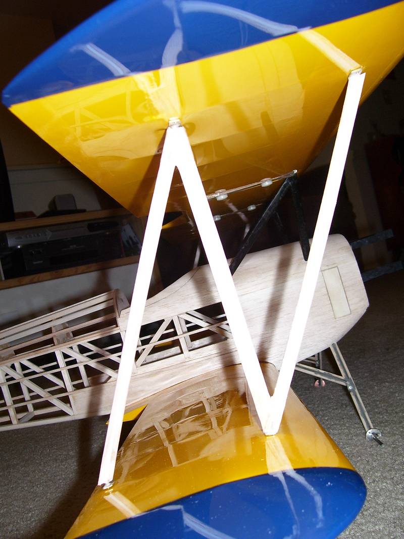

And a pic of the N-struts. These required bending two wires to proper shape, cutting and attaching balsa fairings, fabricating brass feet, fiberglass and CA glue. I used quick-drying spackle for a filler. Lots of work for these two finished pieces!
I also have the rudder covered, and will probably get the majority of the fuse covered this week. Its nice to be getting a second wind on this project.

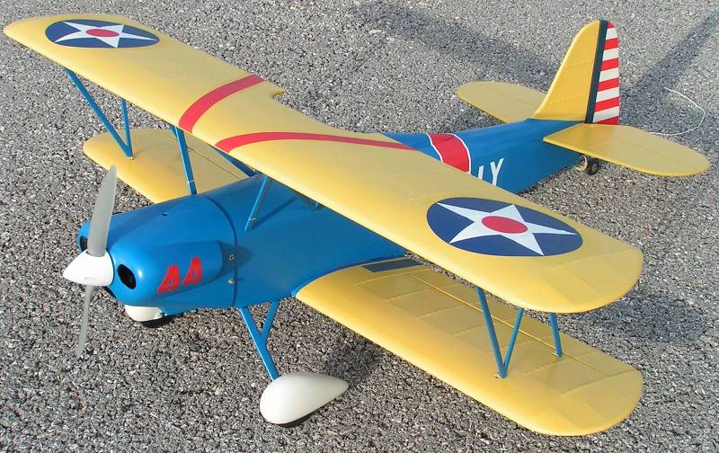

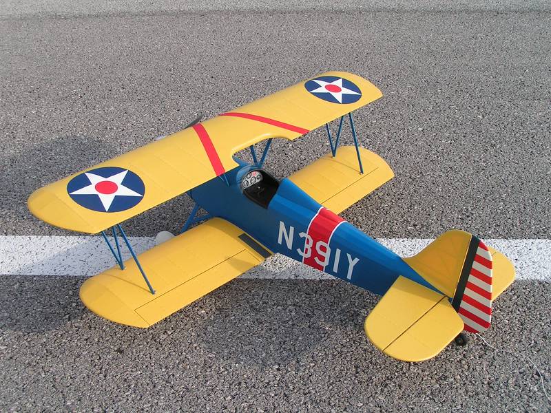

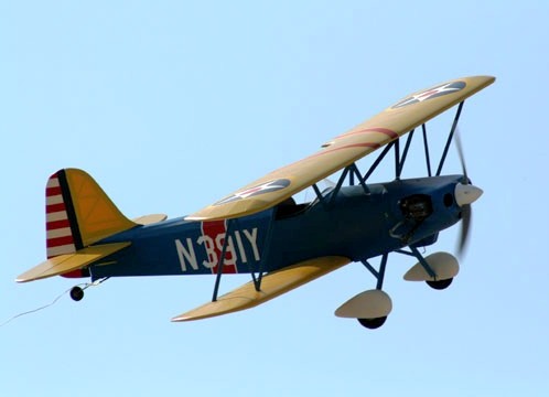

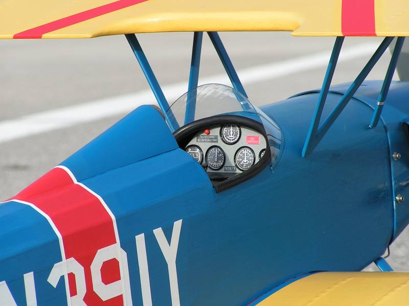

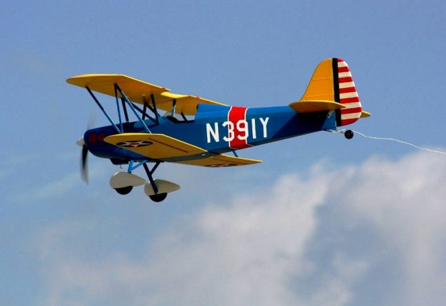

Thought I'd post my pics of my model N391Y.
Finished 6 months ago, it is a super flying model, I recomend very highly.
Power is an old OS 61 FS.
Covering is Dave Brown Skyloft, with brushed polyurethane paint. I also simulated rib stitching.
Since the pics were taken, I have added a 1/5 scalepilot.

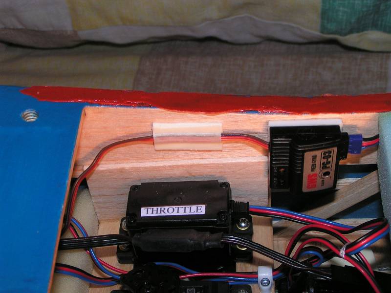

Regarding rudder-aileron co-ordination - I have quite a lot of aileron differential on mine and so hardly need any rudder.
Also, you may find it is quite a hand-full in cross winds, and what I did (usually do it on small bipes) was to add a small cheap gyro (GWS, weighs 7 grams) on the rudder channel as an added safety device.
I have a lot of cross-winds at my field during summer, and this does help - see pic how I installed it on the fuselage side.
If you choose to do so too, set the gyro sensitivity on the mid range since it does not have to be as on a heli where there are usually also very fast servos.
