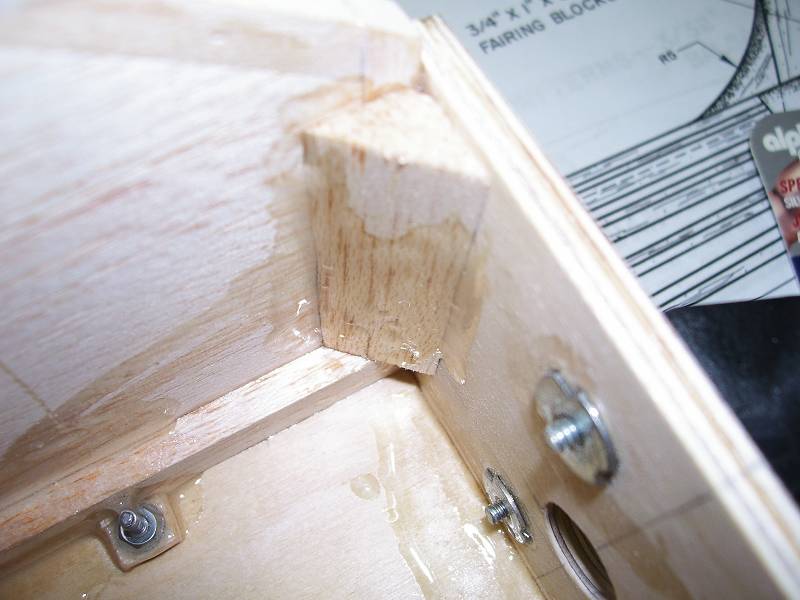

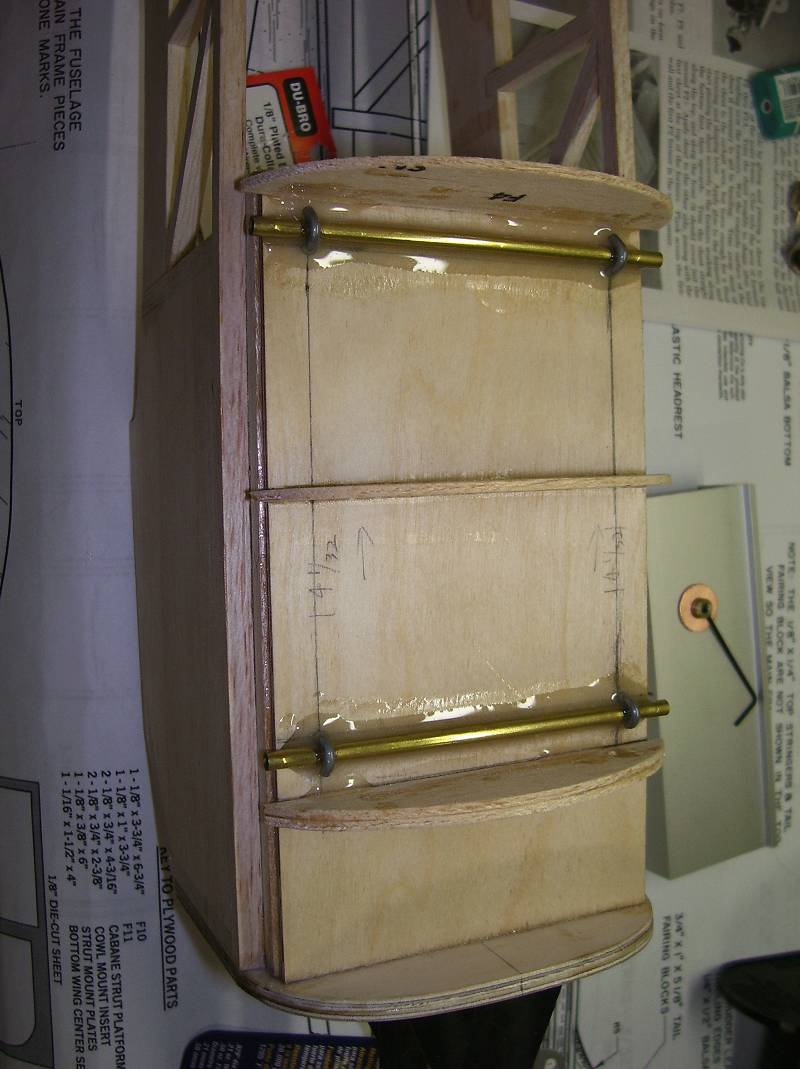

OK, as promised- a few more photos of the build.
I got the cabane mounting tubes measured and installed. Damn J-hooks were a pain, ended up having to cut them to size on the "j" end because they were too long, and also add wood underneath because there wasn't enough thread! [:@] Oh, well- it's done. I took very careful measurements, and when finished everything was spot-on. [&:] Luck. I also added balsa triangle stock to the firewall (not called for in the plans, but I would rather not have the engine make any side-trips).

The triangle reinforcements...
I got a little sloppy w/the epoxy

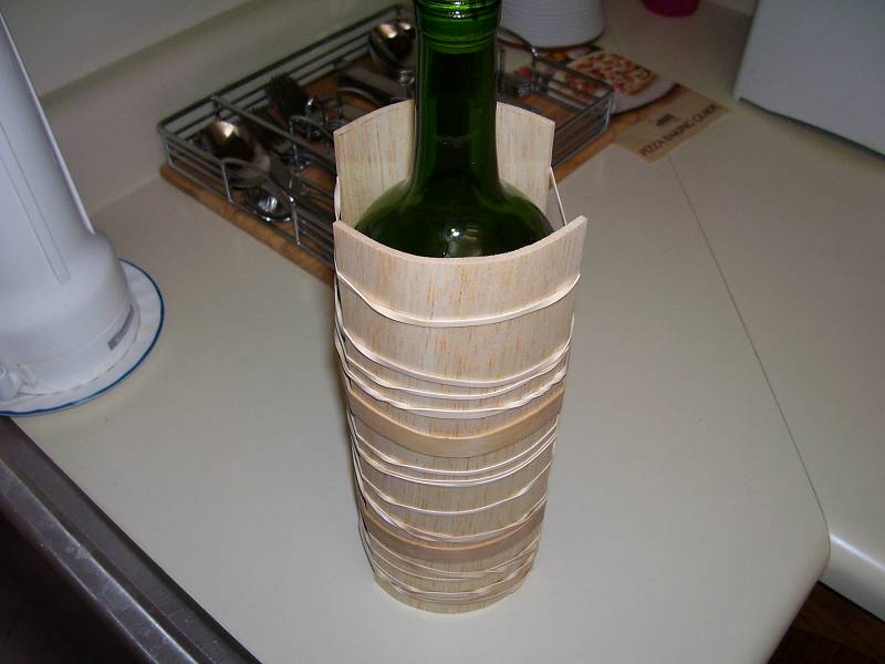

OK, next thing you do is begin the sheeting process. I cut the rough 1/8 balsa sheets, wet them and wrapped them around a wine bottle of appropriate size for 24 hrs. When they were dry, there was very little bending necessary to form them to the fuse.

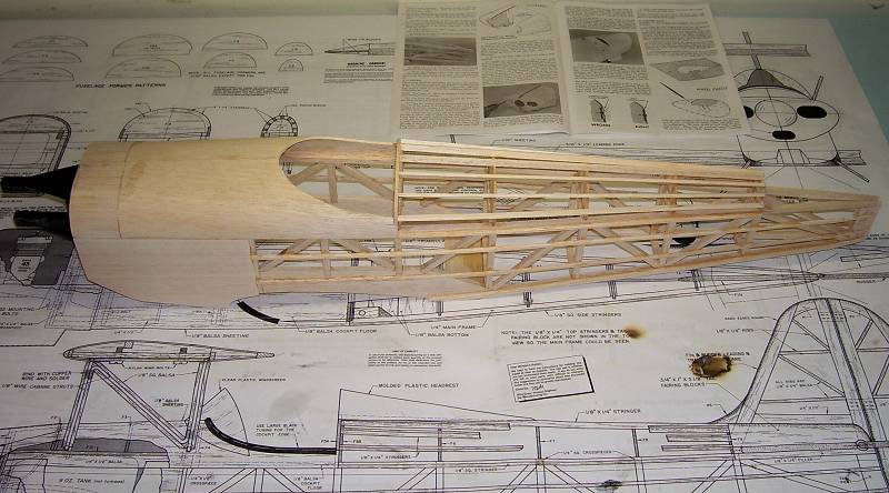

OK, as promised- some shots of this week's progress. Side stringers, and some more sheeting.
I'm getting into a part of the build where I really have to pay attention to the plans- for a lot more than just parts alignment. Example- the rectangular plywood cowl-mounts are supposed to be flush-mounted on the sides of ther fuse, inside the balsa sheeting. The instructions tell you to sheet the sides, but say nothing about cutouts for the plywood pieces. Guess if I'd seen that before being told to laminate sheeting to the fuse sides, I would have done the cutouts beforehand- doh!

what's the nice little "burn" on the plans just in front of the fin??? LOL

Uhh, in regards to the burn... I was gettin' a little tired to be using the brazing torch, I guess, just not paying attention. [sm=spinnyeyes.gif]
Thankfully I have the plans scanned; those were just a copy. The originals will be archived.
