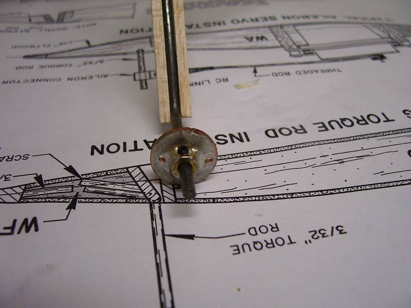

Homemade flanged wheel collars! - for those of you building this kit, I couldn't find them for sale anywhere, so I just soldered 1/8" I.D. collars to copper washers, and drilled holes according to the plans.

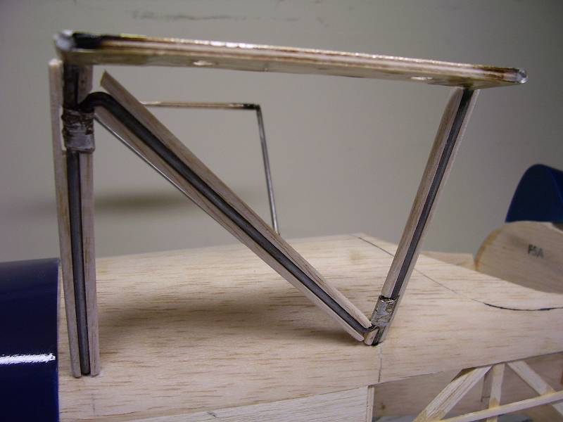

Here's an example of the balsa trim that goes on all the wires- cabanes and L.G.
Glue it on, fill the spaces, sand it to shape, paint it.
*$^%&#@ fiddle work!

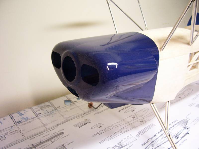

The cowl really shines up nice without the coating of balsa dust....

I would've waited to paint the cowl untill all the butcher work could be cleaned up. Looks good though!

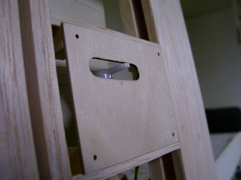

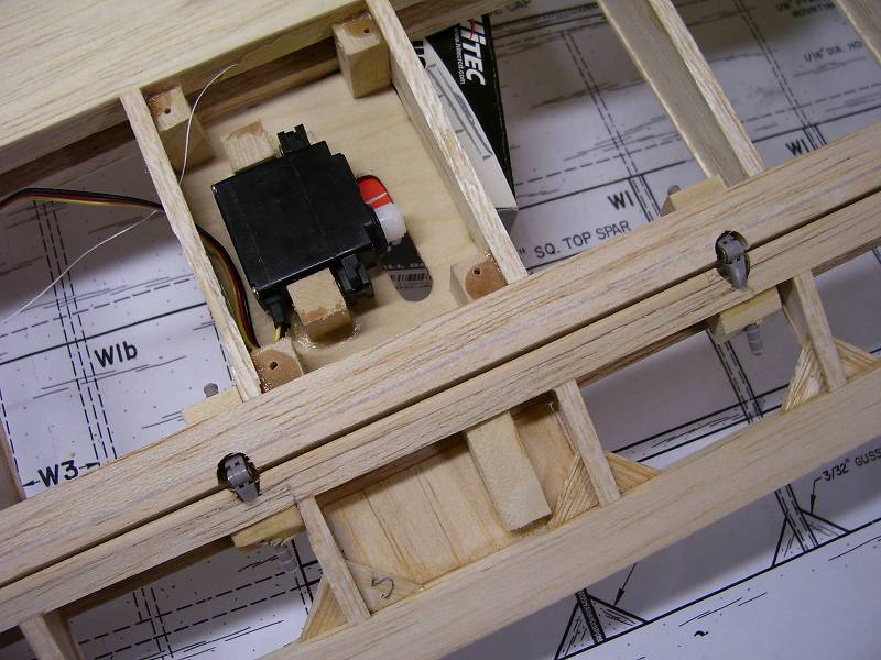

Here's a picture of my servo hatch, starboard side. Its just a mock-up, nothing screwed in yet. I know the holes for the hinge points look godawful, but after they are glued they'll be filled, no one will ever know.

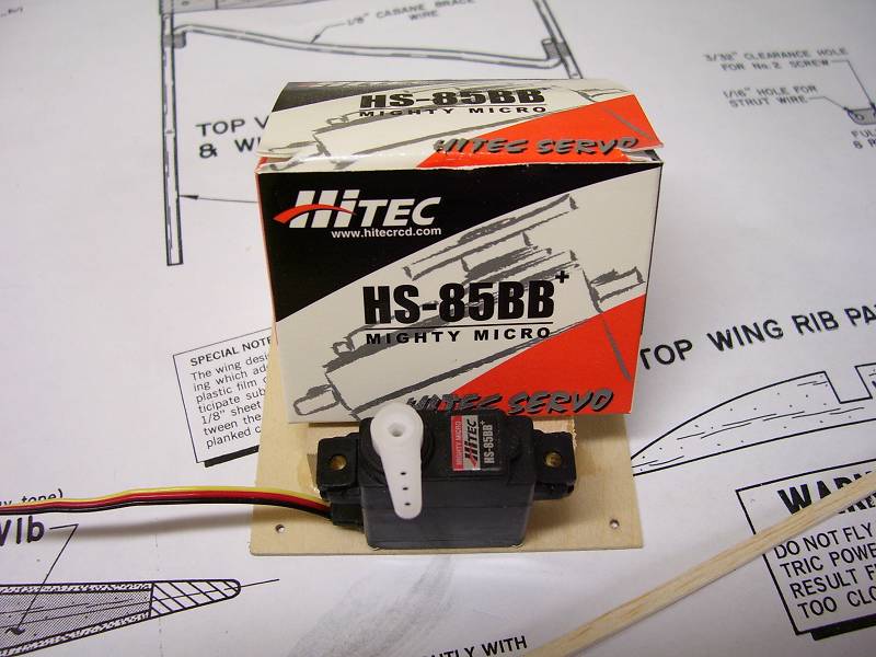

I'm using these little gems for all control surfaces, and an HS-81 for throttle. These new high-torque/high-speed mini servos are great! Save weight without a sacrifice in performance.

An exterior view of the hatch...
the gap that you see will be filled with a cap strip, basically.
