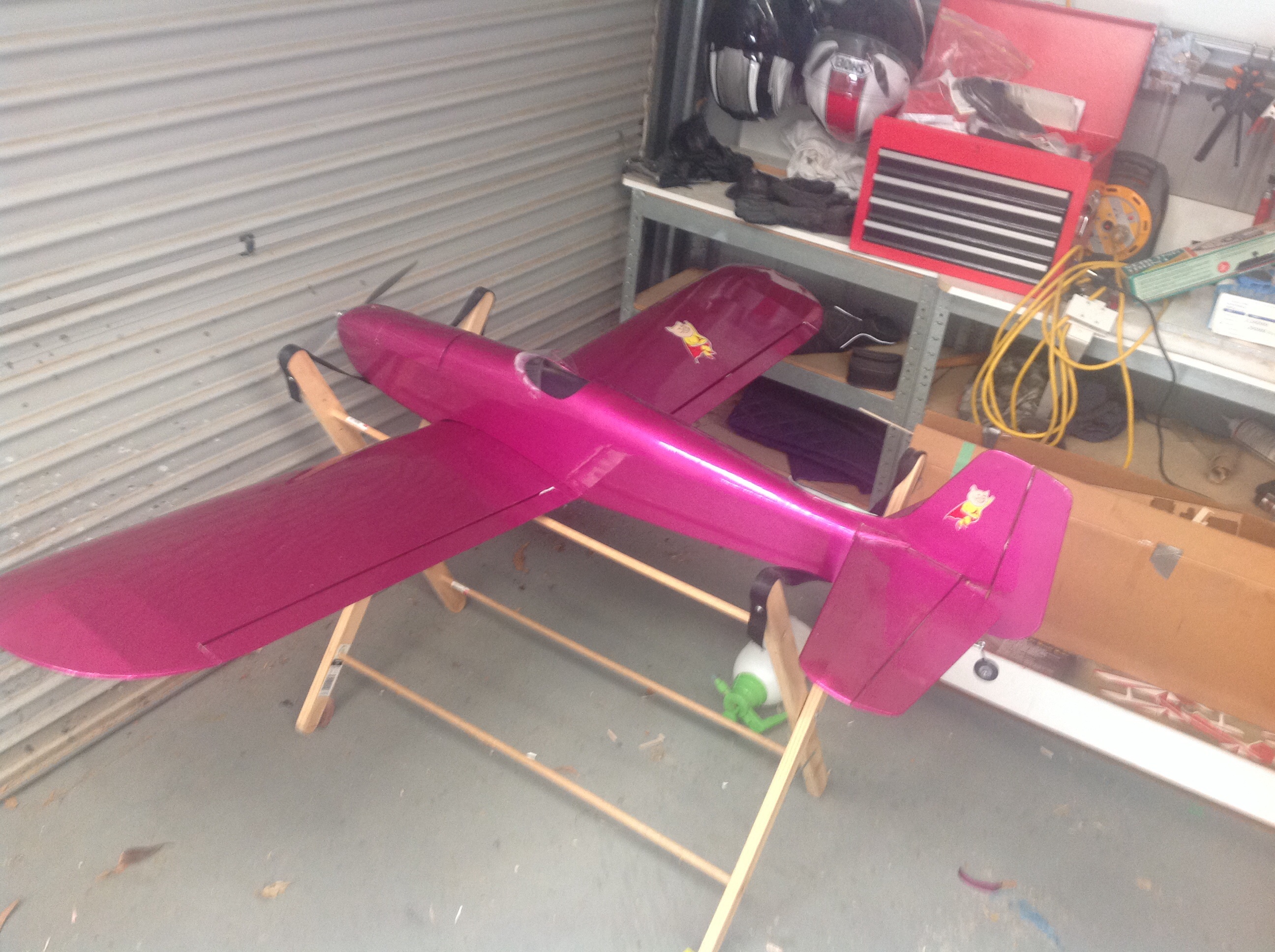

I know this is an old thread, but, still relevant.
started the hog about a month ago, and am up to covering.
here is a pic.
Going electric, so have a hatch on top, and upper front section filled in, underside open.

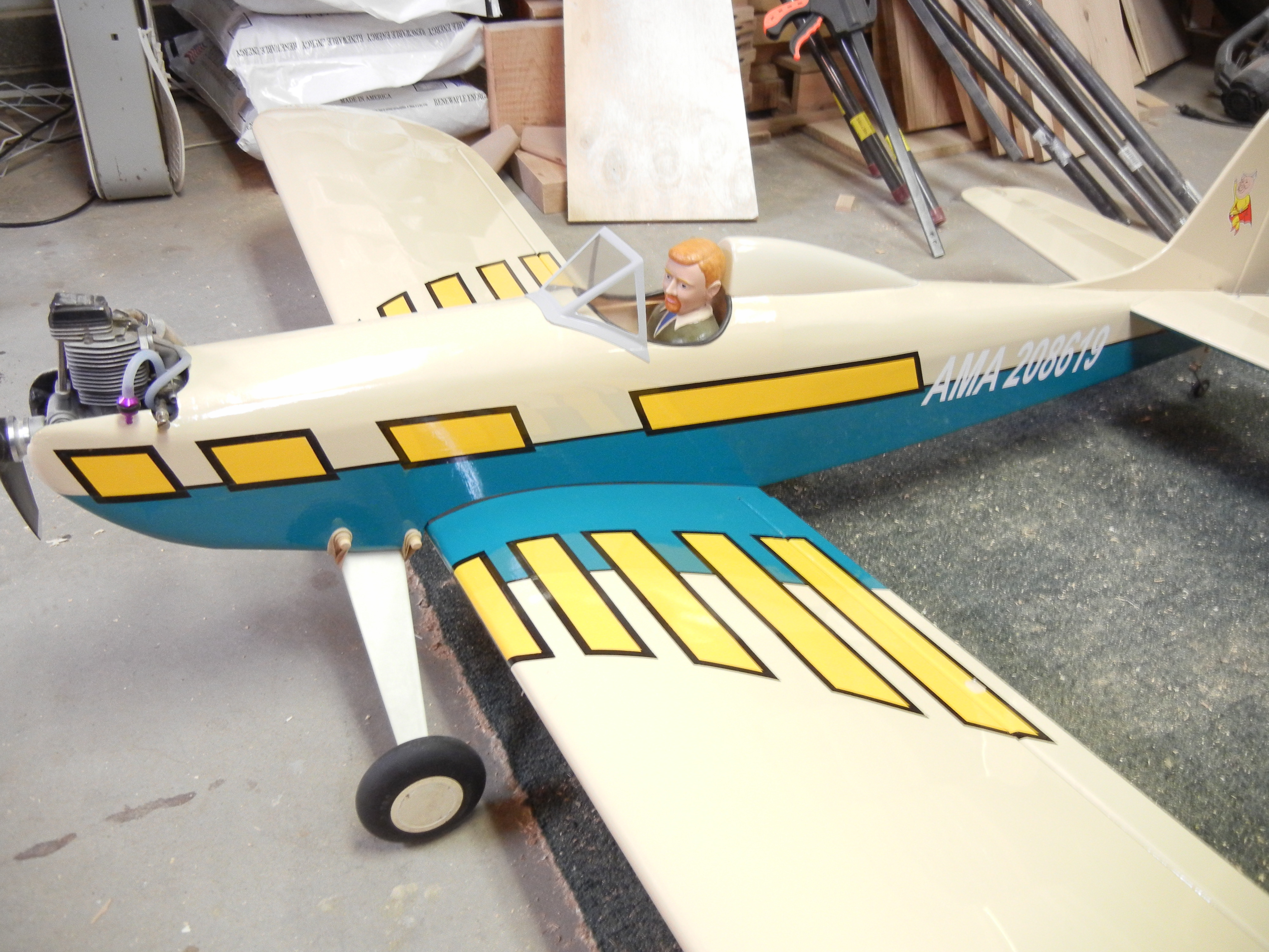

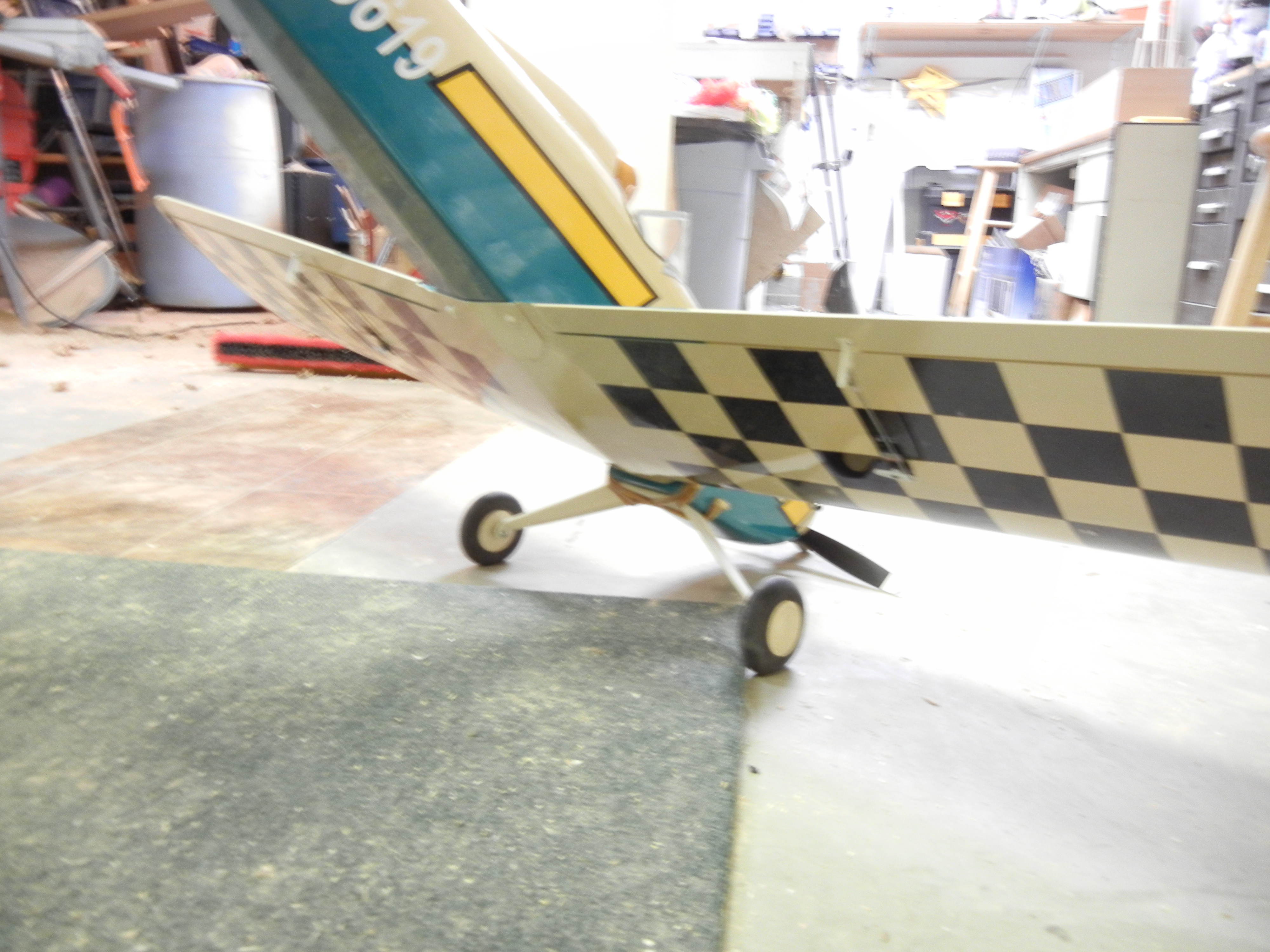

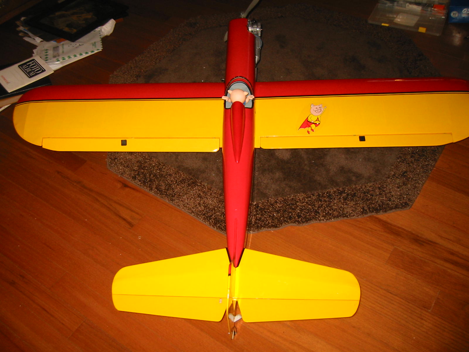

Found this thread awhile ago, have been enjoying it. Now I figure I'll add my HOG to the collection.
OS .91FS As you can see I did mount the LG up front (clearance for the prop was the reason) I mounted it with rubber bands (old school method) and it has gone a full season with nearly 100 landings with NO troubles! I do replace the bands when they get slack.

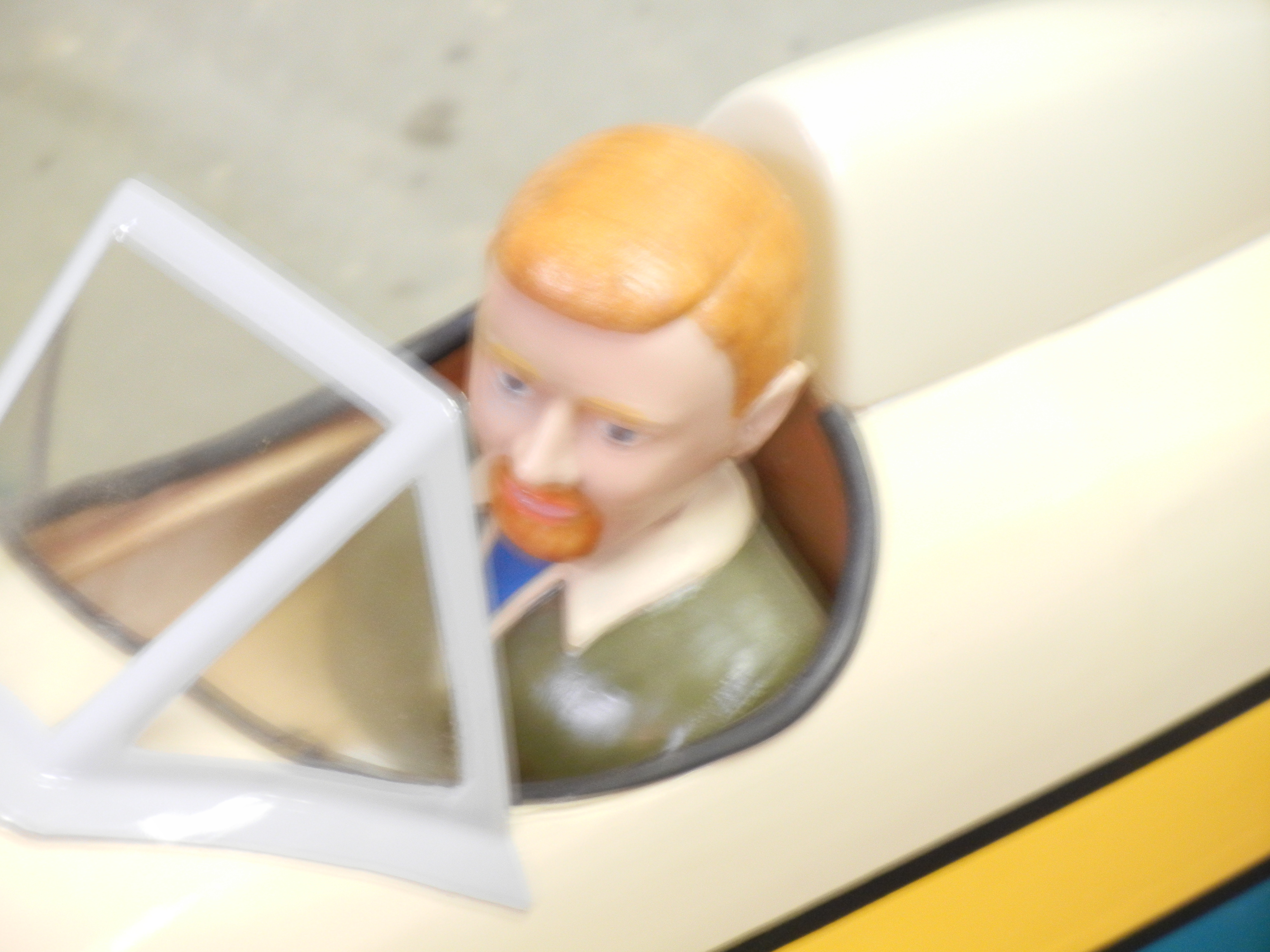

All Mono-kote covering. The windscreen is the GP Stearman ARF unit. The pilot is a dead ringer for the one holding the radio (me).
The checkerboard pattern is hand cut squares. The LG and wheels are "old style" which sort of goes with the age of the Astro Hog vintage. She fly's like a dream!

Here tis, ready for maiden.
c of g was spot on as planned. Redback 91 installed, with 6s 500 lipo. Wattmeter showing 1250 watts pulling 55 amps with a 15 x 8 prop. Havent weighed it, but doesnt seem heavy. May swap out for a 61 sized motor if it is overpowered, and use the 91 for a hog bipe that is on the building board. Underneath of wing is white for orientation.
Maybe at the field next week?

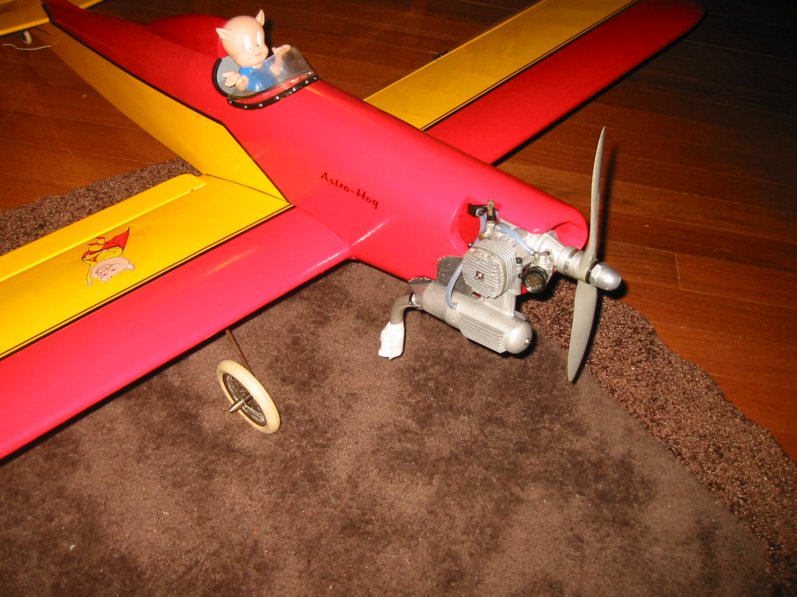

My Astro Hog. Powered with a OS FX.61 mounted horz. It's a fun airplane.

Broken Wings, Did you get those wheels from a stroller? I have some like that on my Senior Telemaster!
Good use for them, it gets the fuselage up a little higher.

well, maiden was mixed.
plane flew well, but roll rate was very slow.
turned left under power, glided straight, so some right thrust was required.
once trimmed, flew straight, but very 'mushy' in recovery from manouvres. Again, could be some learning and adjustment required from pilot!
cuban eights fine, loops fine, inverted ok, rolls slow and 'mushy', but that could have been the pilot.
landing approaches straight and fuss free. Glide easy to manage.
on third battery, though, managed to stall it, drop a wing and it now needs a new nose.
wing fine,
never mind, a few hours work will see it back in the air.
91 sized electric seemed about right. Takeoffs at about 70% throttle. Plenty in reserve, vertical performance fine

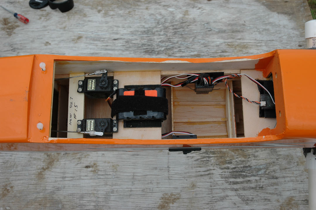

I finished a "new" Hog last year and It has the stock dihedral.
I think you are right that it might fly a bit more precise with less dihedral, but I think it might lose it's old time charm.
So far my Hog has done everything I've asked of it. I think due to it's shear size, it will never be a performer like a smaller trimmer plane.

It came out a bit nose heavy with the electric motor and large 6 cell battery pack. Moving the flight battery a bit to the rear cured it.
I also lengthened the main gear legs a little too. I could have used a smaller electric motor, but that's what I had in the drawer. The electric power is a lot more than my last Hog had. That had a K&B 45 green head.
