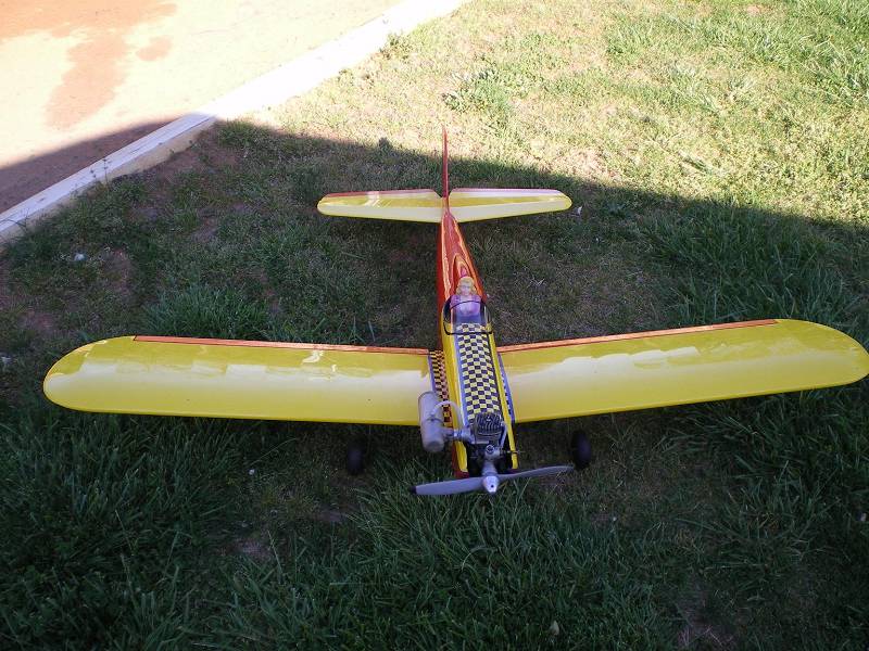

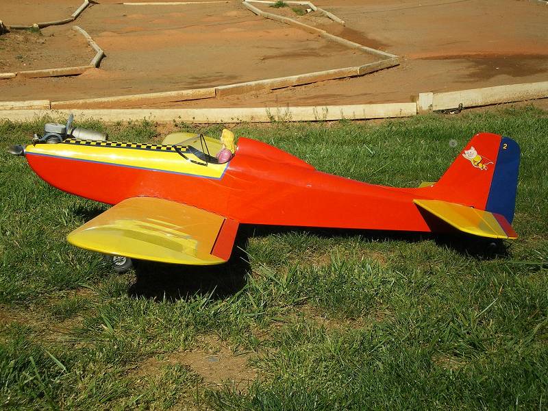

here's a few pic's of trackman's astro hog

Beautiful work!! Can't miss it with this colour scheme.

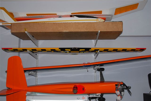

Great to hear you hogging!! Congratulations. My Hog is resting on the shelf for nearly 3 mths already. Maybe this weekend I'll bring her out for some fresh air...

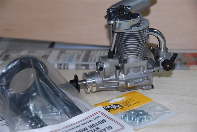

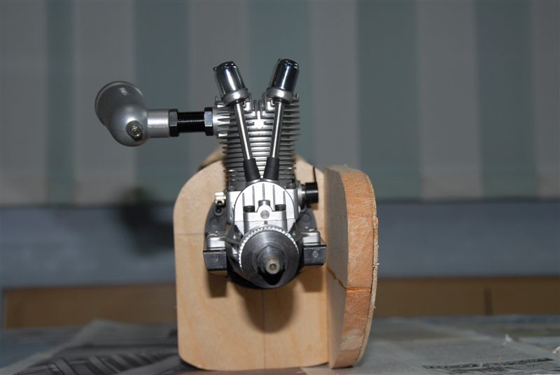

Yes, yes, yes... Saito 91!! You will love it.

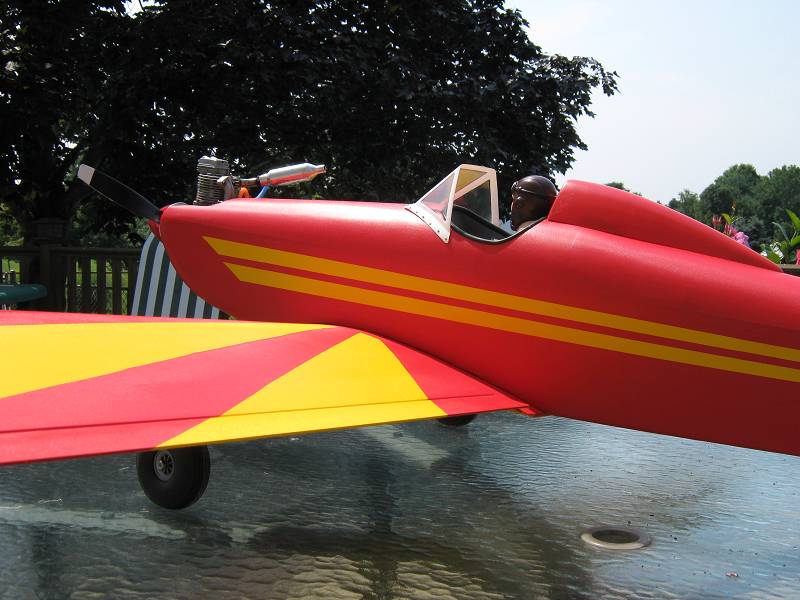

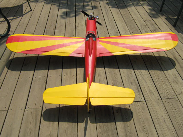

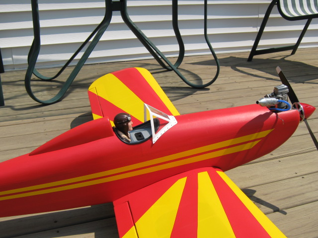

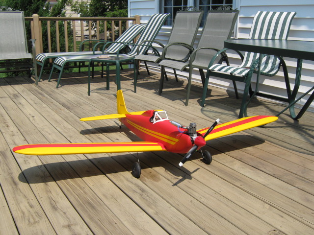

The "Hog" build was completed today. Fairly easy build with the following comments:
I made a joiner from music wire for the elevators as I was a little leary of the wood dowel per the plans. Kept the dehydral at 12 degrees (6 per wing) per the plans. Covering is "Solartex" and a shot of "Minwax" semi gloss polyurethane. The windshield and pilot are both replacement parts for the G.P. "Stearman". Tailwheel is "Sullivan" and finally, it is powered by an old O.S. FS-70 4 stroke ( I hope it still runs O.K.). Later this week or next I will maiden her.

I really like it a lot, very nice job.
The plane should do just about any trick you ask it to, just remember that it does it in a graceful manner as opposed to a violent manner.
I hope you like yours as much as I like mine.

[8D]You did a beautiful job. I'm flying my third Hog and it is also
powered with an OS 70FS. Good flying, I know that you'll enjoy
the aircraft. It's a classic.

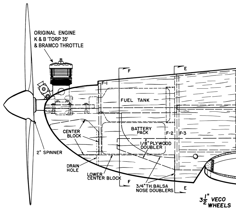

Beautiful plane, DaveB. I love the Solartex. I use Worldtex from Horizon, which is the same product. It's the best iron-on covering I've ever used. I've been hitting mine with Brodak clear dope instead of Minwax.

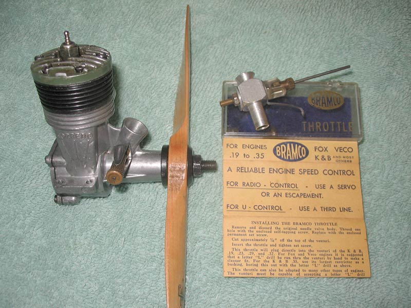

Your plane looks so nice I dug out my plans. I had forgotten about the original power plant. Recently, a friend gave me a NIB Bramco, so I also dug out a K&B .35. With today's lightweight radios it could probably be done.

Nice Plane! After you fly it, you'll want to make another Hog. I have a Saito 100 on my Hog and it is not over-powered. I echo Charlie's comment that it is a graceful flying plane so while it will do most maneuvers, it won't do them in an over compensating manner. The one thing to remember is that it is very forgiving in its maneuvers so get use to it before you try anything fancy.
