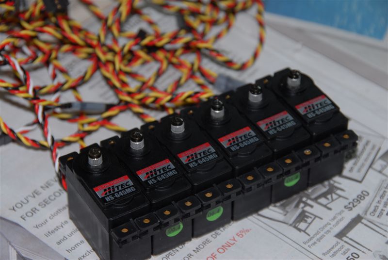

I will be using two servos for aileron control. My excuse is because I have 6 pcs of Hitec 645MG. But I would do this also to divide the load and have independant trimming for each aileron.
The weekend was supposed to be used for continuing the build, but guess what, the toilet flush started leaking and everything when downhill from there. [&o]
Anyway, I had only a couple of hours in my hands for the Hog so this where I am right now. There was a lot of shaving that needs to be done on those doublers.[>:] I will be drilling holes on the firewall before glueing the right-side of the fuse. But I was thinking I should get the engine and mounts first....

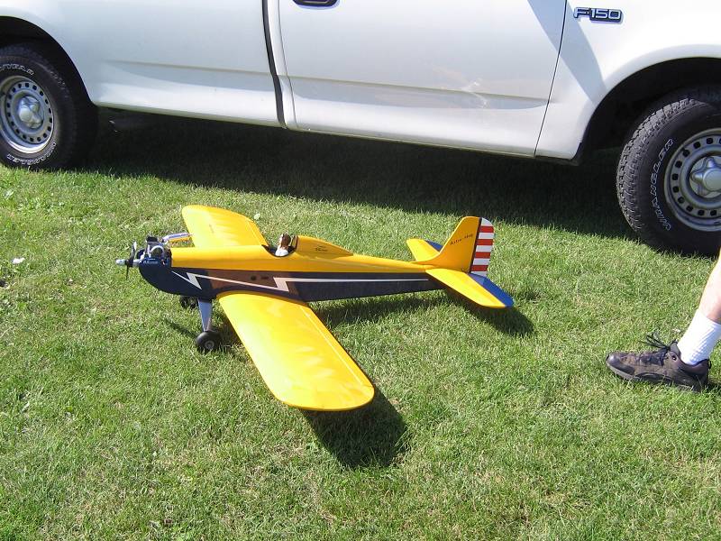

BD's Astro Hog - Insignia Blue and Cub Yellow monokote.

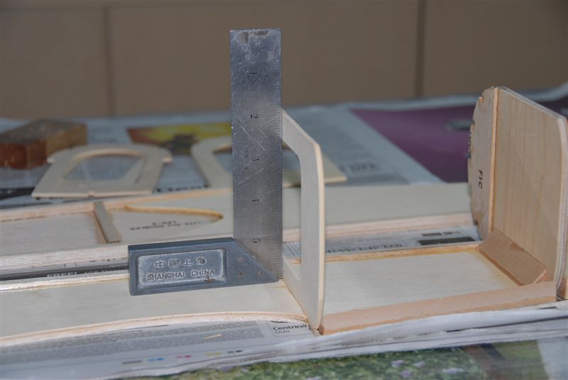

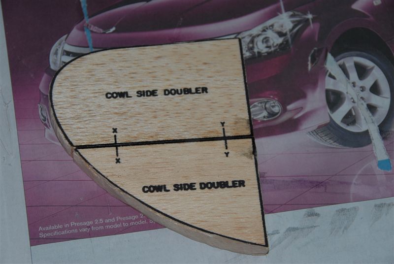

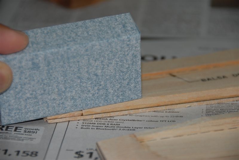

I did a fair bit of work tonight. Glad everything is falling in perfectly.

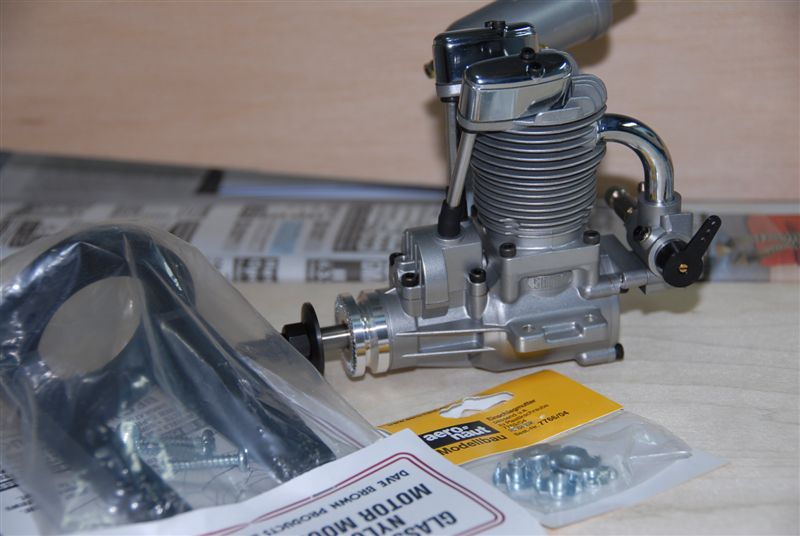

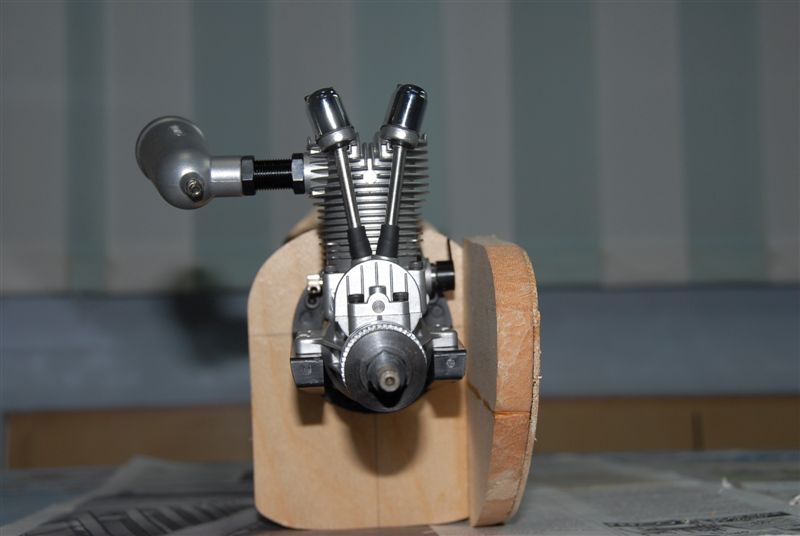

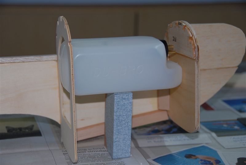

Went shopping to get a few more stuffs. My current inventory for the Hog.
Guess what size Saito I ended up with....

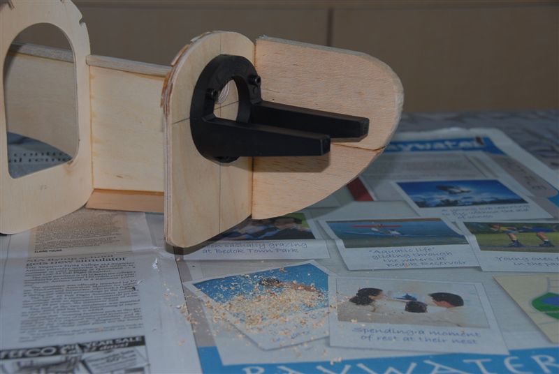

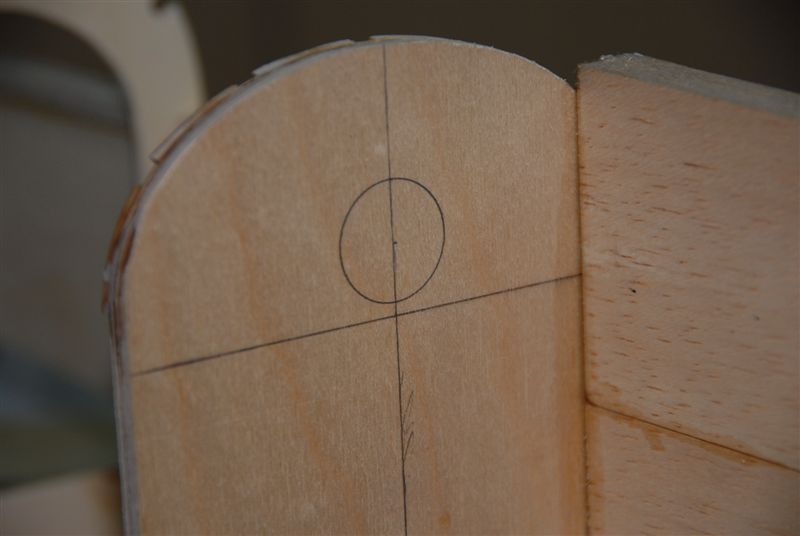

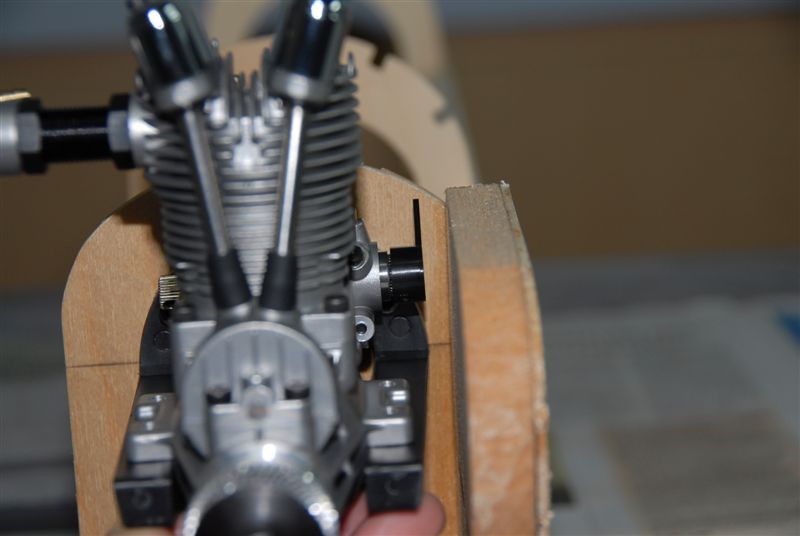

Done up the a bit more work on the firewall. I did not cut-out the soft balsa for the top two blind nuts. I compressed it far enough and later after applying epoxy, I think it should hold.
and of-coursse now I am left with the most troublesome part ,.. the throttle level []

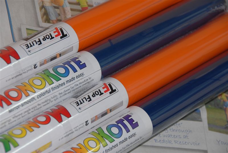

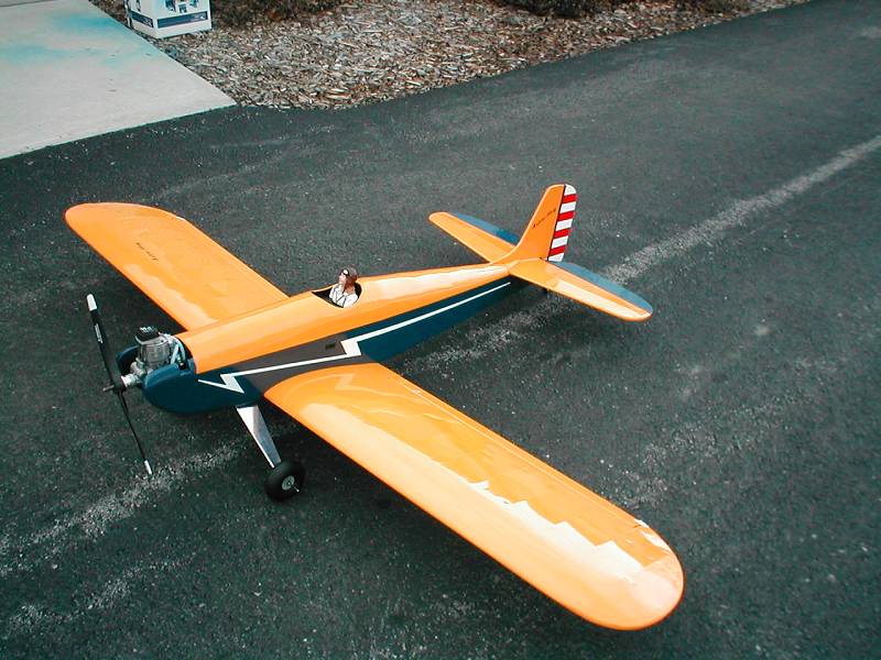

I found an orange and blue astro hog for you to see.....
