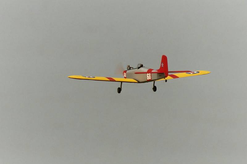

You will love your Hog once you get it in the air. Mine is a couple of years old and going strong, it flies like a trainer. Enjoy it.

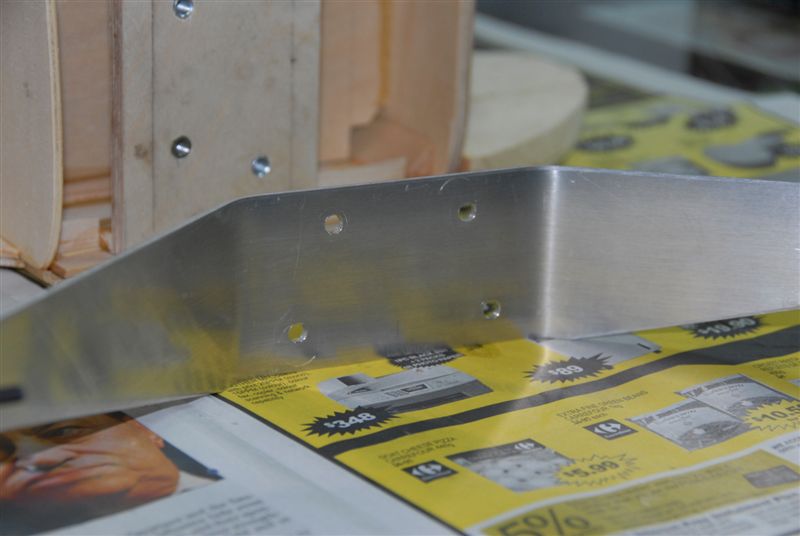

I have planned to mod this landing gear to the front from the begining, as I saw a few successful ones on the internet. I chose this alternative because I know I will mess up the moment I start bending the 5/32" music wire.

Hi Ugo, I know I may not be doing justice to the Astro Hog with such modifications, but I chose the lazy way out..LOL! I had a
PT-19 before, holding up elevator is a must. Its not the nosesing-over that I am avoiding, its the bending of the music wire.

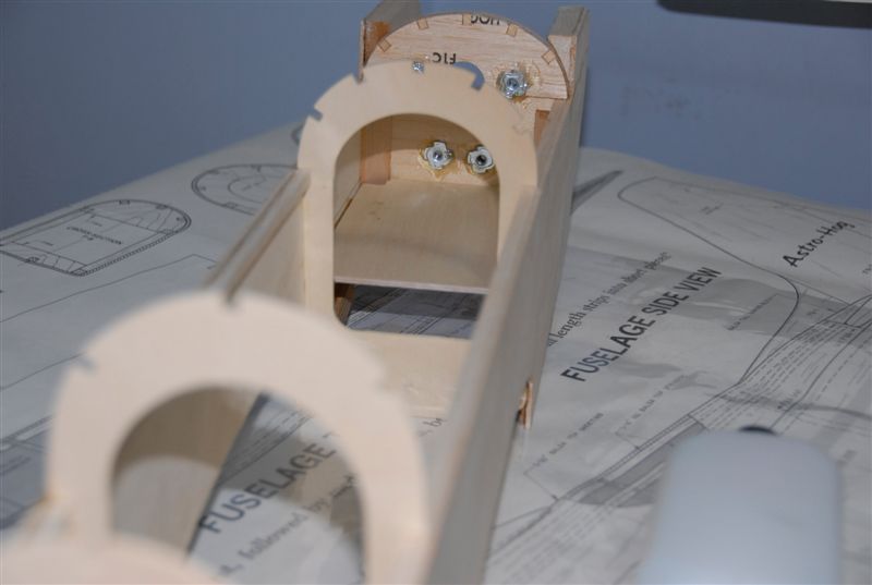

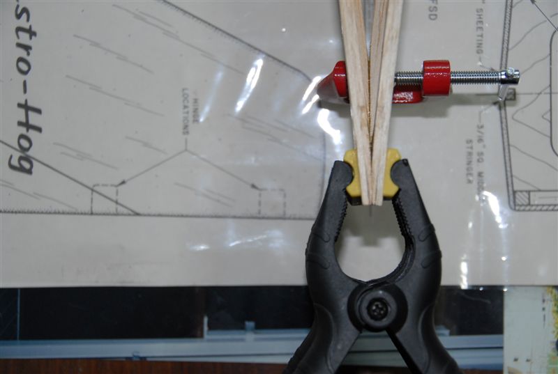

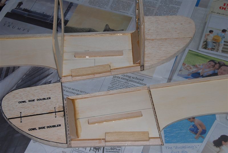

Well, I've made some progress over the weekend that takes forever to come and vanishes after mixing epoxy 3 times!!

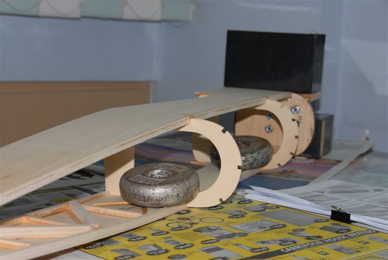

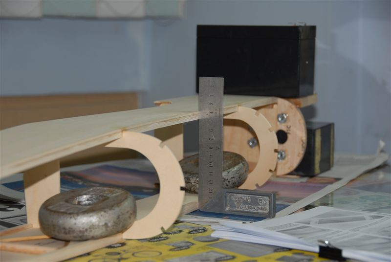

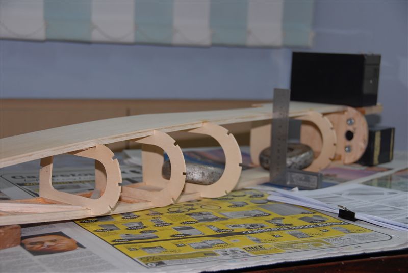

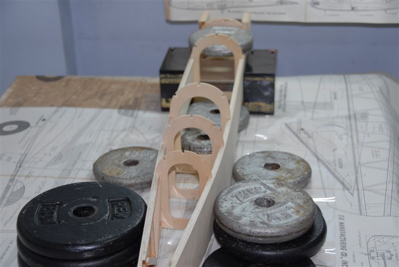

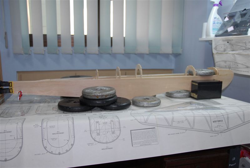

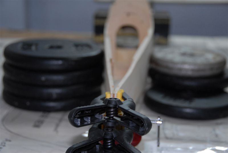

Finally put the fuse halfs together....yipee. I had to use the gym equipment...who says building KIT is not healty?...duh.

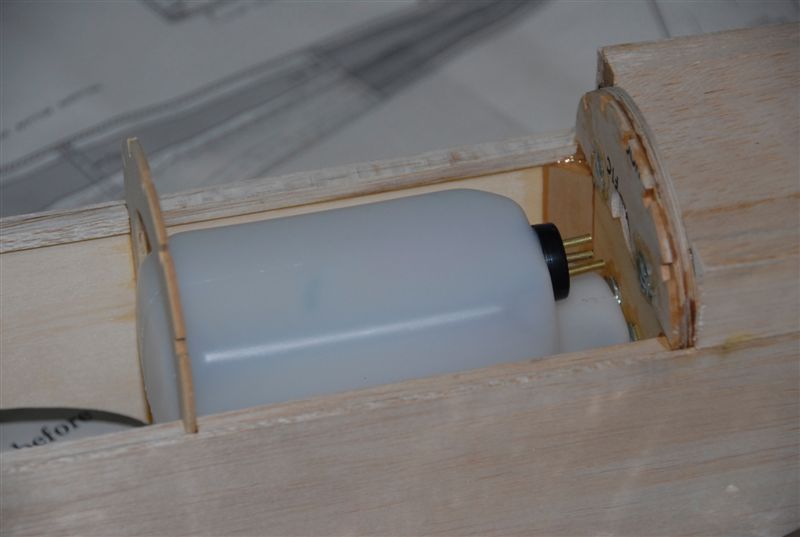

Trial fitting and positioning of the fuel tank. I would be glueing on sponge lining around the walls later so that the tank sits snugly.
Do you guys spread finishing resin around the fuel tank hull for fuel proofing or paint?

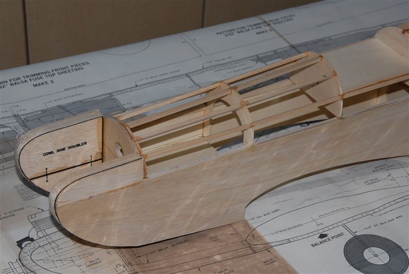

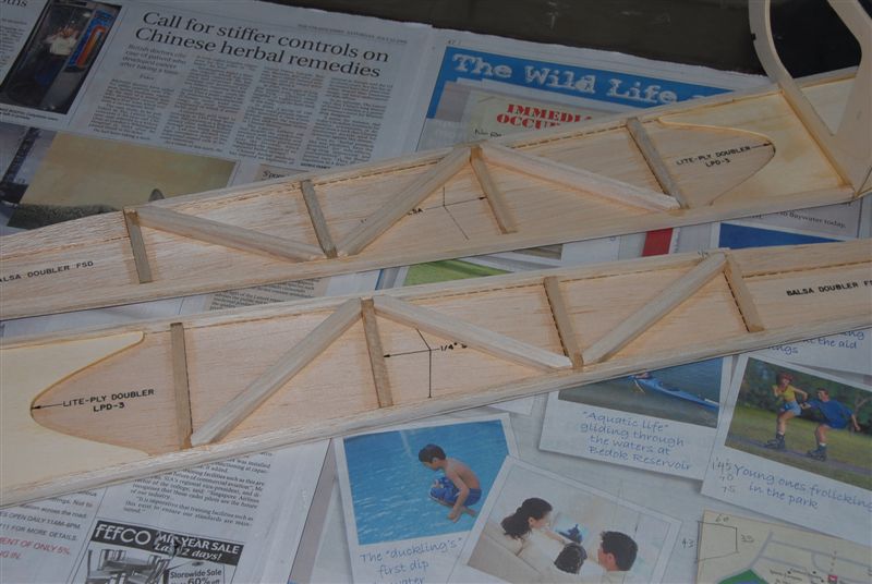

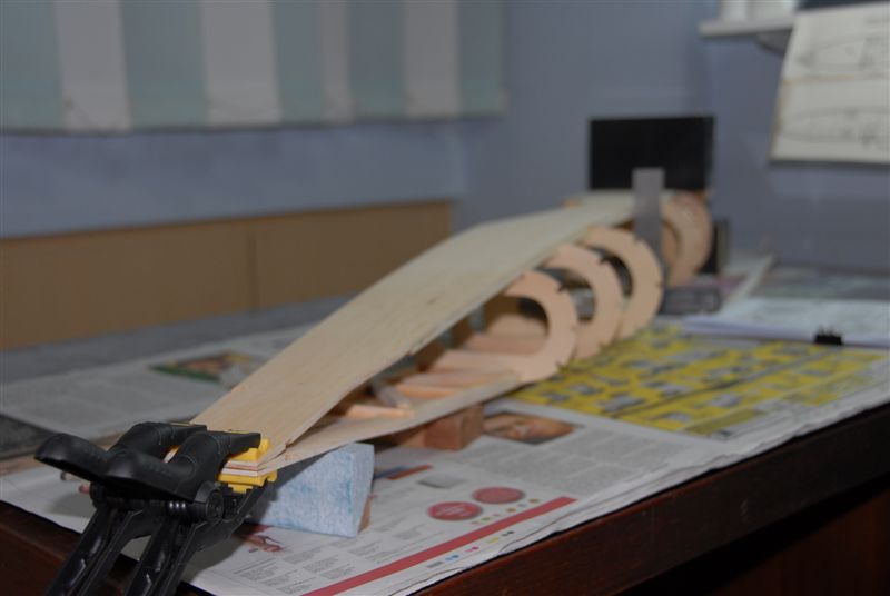

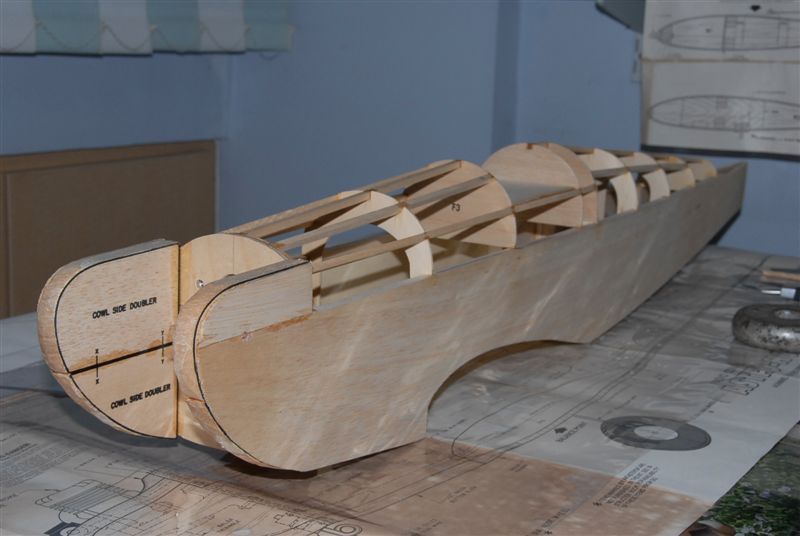

Made some progress on the top stringers and turtle deck. Will be working on the underside tonight.

I use epoxy to fuel proof, thin it with some alcohol.
If you put finishing resin (a polyester / fiberglass resin product) over epoxy it may not harden correctly.

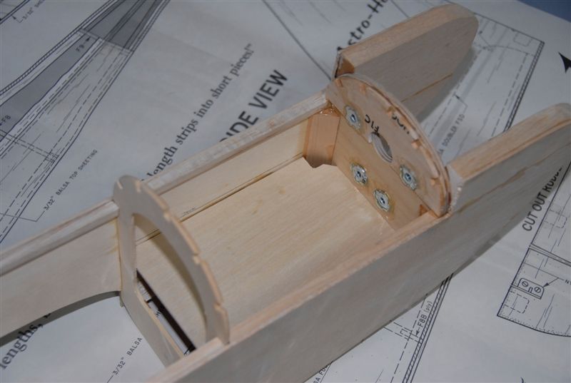

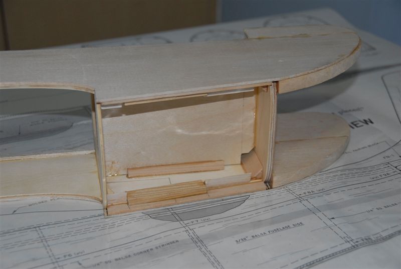

Hi Cubfloater, I took it slow for a few days as I was down with a cold. Nevertheless, I managed to do some work on the front gear mounts. I used four pieces of 5mm blind nuts and Nylon screws to fastened the aluminium gear brackets.

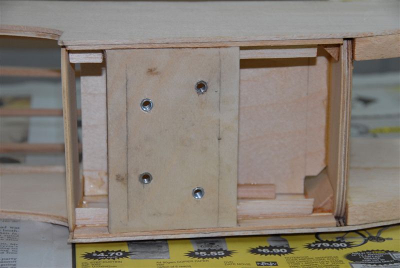

Old 12-03-2006 | 11:44 AM
  #75
mechplas's Avatar
Joined: Nov 2006
Posts: 583
From: Singapore, SINGAPORE
Default RE: SIG Astro Hog
Made a servo tray instead of running two parallel supports across the 1/4" stringers.
