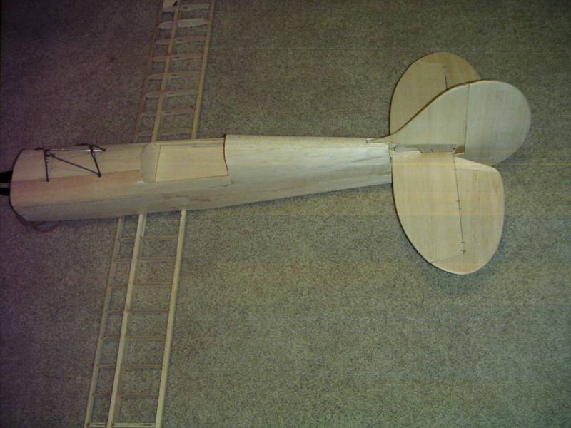

I've been busy with some house and work stuff lately but I'm finally back to work on my skybolt. I thought I would post a couple pictures of the progress. The fuselage is basically complete and I'm in the middle of installign the tail feathers. i've read the other threads on this plane but if anyone has anything to offer in the way of building and flying this plane, I'd love to hear it. I was going to use an ASP .90 2-stroke that I recently aquired but I've decided to go with a 1.20 4-stroke instead.

Oh boy! Another Bolt!!!
You are about to hit the most difficult part of the build (It was to ME anyway) and that's the fuse fillet between the fin and stab. Just take your time and do it right.
And keep us informed on the build!

The filltet does look alittle wierd. I was thinking about carving something out of solid balsa instead but I'll give it a try as shown in the instructions first.

If you have not glued on the stab and fin, create a "dummy" stab and fin filler piece the same thickness as the surfaces. Cut these to the shape of the fuse, and tack in place with a couple of drops of glue. Then tack the filler blocks in place, and sand to correct shape, using the fuse as a guide. Then remove the parts & install the flying surfaces. Now the filler blocks will be the exact shape needed.
Hope that description is not too confusing. It's really simple, just sounds complicated.

I've done this on plety of other planes. Unfortunately, the vertical stabilzer is glued in place just like the instructions call for. I could probably still manage to carve something but I'll try it the way it was designed first. Also, if the fillets were in place before installing the horizontal stab, it might be difficult to get the stab hold-downs in place.

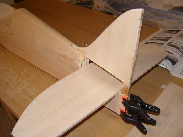

That's definitely soemthing to consider. Tonight I got the horizontal stab glued in place. While I was waiting for it to set up, I started framing the bottom wing. I didn't expect the parts to fit together so well, the bottom wing is nearly done. Sorry fo the poor picture quality. My good camera is sitting on my desk at work. Next I'll tackle the tail fairings and finish up the wings.

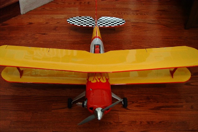

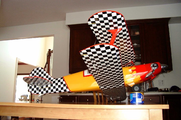

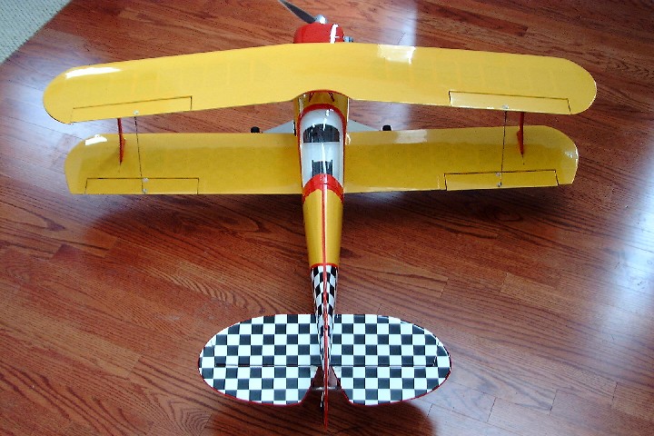

Chuck, looks good. I have built one also and love the lines on this bird. One word of caution, as previously mentioned; it builds very heavy!! Most of the weight is in the fus. as you know, be sure to sand the living heck out of it before covering.
Mine has a OS 91 FS on it and flys good, not 3D good, but good. Even with the 91 on it I had to add a lot of weight to the nose, with servos up front and battery under the tank. The YS would give good power, but again it is a weight issue not a power issue.

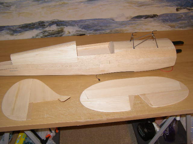

Nice lookign plane. I agree, the fuse is pretty heavy. Tonight I got the tail fairings done; they weren't as bad as I thought they would be. I'll move on to finishing the wings next week. I'll post more pictures when I make a little more progress.
