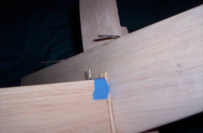

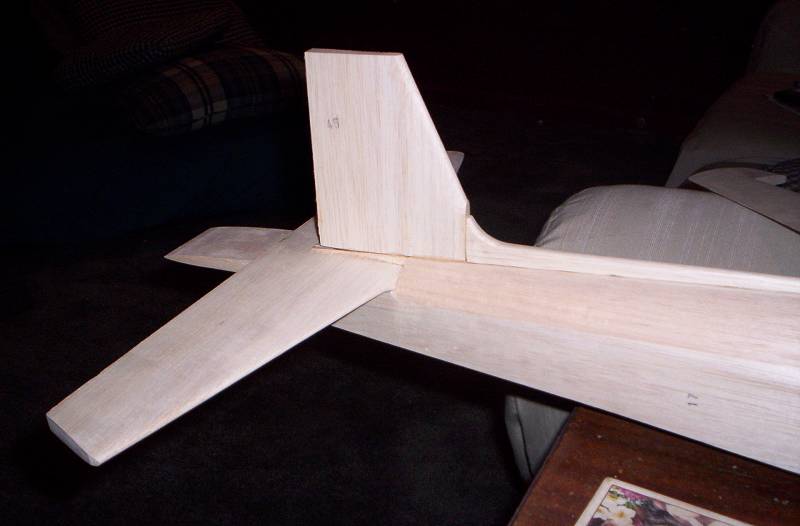

Old 01-21-2007 | 01:47 PM
  #42
WacoNut's Avatar
Joined: Jan 2005
Posts: 6,604
Received 36 Likes on 33 Posts
From: Blanchester, OH
Default RE: Jack Stafford Chipmunk
Here are some pics of the tail wheel assembly I made,
It will allow the linkage to remain inside the fuse and control the rudder and tail wheel at the same time. The plans call for individual control rods, this setup will save weight and trouble with maintenance down the road.
The dorsal fin will require some filling where it meets the fin and some sanding but the plane is starting to take shape.
Anthony

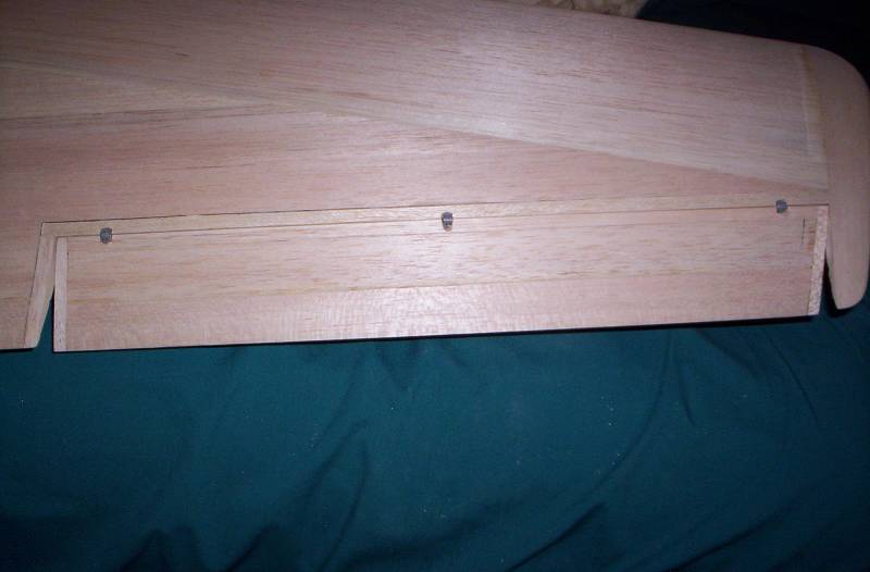

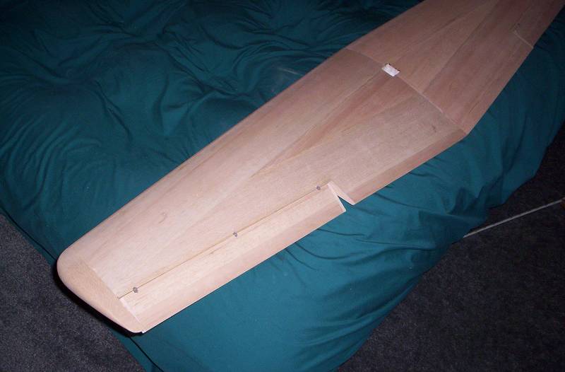

I have the aileron's hinged,
The Robart hinges are installed in the aileron's, IMO these are the best hinges on the market. I am using 3 hinges per aileron. The fuse sheeting appears to be dry enough to start sanding. I will shape the fuse then finish up the wing saddle.
Anthony

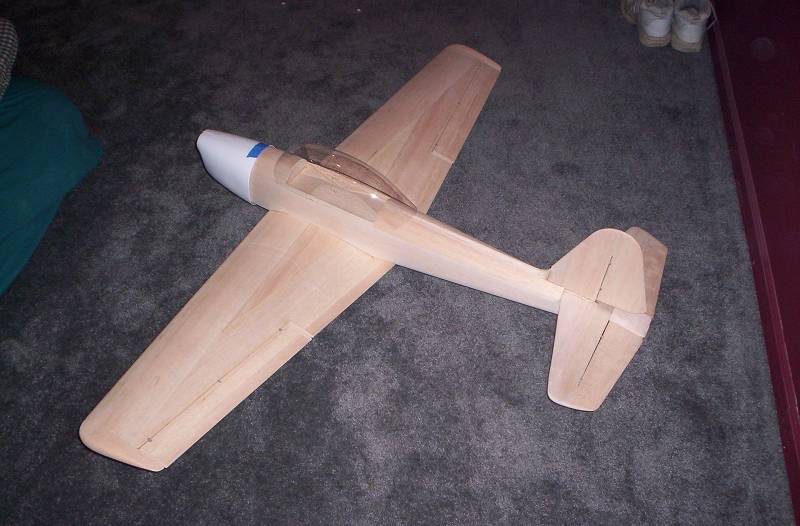

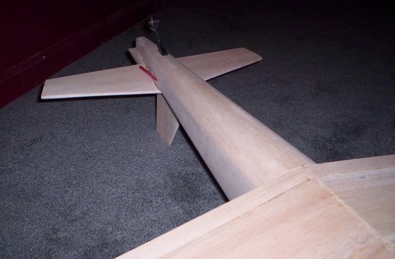

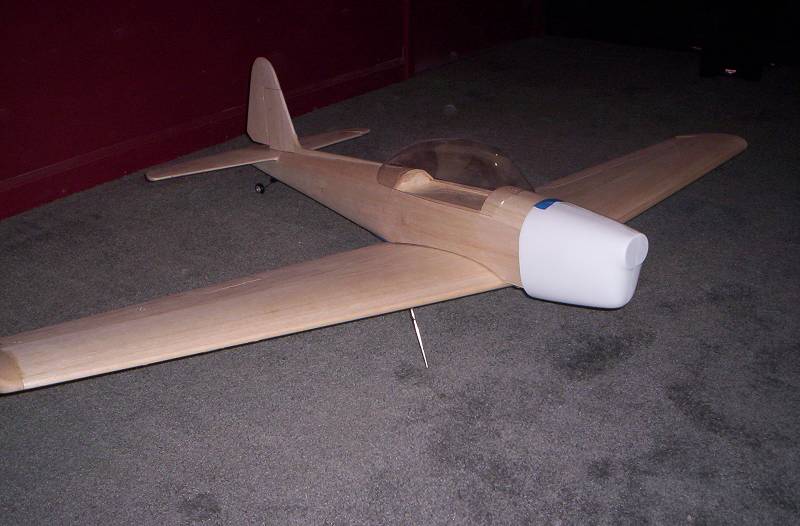

Old 01-28-2007 | 10:41 AM
  #48
WacoNut's Avatar
Joined: Jan 2005
Posts: 6,604
All the flying surfaces are now hinged,
I am going to install the wing mounting blocks in the fuse and close up the foreward bottom section of the fuse. There is ample room to install the tank and set-up the throttle linkage through the wing saddle. I have alot of work remaining, I need to add the wing saddle fillet and fillets at the tail feathers. Once this is complete I can give the plane a final sanding and a coat of sanding sealer in preperation for covering.
I am not going to use the wheel pants that came with the kit, I have a set from another plane that are a little more streamlined and should look very good on the plane.
Here are a couple pics of the plane dry fitted together standing on it's legs!!
Anthony
