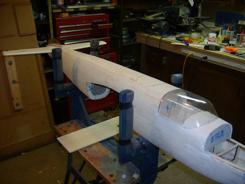

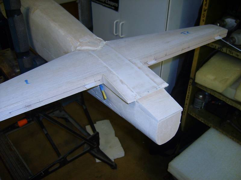

Ordered the retracts last saturday, got them from wing mfg...why not..Anyhoo, got the horiz stab installed, as well as the rudder pushrod and finished sheeting the fuse. Got some cleaning up though, and some filling to do.
As a state employee, I did, in fact utiltilize presidents day to it's fullest extent, and enjoyed every minute.

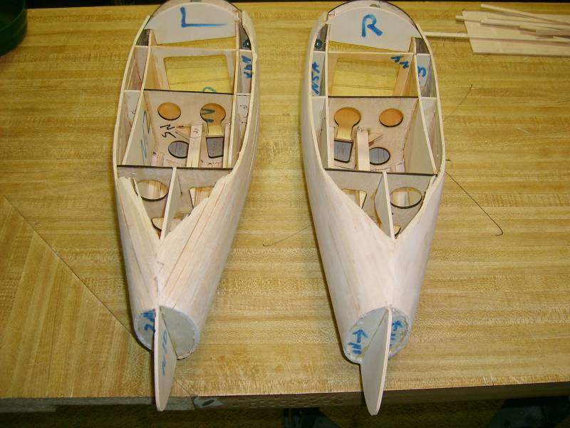

Old 02-25-2007 | 09:55 PM
  #29
Fili's Avatar
Posts: 759
Received 24 Likes on 22 Posts
From: Queensbury, NY
Default RE: Wing Mfg B25 Build

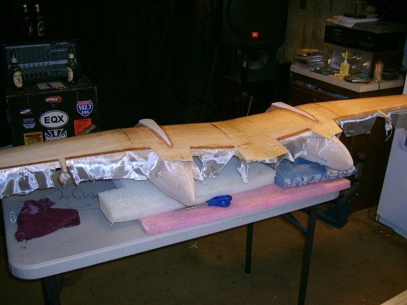

Got some work done on the nacelles, I ran out of glue, so I was able to get some other things done. I mounted some hardwood dowels in the elevators for my control horns. I also rough sanded all control surfaces and filled rough spots. My retracts are on backorder, but that's ok as I'll take my time getting ready for fiberglassing.

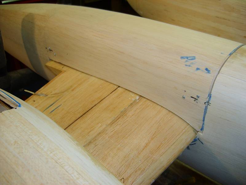

Old 02-26-2007 | 10:27 PM
  #31
Fili's Avatar
Posts: 759

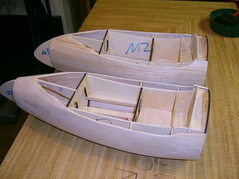

One nacelle planked....what fun. I did get her rough sanded and some filler on her, Just didnt get a pic.
ID:	630692   Click image for larger version

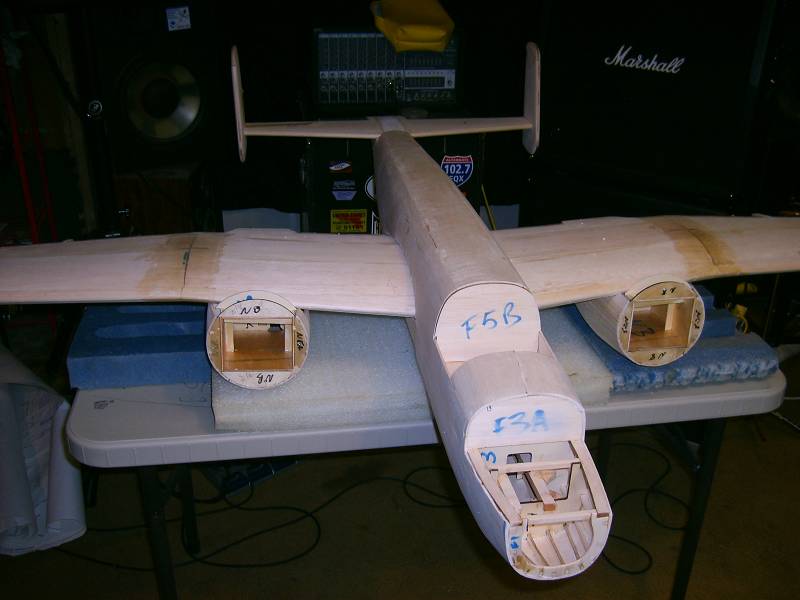

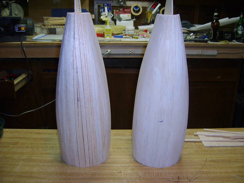

Old 02-27-2007 | 11:03 PM
  #32
Fili's Avatar
Posts: 759

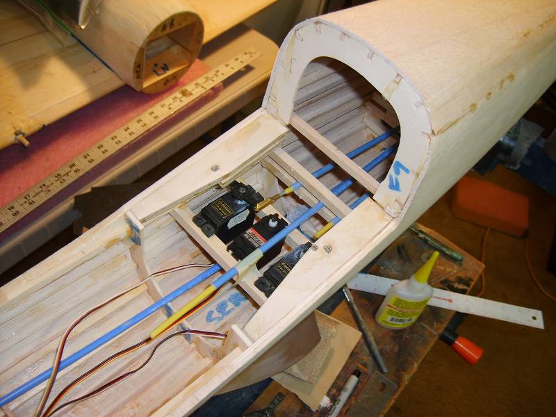

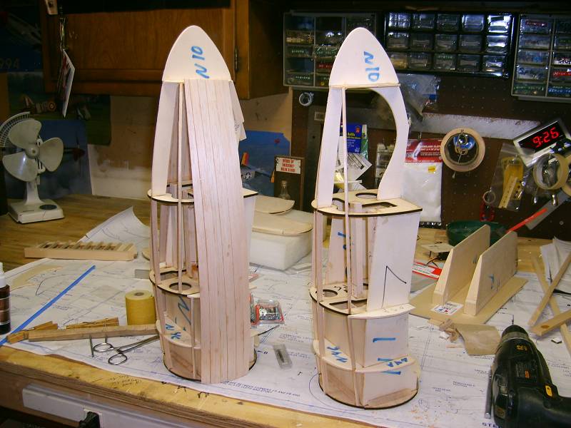

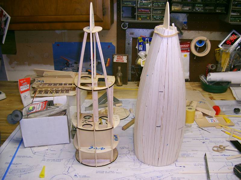

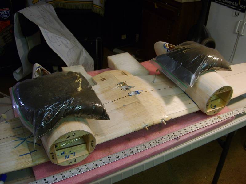

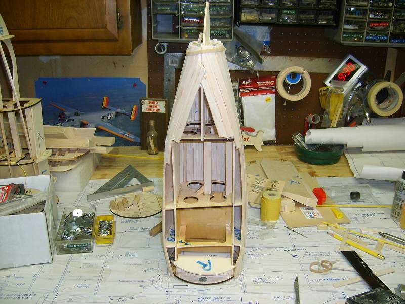

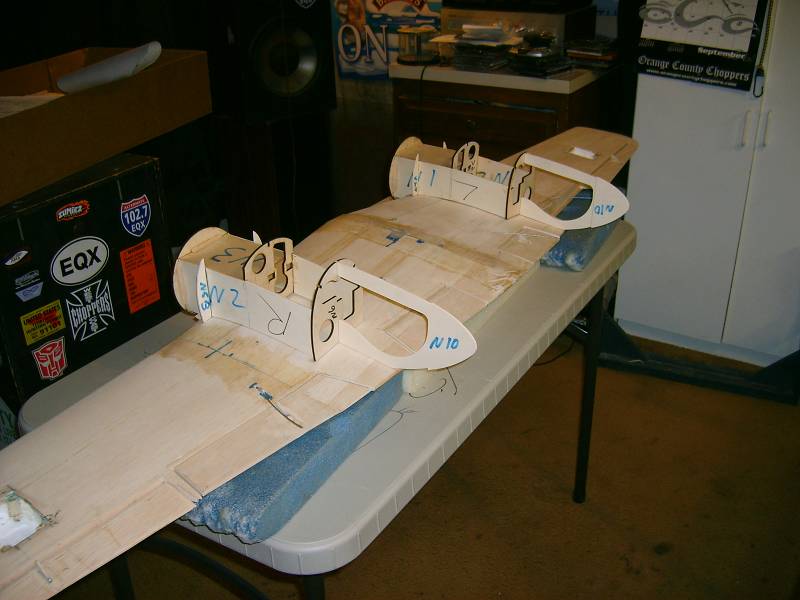

Got the other nacelle planked. whew, glad thats over. All of the major componants...Fuse, wing, control surfaces, tail feathers, nacelles, are now built. I can now start on the prepwork to begin glassing. You know, filling and sanding, filling and sanding. Then I do some filling and sanding......
ID:	631323   Click image for larger version
ID:	631324   Click image for larger version

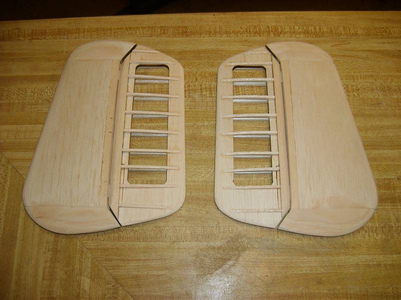

I really dont mind the glassing part, I know it's one step closer to getting her finished and in the air. I was able to installl the wing dowels and drill, tap and install the wing bolts............so, I just had to put her together!

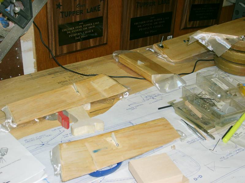

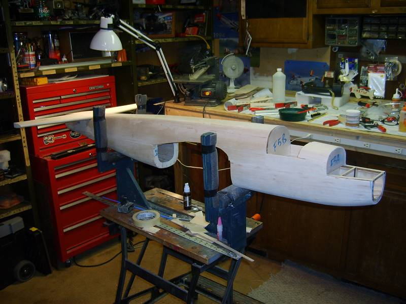

Started glassing the control surfaces, also got to tidy up the tail end as well.

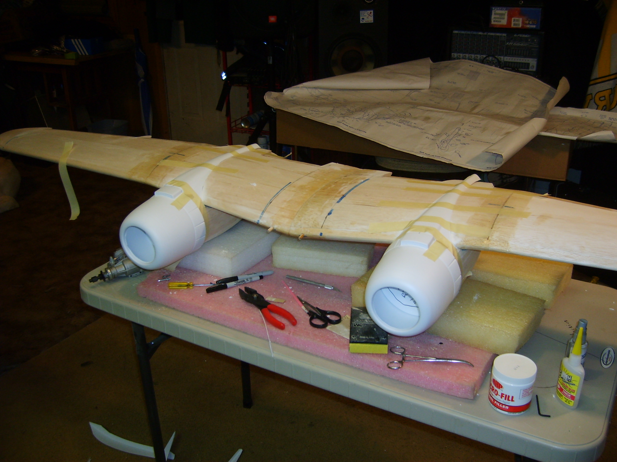

Well....Drilled all the holes to mount the retracts, Epoxied the nacelles to the wing, finished shaping the fins and rudders. I still want to be sure of a good bond between the nacelles and wing, so after the first gluing has completely cured, I'll get around the edges inside with some fiberglass and resin to reinforce the joining. I also have all the control surfaces (except the rudder and fin) glassed and ready for the first coat of primer. I'm still not sure how or where I'm to install the throttle servo. I'm going to use mini or micro servos, so I know I'll be able to get in the nacell through the retract openings.... I was also able to fill and sand the wing crutch to the contour of the wing, mount my elevator and rudder servo rails. Not a bad weekend....

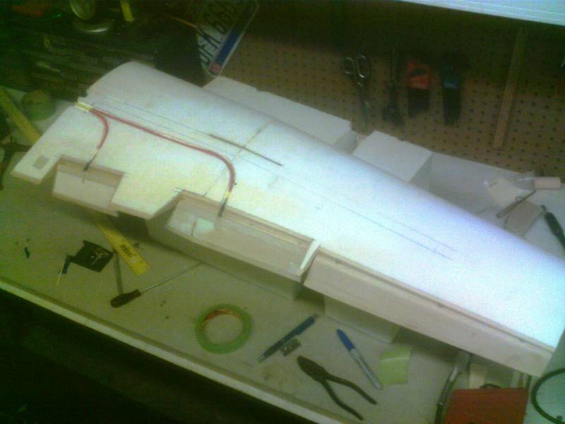

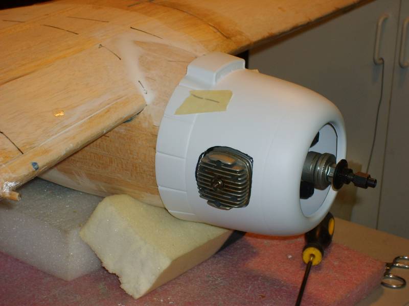

Old 03-23-2007 | 10:26 PM
  #43
Fili's Avatar
Posts: 759
Day by day, Just ordered a bunch of stuff I need to continue.......Started trimming the cowels. I used a old .91 as a template for the one engine mount I could get locally. Need to do a bit more shaping and sanding. Coming alone...

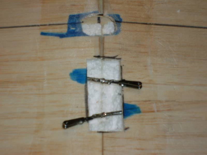

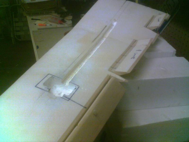

Well, I just couldnt wait any longer. I had to get started on my B-25 this weekend. I didnt like the way they had the control horns fitted in the flaps & ailerons, or the flap cables coming out the bottom wing sheeting. So I made the cables run along the upper side of the wing & I epoxied the horns into the flaps with the horns end exiting the leading edge of the flap, so as to help hide them. I also boxed in, & then cut out the flaps & ailerons before sheeting the wing. I have never had good results cutting them out after sheeting.
ID:	662103   Click image for larger version
