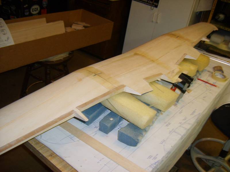

Old 01-15-2007 | 09:59 PM
Fili's Avatar
Posts: 759
Received 24 Likes on 22 Posts
From: Queensbury, NY
Default RE: Wing Mfg B25 Build
I used the 3M styrofoam spray glue to sheet the wings. This past weekend I was able to mount the aileron servos to the hatches, put the fiberglass wrapping around the outboard wing panesl, and join the wing halves together as well. I was also able to watch the Bears win!

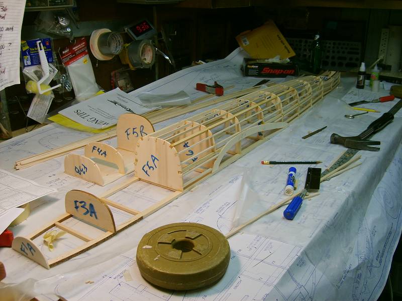

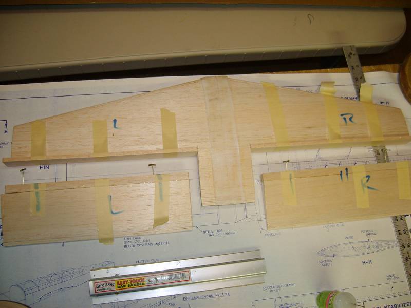

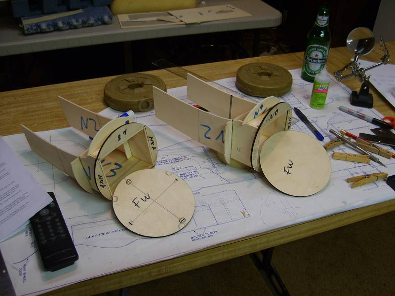

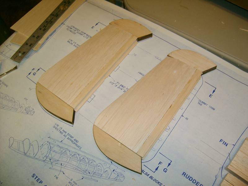

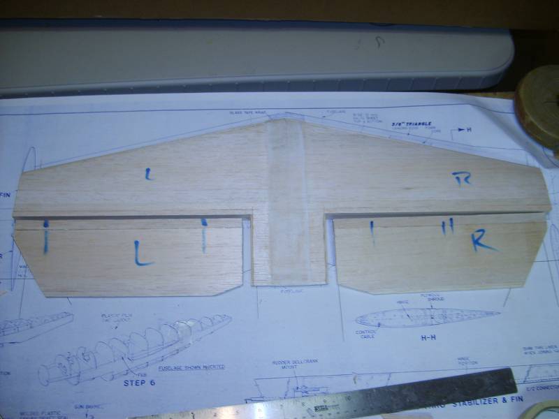

Took the day off from work. "A day in the work shop is better than a day at work"......Right? Anyhoo, made some progress on the tail feathers, and started on one of the nacelles. MY puter is only allowing me to upload one pic at a time, so I'll post a few tonight.

Old 01-25-2007 | 11:00 PM
Fili's Avatar
Posts: 759
Started the nacelles, got the majority of the tail feathers done. Lots of sanding and planking to do....

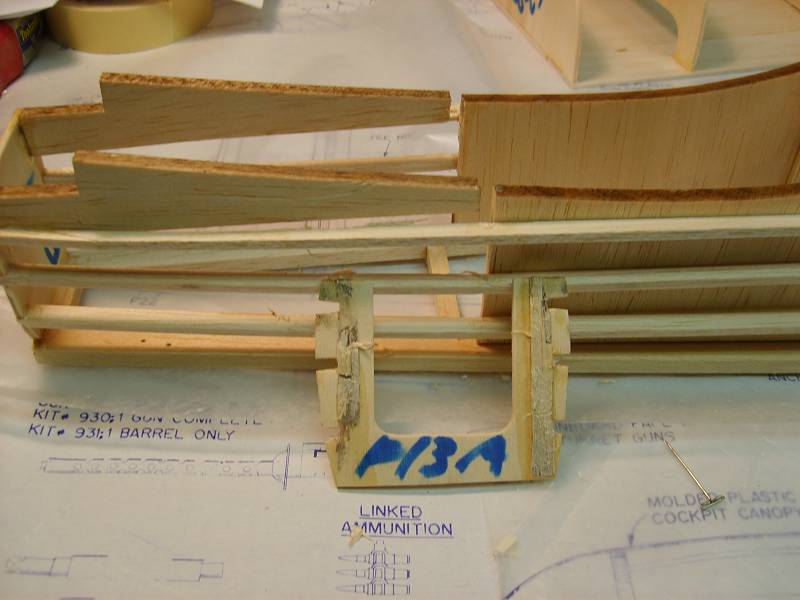

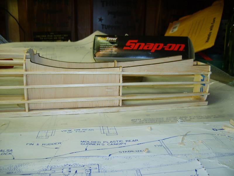

Old 01-31-2007 | 11:01 PM
Fili's Avatar
Posts: 759

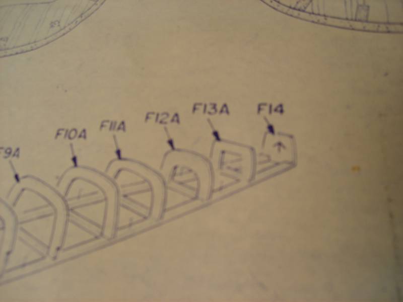

Do you Have a Dodge Viper in the driveway too!?!?............Me neither. Anyhoo, keep an eye on the little things on this kit. I'm starting to get a headache. The latest is the non-reversal of a former in the tail of the fuse.The plans clearly show the F13A former in a "n" position as are the other formers. When installed per the plans, the coutour of the stringers and the outside of the formers do not align. So I had to dig the former out and re-install it...........[:@]

Old 01-31-2007 | 11:18 PM
Fili's Avatar
Posts: 759
Out and in....[:@]

Old 02-03-2007 | 02:03 PM
Fili's Avatar
Posts: 759
ChuckI, I used the 3M sytrofoam adhesive. I simple sprayed both surfaces, waited a few seconds and put the two sides together. I then applied weight and then let sit for a while. I found the Dave Browns Southern Sorgham works much better (sorry 3M) and would recomend using that instead of the spray. I just feel better about the bond.
Meanwhile, apart from rebuilding the top of the tail sections, progress is slow, but sure.

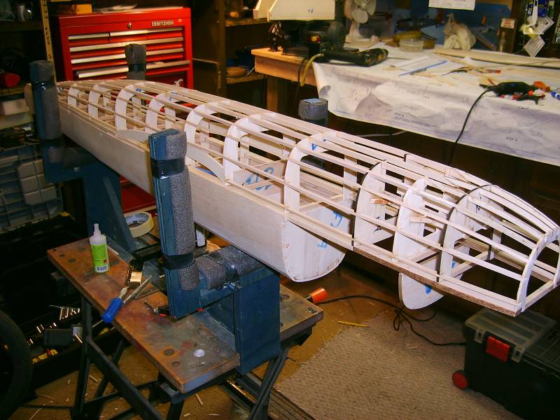

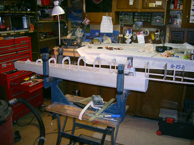

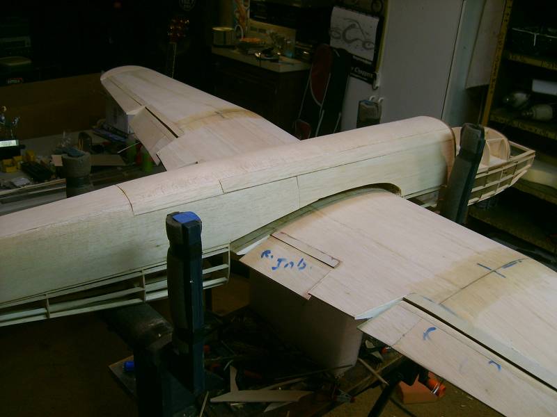

Old 02-14-2007 | 06:22 PM
Fili's Avatar
Posts: 759

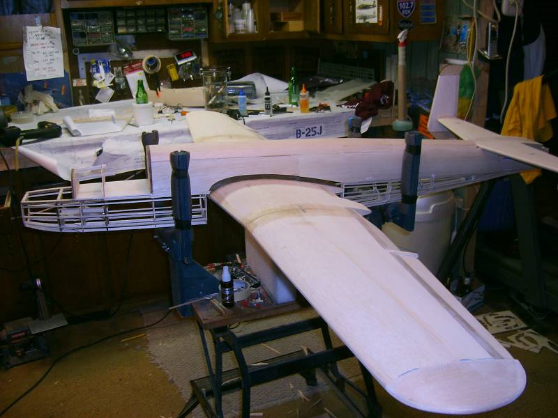

Upper fuse sheeted. Retract rails installed (Nose gear) Pushrods and antannae tube installed. Bout ready to sheet the lower fuse. Had the day off due to the blizzard.

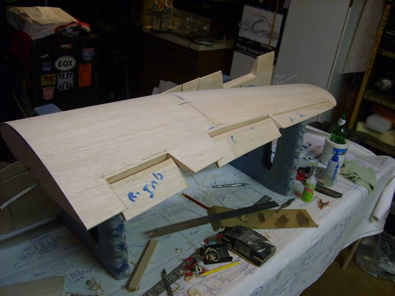

Old 02-14-2007 | 06:47 PM
Fili's Avatar
Posts: 759

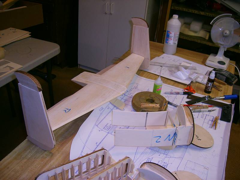

A few more stringers and I can begin sheeting.....

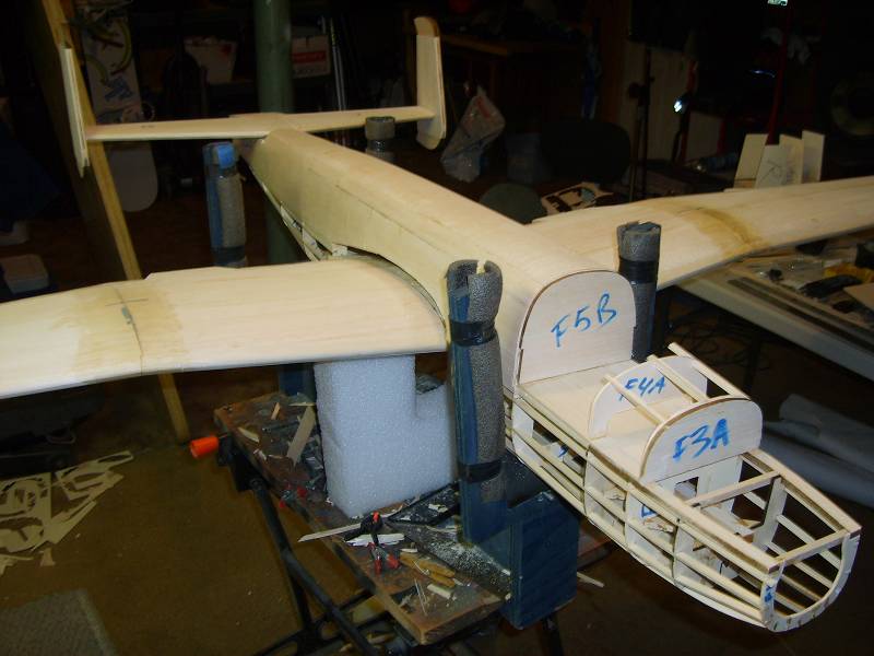

Old 02-14-2007 | 09:50 PM
Fili's Avatar
Posts: 759

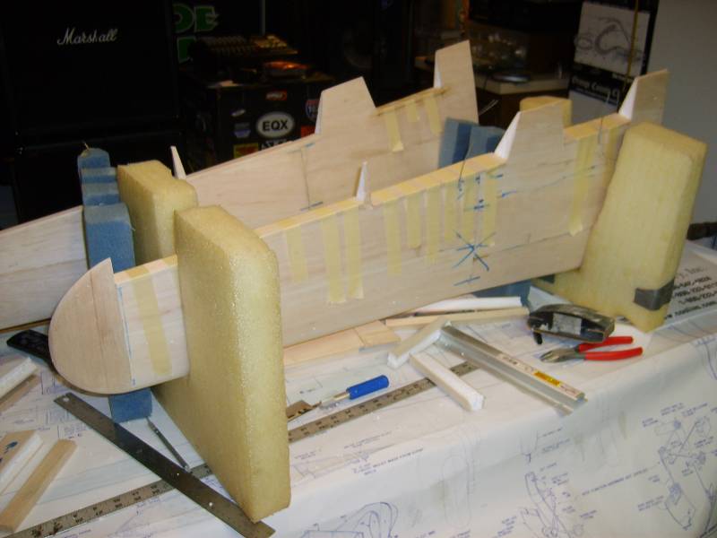

First mock-up.......couldnt wait

Old 02-14-2007 | 09:57 PM
Fili's Avatar
Posts: 759
nother more....
