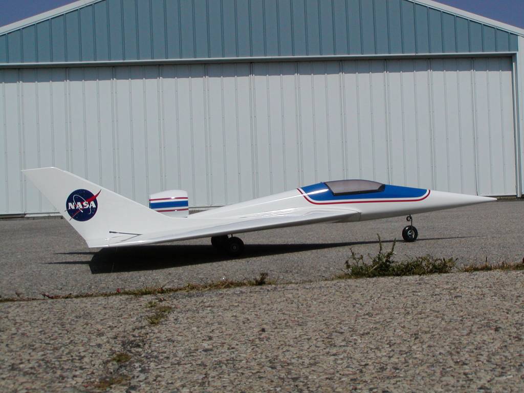

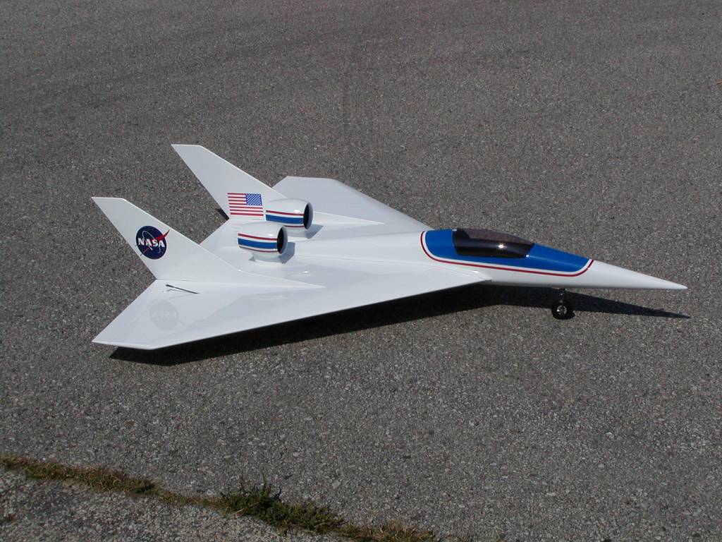

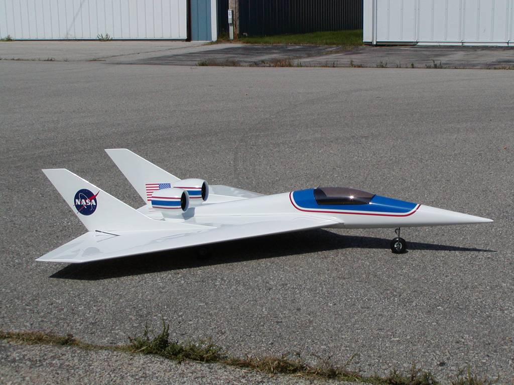

Posts: 100
From: Menominee, MI
2000redrocket
I saw your video, looks like it flies nice, and plenty of power. I built annother enforcer of wich I made lots of modifications, actually
the only part I used from the kit was the canopy. I wanted something a little differant, so I made new ribs with a thinner airfoil,
streamlined the fuse (made it narrower, and lower) and lengthend the fuse also, and raked back the fins for a more streamlined look.
I filled in the prop cut out, as I didn't need it for my choosen power supply, and went with elevons for the controls.I call it the Enforcinator. It came out to 6 lbs ready to fly, I hope it's as fast as it looks. I taxied it down the runway at the local airport, and it gets
up and scoots along pretty quick. Now I just have to get it to our club field, so I can give it a go.
I just finnished it befor the weather got cold, so I haven't had a chance to fly it yet, but spring is only a couple months away, I can't
wait to try it out. It seems to have plenty of power, and the sound of the motors running is way too cool. Here's a few pictures enjoy.
Ralph V

Posts: 100
From: Menominee, MI
I'm using two 75mm ducted fan units with brushless motors. The wing is about half the thickness of the stock wing, I just bairly had
room for the servos. When I spool up the motors it sounds like a real jet turbine engine.
Ralph V
