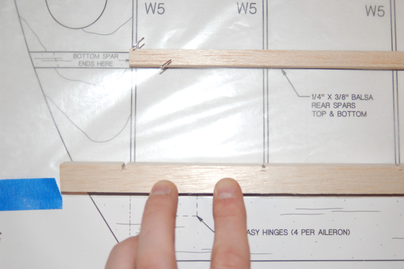

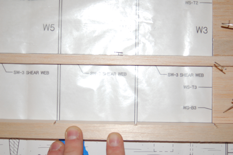

I just starting building an LT-40 for my father's birthday coming up. I came to a problem at the beginning of the build. When I went to line up the trailing edge with the ribs marked on the plan, the slots are off. I took pictures to show you all what I mean. I line them up by the sheeting I just glued in, and then the spacing gets progressively worse as I get to the wing tip. I'm really hoping it's something simple that I'm overlooking...
I reread the note by this section in the instructions, and also tried to flatten my plans out, and there's still some gap. So... that last notch is still over hanging the last rib placement... where do I go from here?

Not too bad...I would make sure I built the ribs as perpendicular, square and parrallel as possible. The spacing will only be a problem at the tip end. There you can either renotch the trailing edge - probably my choice- or you can put the rib in the current notch and put in a little piece to fill the space at the ends of the other spars. It is not uncommon for plans to shrink occasionally, sometimes unevenly. The other thing I would check is to place the other trailinng edge over the one you have on the plans as best you can and 'eyball' the position of the notchs on that one. Then go for the best symmetry that you can. Good luck, let us know what you do. 1 other real minor tip. When I pin wood down, I push the pins into the board on the opposite angle, so the pins hold down the top edge of the wood. Have fun! Doc

I ran into this to on mine. What I did was make sure each leading edge were thesame that the slots were cut the same. On mine they were so I just placed the ribs to match the leading edge. Instead of a 70 in wing I ended up with a 70 1/4 in.
My plans were right on in the center section of the wing. Just the last few ribs were off, and they were off the same way on both wings, so I just let the leading edge be my rib spacing guide towards the wing tips, work fine and no extra cuyying.

There is a warning printed out in the instruction manual that says the slots in the trailing edge are correct because the plans can shrink or expand. Read through my build to see how to deal with it.
Note: It is possible for plan paper to shrink or expand slightly with humidity changes. If it has, this is where you will notice it! You may find that the rib notches in the trailing edge do no exactly match the rib location on the plan. Nonetheless, they should be very close, not off by more than the thickness of a rib. A slight difference is nothing to worry about! The machine-cut notches in the trailing edge are correct, and you should build your wing according to them. To install a wing rib in the steps coming up, simply put the rear end of the rib in the notch, and then align the rest of the rib parallel with the rib lines on the plans. Do not alter the notches in the trailing edge!

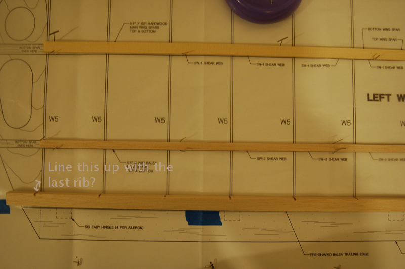

Thanks for the replys. I'm still confused though. Should I line up the last notch with the rib at the wingtip, and then build from that? And RCKen, your thread is the reason why I bought this plane. I figured it would be a quick, easy build with all the information you have given us. I saw your post about this, but maybe I didn't read through it too well, because I was still confused when I got to this direction.

Actually, that might just be the way to go. Do as you suggested and line the slots in the TE (trailing edge) with the ribs on the plan. If they all ribs on the plan line up with the slots in the TE then you should be ok. Just make sure the the ends of the TE stock are ok on both ends. You can cut off any excess that you may have. But if the stock is too short on either end then you can't do it like that.

Ok, that's the way I did. It's looking good so far. Even though there is that amazing build thread already for this plane, I think I may start one of my own just for my sake... maybe people will tell me what I'm doing wrong and how to fix it! I'm going to get a little further along in the build before I start posting pictures though.

I ran into similar issues. I left the lower spars, and TE a bit long. I used the TE for spacing the ribs. Once the final rib was in place, I cut the lower spars to length. Then after adding the wing tip piece, I cut the TE and LE.
Remember, you can always cut it shorter, but you can stretch it longer...
