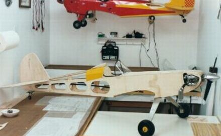

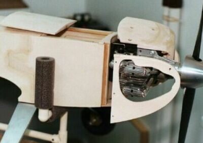

Here is what I did in mounting a Saito 150. (I did some searching for the fiberglass cowl...but didn't follow through). I cut off the right cheek and rigged an attachment rail. (I did not add the tripler on that side). I made a cardboard mock up and cut out for the engine. The front of the cheeks are tied together with a 4-40 threaded rod and nylok nuts. Then a cowl top was mounted between the cheeks and attached with 2 screws to the side of the motor mount. (which is on it's side). With the G23 you probably would not have a top piece work. Don't know??
I don't know if the G23 will adapt to this without cutting a portion out of the LEFT cheek too ... (but NOT making it removeable to keep it more sturdy).
I know this is not a perfect looking situation. I WAS pleasantly surprised after covering though. I will have some pictures as soon as this winter junk ends!!!!
I also got a 3/16" thick LG from TnT. The 1/8" piece in the kit is too weak for my type of landings!!
..(I also had them make it 1" taller).
I used the back 1/3 of the canopy for a WINDSHIELD and make an open cockpit with head rest. I rounded the tail surfaces and added 1/2" to rudder for lost surface in rounding. They suggest not to make a tank hatch...... I didn't listen!!
.. I put on Cub wheels and will paint the hub caps and LG to match the covering. Since this photo, I have purchase a Saito flex exaust and ran it around the fuse and pointed the end straight back between the LG.
Come on Springtime!!!!!
lownslo.........Bob

I am using a RCS 140 on my 4*120& cut off both cheeks, will make wood cowl after flying a bit. Installed the servos up side down in rear of fuse with hatch for acess. Also have a hatch in side of fuse for battery and receiver, and one more hatch under the front of the fuse for motor batt & ignition. A neat mod to the canopy I have seen is to install backward and cut down to get rid of the big bulge, and look more modern. I also built wing flat and sheeted across where joined for more strength. Mine came out at 11 1/4 pound dry weight with all batteries installed. Oh I did add 1" to the rudder because it looks good.
