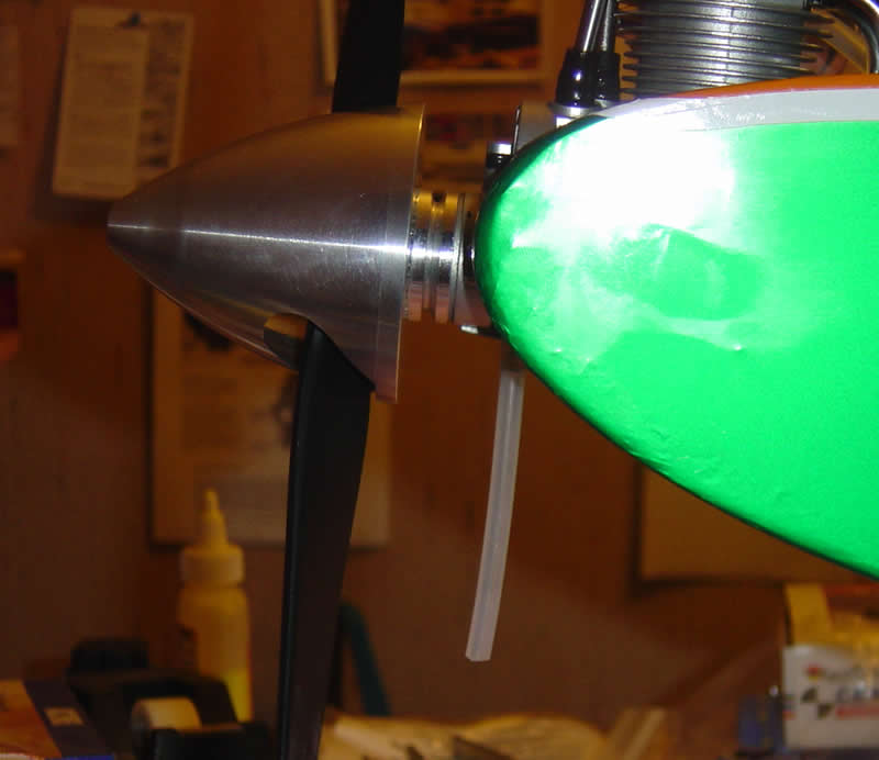

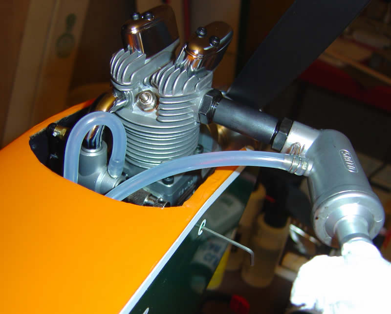

Ahhhh, balance in life is just as important as a balanced plane. The Great Planes CG machine works great. The CG is at the aft end of the CG range (about 4 inches from the leading edge). I didn't move the battery under the fuel tank, but I have that option if I need to move the CG forward a little.
I also purchased a Great Planes AccuThrow machine and it worked very well also. I adjusted the trim on the elevator by turning the clevis several times and moved the push rod to the outer most hole on the elevator servo. Moving it one hole sure does increase the throw quite a lot, so I was able to move the clevis to the middle of the control horn.
One question: the manual suggests that the aileron should move 1/2 inch up and 7/16 down. It's a very small difference and mine are pretty close, but how would one go about changing the throw of only one direction of a control surface? I also read that reducing the down aileron throw more can help reduce drag on turns and rolls. So if I wanted to reduce the down throw to perhaps 1/4 of an inch and still keep the 1/2 inch up throw, how can I do this? It seems to me that if I change the down, the up will be forced to change as well.
PS
You may see in the picture a can of Pledge. This stuff works amazingly well to clean, shine and remove small scratches on Monokote and canopies. It even shined up my wheels pants.

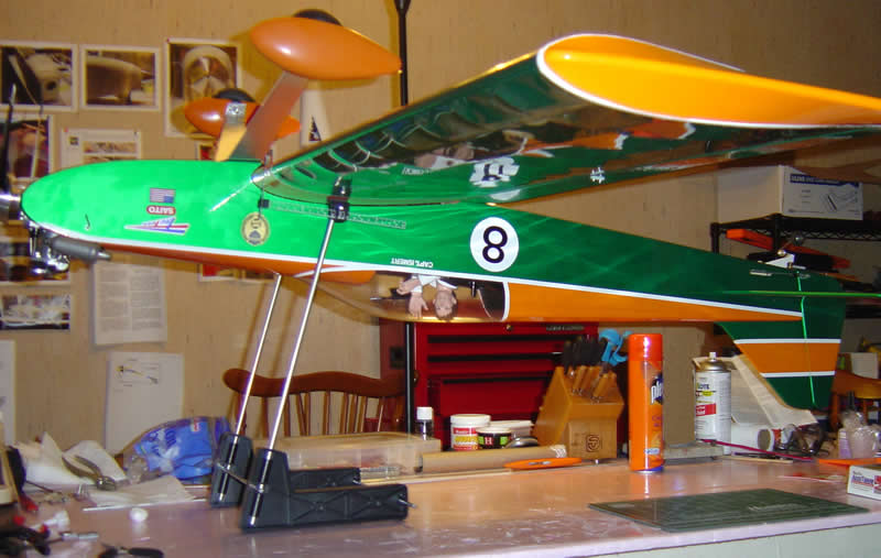

Your plane looks tail heavy in that photo.
In the old days, there was a mechanical method to create differential aileron throw. Today with computer radios, it is a matter of programming the radio to adjust travel settings. Which type radio are you using?
Old 06-06-2007 | 10:57 AM
  #53
foosball_movie's Avatar
Joined: Jan 2007
Posts: 432
From: Denton, TX
Default RE: Venture 60 - First build
I basically balanced it so the tail would rise off the table. Which part of the plane should be completely level (ie perfectly parallel with the ground)? The CG machine came with a small bubble-type level device, but which part of the plane should it be placed? Near the tail? At the recommended CG point?
[link=http://www.rcuniverse.com/product_guide/transmitterprofile.cfm?transmitter_id=28]Here's my Futaba model[/link]
It's not computerized. Pretty basic.

Foos,
I have to agree with Kmot, your plane looks a little tail heavy to me as well. Try putting the bubble level on the horizontal stab when you balance it. With regards to your differential aileron comment, you are right. There isn't alot of difference in the amount of throw. I wouldn't worry about using differential aileron on the plane. Besides, you would have to move your linkages to accomplish it since your radio is not a computer radio.
Fly safe and have fun!!

The wing centerline should be parallel with the table top. Your fuel tank should be empty also.
Once you get it balanced upside down, just do a quick double check with it right side up. In both cases, you want the nose of the plane to be slightly heavy as opposed to the tail of the plane. Level is perfect.

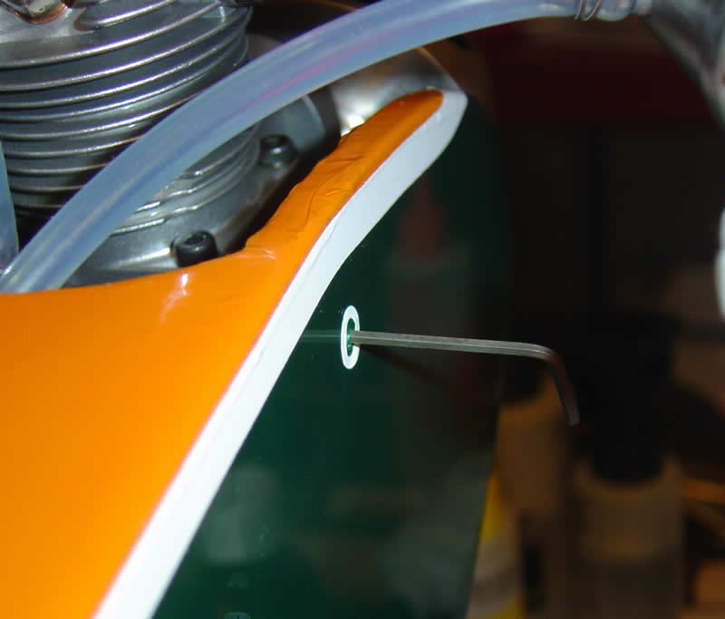

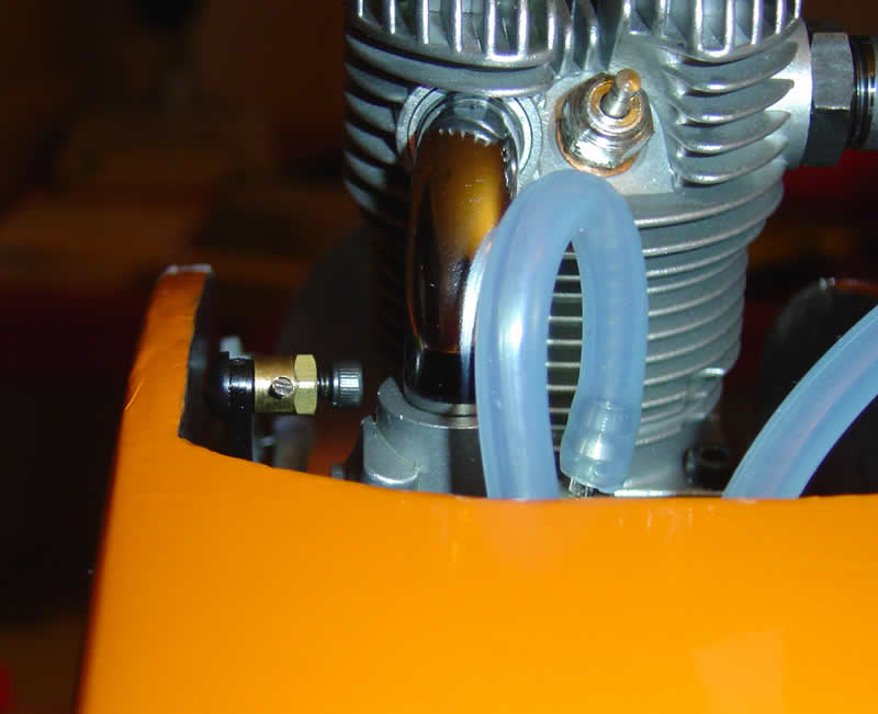

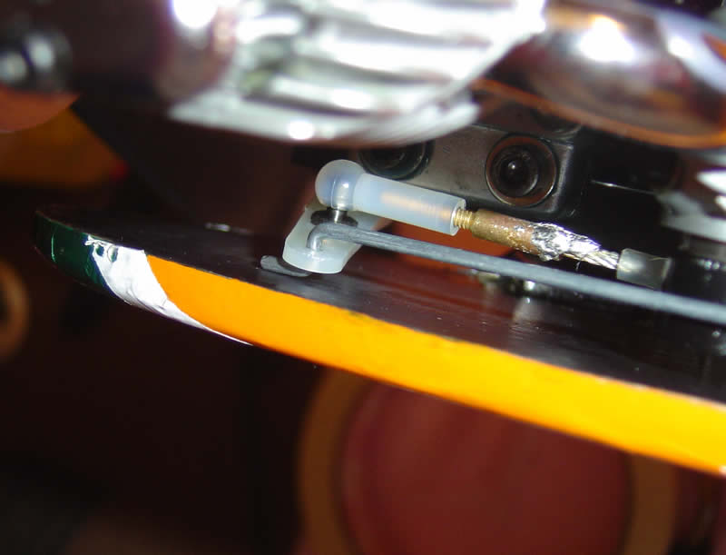

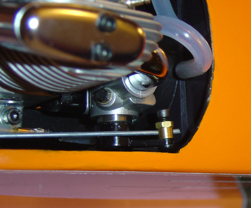

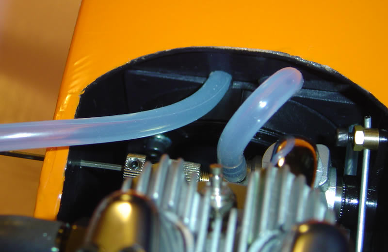

I had a request to post some close-up images of how I set up the throttle linkage and fuel lines. As you can see, there is no wiggle room with the Dubro 4-Stroke Throttle Linkage. I wanted to put a Sullivan fuel filter [link=http://www2.towerhobbies.com/cgi-bin/wti0001p?&I=LXFU76&P=7]here[/link] on the fuel line going to the carb, but I didn't want the fuel line to stick up an additional 3 inches.

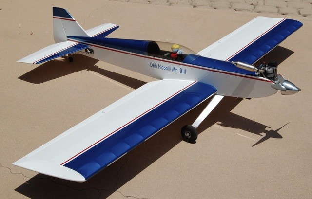

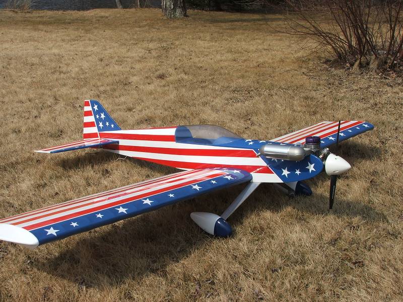

Here is my Venture 60 I’ve been flying sense the first of the year. I sheeted the turtle deck, servos for each aileron, the servos for the rudder and elevator are in the rear and a Mr. Bill doll for a pilot. It’s powered by a OS 91 FS with on board glow igniter. With the batteries as far forward under the fuel tank I still had to add 4OZ to the nose. I guess I added too much weight with the servos in the rear.
Bill

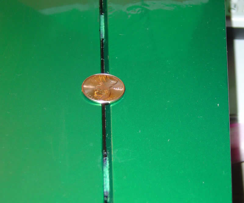

I flew this weekend, both Saturday and Sunday. The screw that held on the Saito muffler came off on my first flight Saturday, but another pilot happened to have an extra nut that fit perfectly. At another point the Tru Turn screw that held on the spinner came loose, but luckily didn't came off in the air.
She flew much better I thought since I added the 5 oz to the nose. I thought it was still a tad squirrelly for my tastes, so I moved the battery all the way to the fire wall under the fuel tank. It did move the CG forward a little, so I'm looking forward to taking her up again.
I flew her much harder Sunday. I was finally comfortable that my workmanship was holding up, so I felt more confident doing loops, rolls and flying inverted. She lands incredibly easy. I great upgrade from my trainer. I love how she takes off when that tail wheel comes off the ground compared to a trik-type landing gear.
I was able to get some video. It's not great, but it's proof she flies.

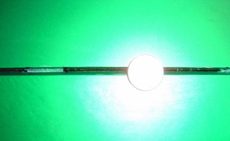

And just one more thing. I'm a little worried about the gaps in some of my control surfaces. (see pics). That's a penny to give some scale. I used a Easy Hinge machine to cut the slots and pushed the surfaces together as closely as I could, but the gap remained. The gap is about half the thickness of a dime.
Should I cover the gap with monokote? Or should this be ok to fly with? I didn't hear any flutter over the weekend.

Sealing with monocote is a good way to go. I seal the hinges on all my planes using Ultracote. Use an iron to secure in the grooves and then shave off the excess with a razor.
Regarding the hinge cutter, I have the Great Planes slot cutter and I cut the slot using a guide and then remove the guide and insert the cutter again which cuts the slot about 1/8" deeper without the guide in the way. CA hinges seat fully.
