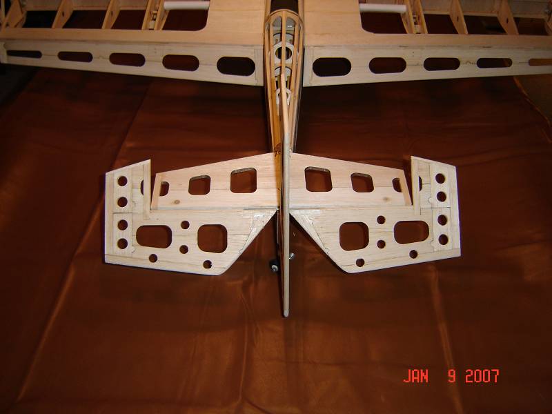

If you look in my profile you'll see a SE that I had for 3 or 4 years... note the word "had"... It had an unfortunate encounter with gravity this past summer that we won't talk about right now.
Some of the mods I did to that one consist of: Counterbalancing the rudder, pull pull cables on the rudder, aft mounting the elevator servo, Dubro main gear, Sullivan tail gear and adding a fuel tank hatch.
I've done all of the above to this one plus: Counterbalanced the elevators, added removable side force generators (an idea i got from loganjoel) & slightly larger main gear mounting plate... also cut a few extra lightening holes here and there.
I'll post additional pics after it's covered and the pilot is installed.
Bashing is so much FUN! Tell me what you think.

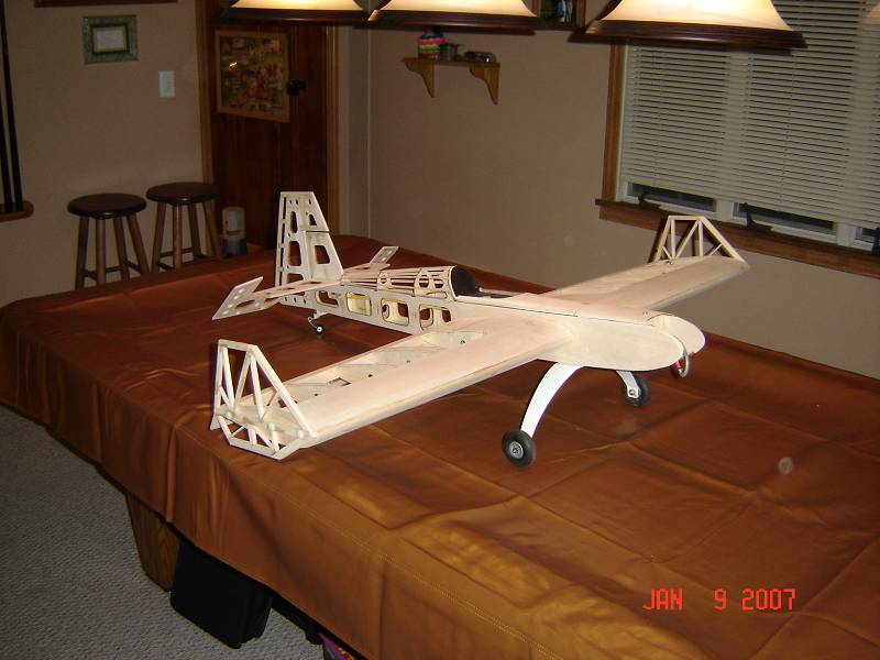

Another
[8D]
Here you can see the elevator servo mount.

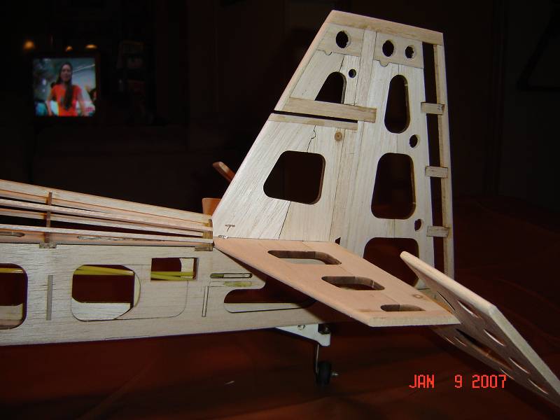

Oh yea... I also added an extra inch to the trailing edge of the rudder... my last SE only had the counter balanced (exactly like this one) and it knife edged pretty good... hopefully this one will do even better.

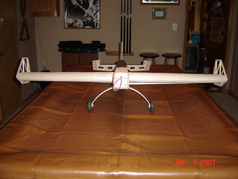

And one more.

Thats one seriously hot-rodded SSE- sweet!

Did your last SE have the side force generators like this one? I can't wait for your flight report. Especially on how it holds a knife edge. This really looks like a winner. Nice work.[sm=thumbs_up.gif]

Nope... no side force generators on the first one. It only had the counter balanced rudder with no other mods to the flying surfaces and it knife edged pretty darn good... so i've got high hopes for this one. loganjoel is doing similar mods to his too... we're planning on maidening both these birds on the same day... should be interesting.

OTE - how about a close-up of the side force generators? I'd like to study those a bit more. Any aero to them?

Nope... no aero to 'em... Thought about it but decided just to round the edges. Since they are removable I figure I can build other sets to try out in the future.

Got to thinking about the aero after I posted. It would be hard to do much more than just flat w/o favoring one edge over the other. So flat is best IMO.
Both planes look great. I like the shorter cockpit too. More like a single place competition plane.

Are you going to do any modifications to the wing retention method? The SFGs are going to try to remove the wing from the fuse during large yaw angles. I would also think the stock threaded hooks in the wing root are not up to the loads involved as well. Food for thought.....
I think the hooks are fine it's what you use to keeep the hooks together that may be the issue. I've always used a fresh rubber band looped around a couple of times but consider a zip tie.
I used 2 #64 bands tripled over on my last SE... but you pose a good thought. I guess if our wings rip off on the first knife edge pass we'll have to do something to "beef" that up. (sorry)
I think that a couple of #64s or a zip tie should be pretty good. I've pulled on the wings pretty hard to see if I could budge them on my last SE... they didn't offer to move. But... I'm still gonna think about your suggestion... maybe a hook with a deeper thread and CA'd in place might add some extra insurance. hmmm...
