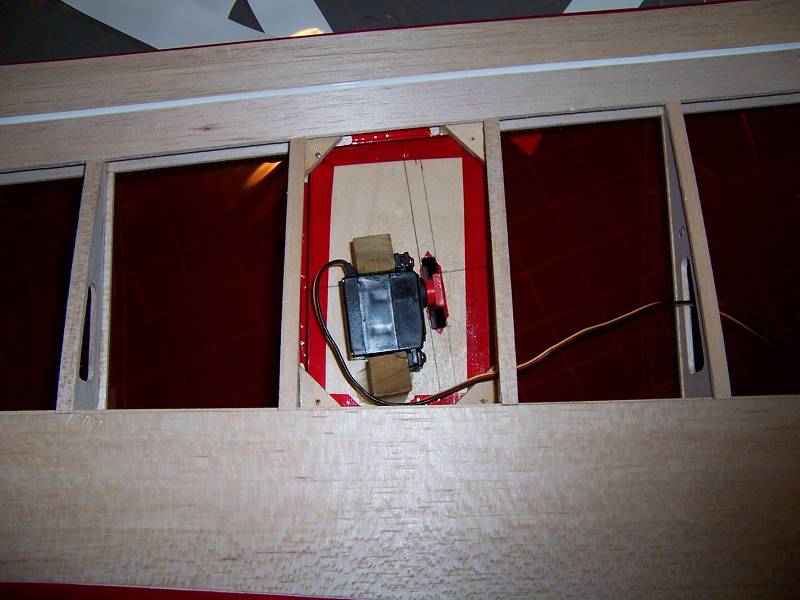

Before I started the modification on this model I started to think on how could I improve this kit, (even that by its self is a really good one), firstly I thought that the aileron servos was an imperative mod, because of the computer radio benefits, then I thought that the elevators could have a more precise movement splitting in two, placing them on the fuse sides and using mini servos, taking advance of the today’s technologies, Now you can have the same or more amount of power from this miniservos than the standard servos that are recommended for this particular plane. When I finished the building of the entire frame I was able to balance the plane placing the servos, batteries, engine, tank, etc. in the place that they should be, then I found that the rudder servo at the tail could make this plane tail heavy so I thought immediately on placing this servo inside with a nice pull pull system (Dubro 4-40). After those changes the plane balanced right at the spar of the wing. (Yes I am using a four stroke Saito 91 that helped me a lot for balancing)
The throttle servo could be a miniservo attached on the fuse wall in the cavity of the tank, this could take a little more effort to accomplish but there is enough room inside this plane to take advantage from, then you could install the pull pull system for elevators.
Tom I hope the picture is clear enough to respond the question you did before about the crossed cables on the pull pull system, I believe that this way it works better than straight cables.

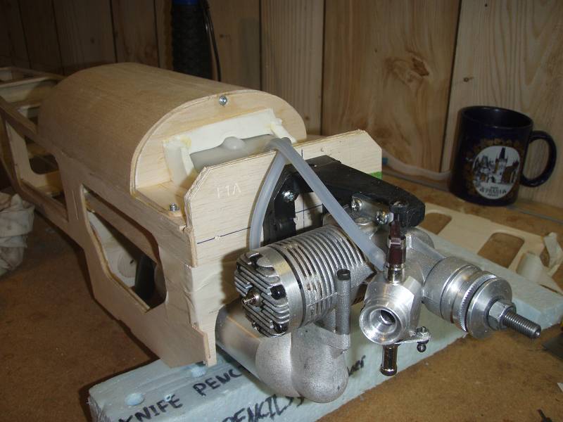

some more pics of engine/muffler/fuel tank mods. I should have some insane performance if the plane gets in under 5lbs with webra 50 and ultrathrust pipe.

First off, nice engine!
Is that muffler going to fit inside the cowl? I checked the stock muffler for my O.S. 46 fx , and it would work with a small amount of carving to the lower fire wall. but it will also need a good sized hole in the cowl for the front of the muffler. bummer
I may just go with a pitts style muffler.

yeah it will fit, a stock muffler that you have probably won't though as they have more height. The exhaust will come out behind the landing gear and air outlets will be the lightening holes around the LG area.

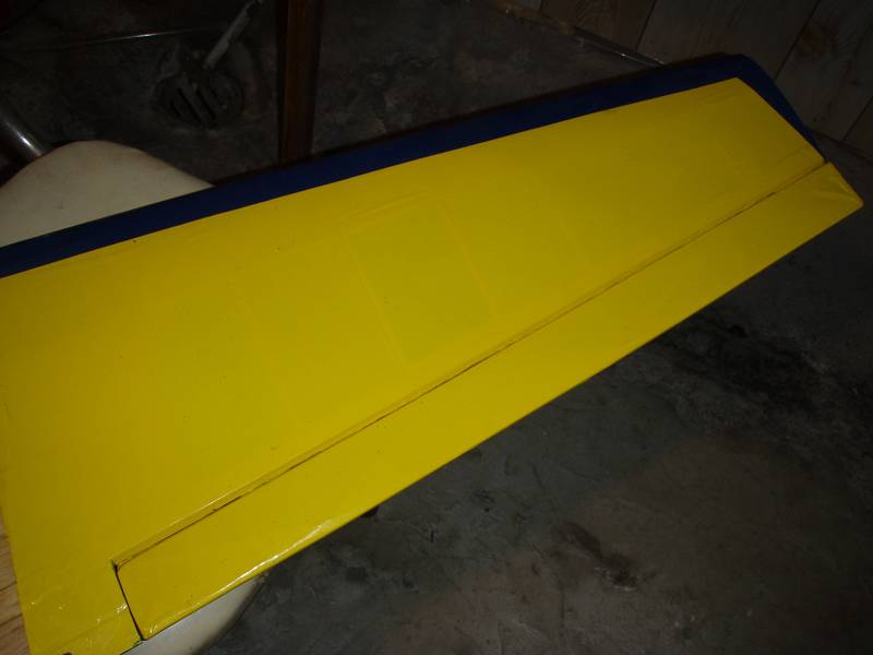

I started the wing covering and I will post some photos as soon as I take them.
I am very interested on the wings that Tom is about to build, especially on the larger ailerons I can not give this step back and I will stay with the current configuration but I must learn this anyway.
Thanks.

Heres my progress on the covering, and a pic of the instrument panel, unpainted.
I strengthened the landing gear with a piece of ply over the top of the 1/4 in. brace, almost forgot to do that before covering!
servos. He claimed to have a fast roll rate with the stock ailerons. I guess we will see for our selfs later on.

The stock roll rate is ok at speed, i enlarged the ailerons for better low speed handling. Im confused looking at the stablilizer, it looks like the elevator balances are glued onto the stab?[&:] The covering looks great, yellow and black is easy to see for sure.

I finished the wing panels, next steps are to join them and build in the centre section. I should have some pics up by the end of today. I moved the TE up an inch to accomodate the larger ailerons.

Here is the mostly finished wing, it sure goes together quickly the second time. Weight is 14.6 oz including servo which is pretty good. Should be 1 lb when covered and totally finished which is 5 oz lighter than my old wing. The larger ailerons are actually lighter than stock. With the torque rods i have about 45-50 degrees of throw. I also took out about 1/2 the dihedral.
That table barely fit down there, had about 1/4" clearance through the doors, but its awesome to work on, nice and flat and level.

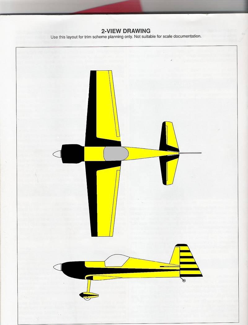

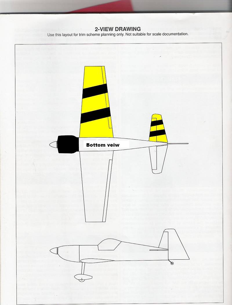

Rugerv45 I like the number 3 design.
