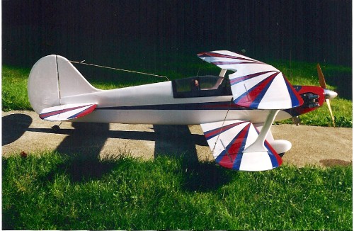

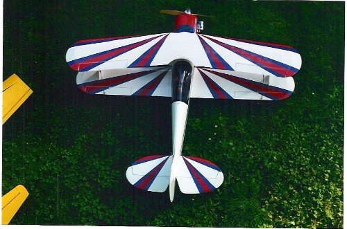

I am using a YS 91AC and it is great! I also have a TME Simple Smoke Pump on it. If you'd like to see some pics and videos, you can D/L them at:
http://204.96.183.34
And here's a pic
And here's a pic

Wow that does look sweet in the air!
I don't have a lot of cash to spend on the hobby, but have been slowly putting the pieces of this Skybolt together for about a year now. I don't have the $$ to buy a decent 4 stroke which I really wanted for this plane, so I am going try placing a GMS .76 2-stroke in. I tried to build it light, and am hoping this thing will at least pull it around the field. I'm not really into the whole aerobatic thing anyhow. I'm happy just doing a loop and maybe a few rolls while circling the field, and of course getting it back down in one piece.
I too am going with a pull-pull on the rudder, and separate left/fight elevator servos with a reverser, and the dual aileron servos.
Anyone else tried a smallish 2-stroke on this bird? I think mine will weigh in at just about 9.5 lbs.
I really have enjoyed building it and would like to see some pics and comments from others who have built this kit. Still have a few more months of snow before the flying season to finish mine up.

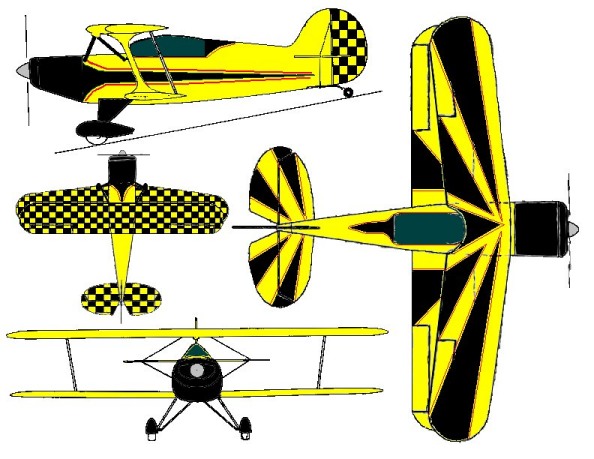

Oh, here is my color scheme. I might need some clues from you guys on how to apply the black sunburst trim. Ultracote over Ultracote? Covering is NOT my strong point.
Enjoy!
Enjoy!

MinnFlyer said it perfectly, the glide slope of the Skybolt is due to wing loading. A greater dihedral makes an airplane more stable, but also less aerobatic. If you build per the plan the dihedral is automatic. On mine that doesn't equate to much. I run a Saito 120 and it flies great. I flew it today in fact, I wanna go back! It's a real crowd pleaser. Whenever I bring it to the field everyone has to come over and check it out. One thing to note is it builds tail heavy. Even with the 120 I had to add about 8 oz. of lead to the nose of mine. Thats with the battery and receiver up against the firewall and the servos moved as far forward as I could move them and still be able to hook them up. I hope you enjoy this plane as much as I do mine. Good luck!

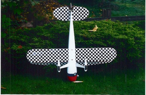

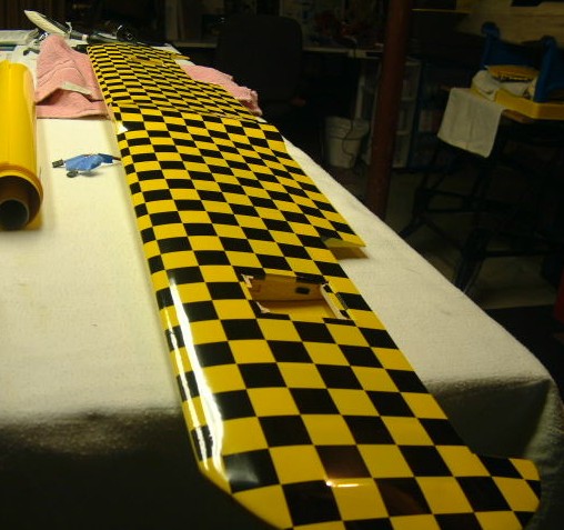

Thanks for the input. Actually I went the easy way with the checkers. I'm using Ultracote that is already 1" black/yellow check pattern. Stuff went on nicely. It is real pricey stuff though. What has me worried is the black sunburst trim I want to apply over the soild yellow. Both are Ultracote. Concerned with it bubbling and shrinking when I go to apply it on top of what I have shrunk down already.
Wings and tail pieces are covered. Just need to do the sunburst trims. Fuselage I guess is next. It looks kinda tough with the curves...

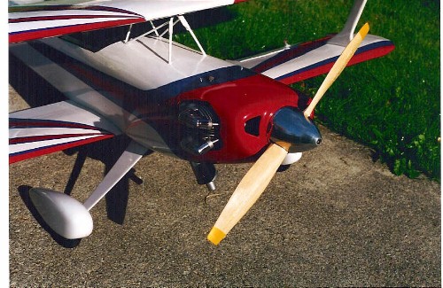

Does this plane require a hole for hot air to escape the cowl. I see that no one is cutting a hole in the bottom of the cowl. I will have an OS 1.20 in mine so the head will stick part way out. Is that enough or should I put one in the bottom too?

For the black sunburst, poke the yellow area to be covered with thousands of holes to let the air out. Since your scheme has so much black over the yellow, you could even cut large sections of the yellow out. Just leave about 1/2 - 3/4" of overlap and you should have no problem. In the plane pictures below, The white on each wing was put on in two seperate pieces, and the blue was added later with a 1/2" overlap.

I've only seen the checkered Ultracote offered in:
White/Black
Yellow/Black
White/Red
They have both 1/2" squares, and 1" squares. I think the white/red even comes in 2" squares. It goes on really well, but as I mentioned above it is quite expensive. I think it was somewhere around $22 for 6'6" x 24" roll!

Not sure on the cowl question. I have the two "nostrels" in the front cut out, along with a small rectangle in the nose center. The head of the 2-stroke just pokes out the side at 90 degrees, and I have about an 1/4" space around where my pitts style muffler hangs out the underside of the cowl. I'm hoping that airflow will not be an issue. Of course we don't get many HOT days up here in Maine like you have in AZ.
