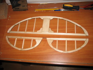

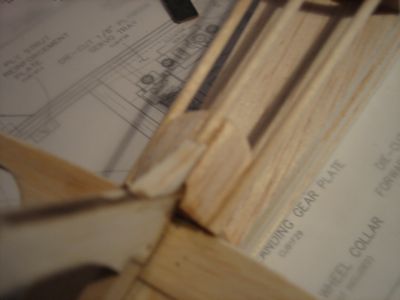

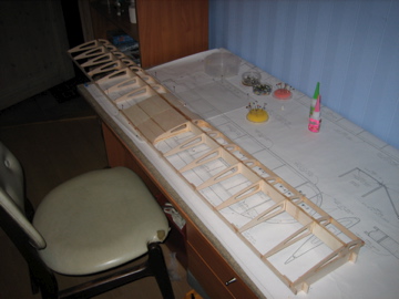

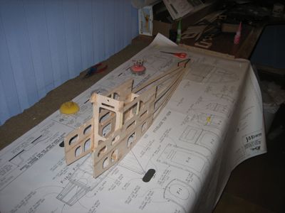

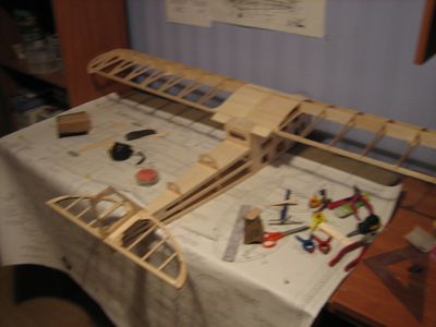

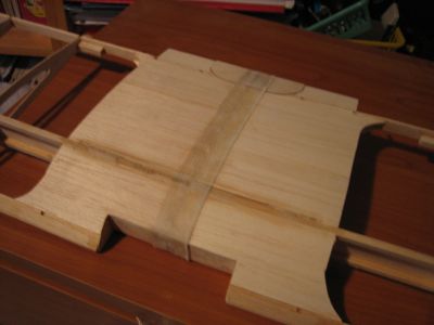

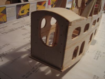

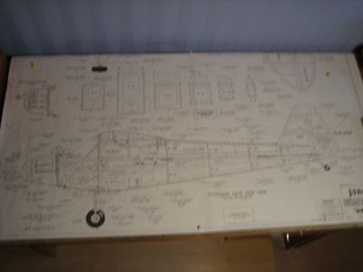

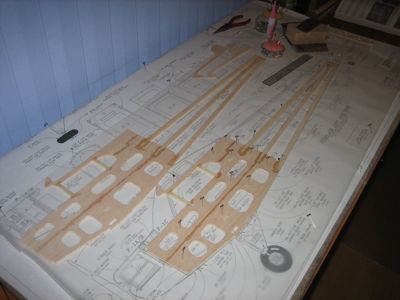

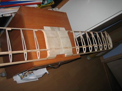

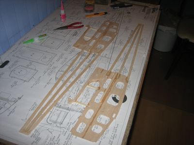

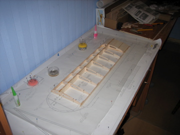

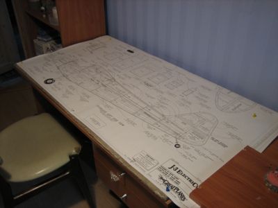

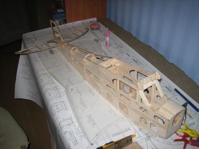

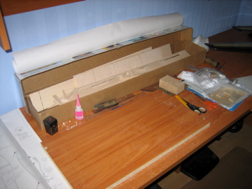

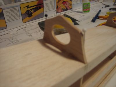

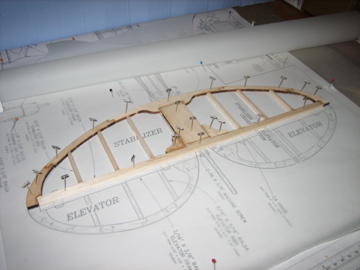

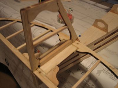

My current project is a Great Planes Electic Cub Kit, an I would like to share some photos with you, hoping for some feedback on my progress. Any hints/tips along the way would be great.
While the kit suggests a brushed geared engine and NiCad batteries (its an old kit), I would like to go brushless/Li-Po, and I was wondering if anyone have a suggestion on what kind of engine (how powerfull) I need to get this thing flying. Im not looking for extreme performance, but enough power to pull get me out of dangerous situations.
Here are some pictures. I got plenty of building time now as the summer holiday is not over yet. I got the kit just a few days ago, and already im done with the tail feathers and 90% done with the wing.

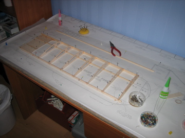

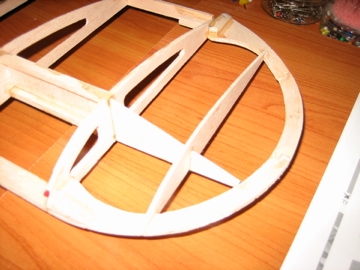

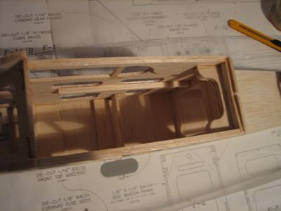

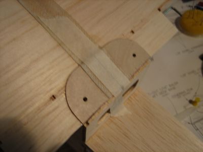

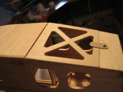

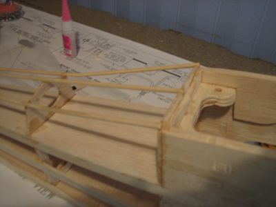

Some more pictures

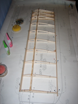

Hi

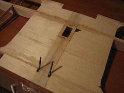

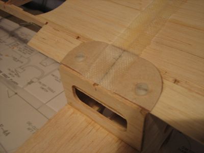

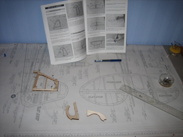

Forgot to update this post for a while. The Cub is coming along nicely. But the summer vacation is over, so its back to work now. Im done with most of the woodwork, and started covering the tail feathers. Ive brought a Hyperion Z3019-12 brushless engine that I hope will do the trick, and later Im gonna buy a Hyperion 50amp controller and 3S Lipo in the 3200+ range. Need to find a way to mount the engine, though.

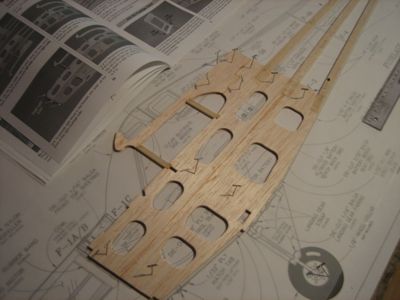

Some more
The cowling was damaged in the kit, and Im waiting for a replacement from my dealer. Cant seem to unbend it myself

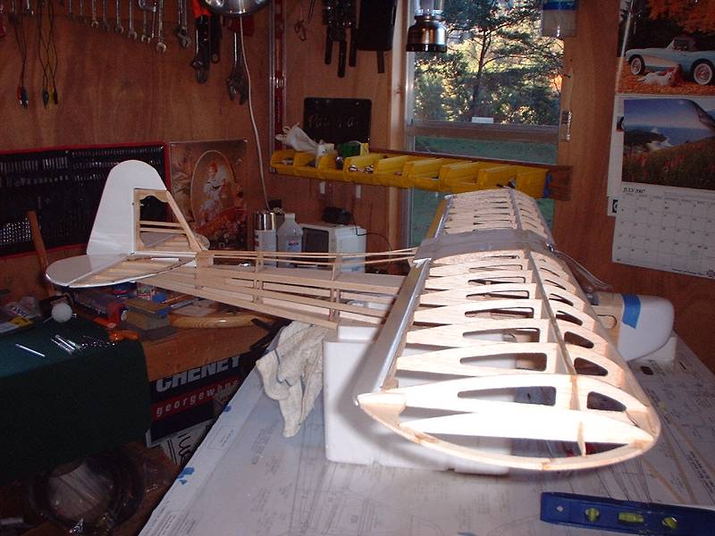

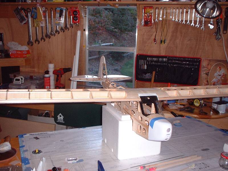

Hey, here is a ruff pic of mine ( unglued) lol.
Bob

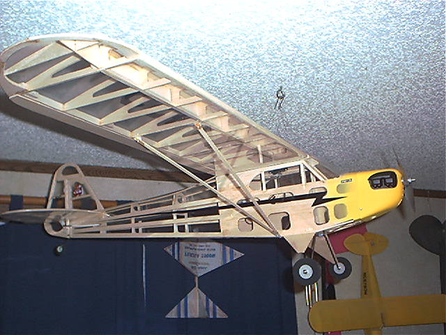

this is my GP elec Cub I covered it in clear and then painted the front yellow fading it out past the cowl. Flies great with a 7 cell 2200 MAH Nicad. I use a master airscrew 500 with a 2.5 to 1 gear on it. will soon be making it run on lipo. Only mod I did was the top of the turtle deck i cut a few holes in it to lighten it a little. It will ride a thermal [img][/img]

Sorry for the long wait. Havent had much time for the project this month, but got a few hours work today and yesterday. Here are some shots of the fuselage and the cool engine mount.
Almost done with the pushrods. Just need to make sure they can operate freely. Might have to shave off some balsa at one of the rear formers, as the elevator pushrod is rubbing against it, but otherwise it looks good. Gonna cover all tail feathers and glue their hinges so that I can properly test the pushrods, then Ill move on to covering the fuselage itself.
The wing is still not covered (I dont look forward to that job...not with the cubs round wing tips...[:'(] ).
Then I need to pick a ESC and battery pack. Im currently considering a Hyperion 50A ESC and a 3s lipo pack in the 3200mha range. No clue on the prop size yet. Anyone got any tips?
ID:	781777   Click image for larger version

I just covered the tail feathers and ailerons. Starting
the pushrods tomorrow,also putting off covering the
Wing lol. Need to order my Motor,Esc and lipo soon.
I've read somewhere that a 10x6 prop might be a choice?
Bob

How did you measure the Down thrust ?
TIA
Bob

brsseb
I'm slowly getting back to it after surgery, here's
a couple pics. I hope
Bob
ID:	787110   Click image for larger version

Good to hear you are feeling better. Your Cub looks good.
Ive gotten a few more hours work yesterday, the tail feathers are now covered and the hinges glued in place. Need to shave off some wood from the formers, the elevator and rudder links cant move freely yet.
I havent measured down thrust yet, Ill check the plans further and see if the prop is at the correct downward angle. If not, ill add abit of plywood under the two bottom engine mount screws to tilt it upwards abit.
When all this is done, ill cover the rest of the fuselage and the wing. Then its time to order ESC and battery.
Ill keep you posted on the progress.
