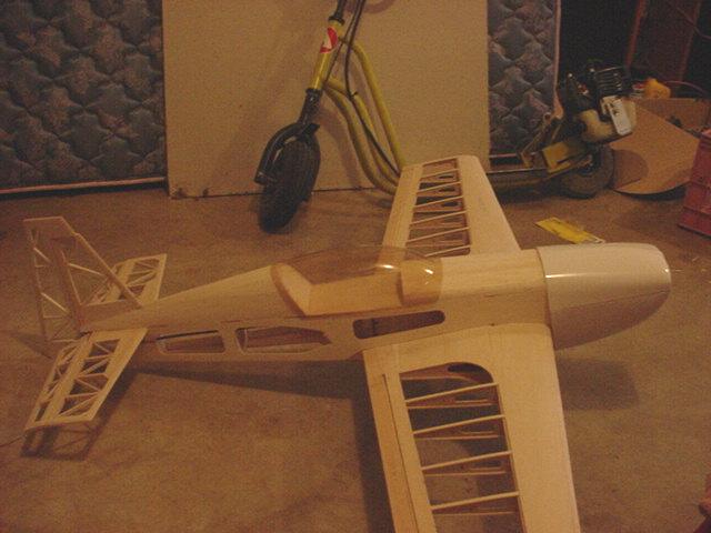

Well, i've got it pretty much all framed up. It's a miracle that i haven't destroyed it yet. I have not developed the cautious habits that i think are necessary for balsa modelling. I always find myself making quick movements reaching for a tool or something and knocking things around. If this plane gets airborne before i knock the tail off or step on it i'll be happily surprised, lol.
Now i'm waiting for my engine to come in and i need to order some covering supplies. Since this is my first covering job i need to get an iron. I think i'm going to get the trick Century 21 iron with the built in thermostat/temp control function. Sounds pretty handy. All the little things are really starting to add up costwise.
By the way, i think i somehow managed to actually build it straight! That's gotta say something for the kit! If i can build it, anyone can. The only part that really gave me much trouble was the wing mounting system. I didnt quite understand/couldnt quite visualize what was going on, untill it was nearly complete and i had messed it up just a little bit. I think they need more clear directions and more pictures for that part of the assembly. Otherwise it's great.

Hi MiL, Your plane is looking really good and in short order too, didn't take you long at all to get this far. Your about half-way I think. I told you the wing-mount would be a trip. When it's done it comes together nicely though.
21st century is the best iron out in my opinion, I would bet in most everyones opinion.
For the cowling, if your going to use the ABSplastic, there's putty that called "squadrons". You can get it at your LHS. It comes in white and green, obviously you want white. It will totally work for the seams, and you will never know they were there. I sure hope your cowl lasts longer then my first plastic did. StansFiberTech's is about $55 or so for the cowling and wheel pants. If your not going with a big motor, you will get alot more out of your cowl then I did.
It is a nice kit, and well thought out. I'm not sure if your aware, it was designed by Mike Cross, he is husband to AnnMarie Cross that helps us out in most radio forum, and she is product support manager for GreatPlanes. They both also designed the 33% Extra from GreatPlanes. I have my eye on that one. After I finish my Midwest 27%, just seem to want bigger these days.
Anyways,,,,,,,,Good Job man.....your well on your way to a very nice plane. Congratulations.

If you take a little time with your Extra, it comes out real nice (see attached pic), this pic is of the GP's .40 size Extra with an O.S. .70 FS in it, Stans cowl and pants, fuse was built up to allow for cowl and canopy to blend in smoothly, plane weighs 5.75 lbs. (did I mention that it also has scale tubular frame cockpit detail.

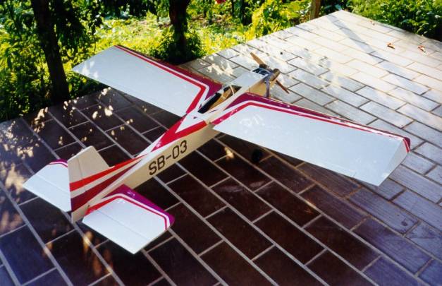

I don't know Tower engines, but I know Magnum, TT and Supertigre. My choice would be TT .46 PRO, which was my first choice for my Extra. Fortunatelly, I got almost new ASP.80 FS - I don't regret this at all...
I have a TT.46 PRO on my GP Easy Sport, and it's a hell of a performer. I hauls that 2.6kgs through the air with authority. Verticals are excellent, but after 150m from full-throttle level flight it goes out of breath.
ST .51 would be another one - extremely light, powerfull, but a gas (glow?) guzzler.
If you are thinking about some serious aerobatics, four stroke is the choice. It's beautifull to see your Extra make a 200m diameter looping - slow it goes up, slow it goes down. And about that vertical snaps... When going home, you just can't stop grinning...
Sašo
Sašo
