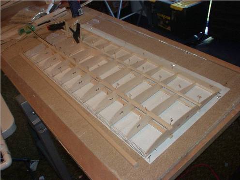

That was some quick responses. I have chosen the Sig kadet Sr. as my first build. Hear is where I am at this evening. I am trying to pace my self and not rush anything to fast.

Right now in that part of the build a set of small triangles are your best friend. Keep everything at 90 degrees and flat to the board and you are in good shape.

And some weights on top to hold it flat against the building bd. Dont trust the pins alone to do it.

You have wax paper or similar over the plan right? I can't tell from the pic.
The wood to wood contact as stated above is crucial, especialy in the wing joiner area. I have not built a kadet but I'm sure there is some sort of ply joiner between the panels. What I do is use the ply joiner during that end of the wing build for a dry fit as I'm building to be sure there's no daylight on top, bottom and end, all wood to wood contact securing with expoxy. I do the bottom first.. let it set up, turn the wing over.. then the top, let it set up, turn the wing on end and do the end of the joiner at the rib... little time consuming but the expoxy is not dripping all over and while it's setting up there are plenty of other things to work on.

KitBuilder
I am using Great planes plan protector. I wonder if regular poly from the lumberyard would be the same thing???

ORIGINAL: Pa-18cub150
KitBuilder
I just use was paper. Its cheap and already on hand.
