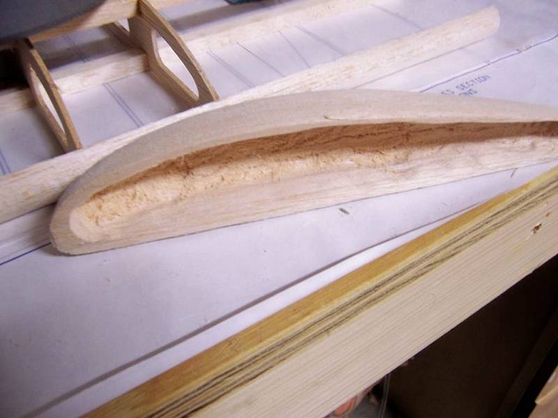

I am in the process of building a 40 size Telemaster from a kit. It will be gas powered.
I was getting ready to put the wing tips on and had a design inspiration. I really never liked how the undercambered sharp edged wing tips look on most trainers, the Telemaster included. So having an extra piece of triangle stock laying around I decided to experiment.
I basically built the tip upside down so the bottom of the tip matches the bottom of the wing and the top is faired to provide a nice curve down from the top of the wing.
I really like the way it looks but I'm afraid it may adversely affect the way the wing behaves. So before I do the same to the other half and maybe even to the horizontal stab, I was wondering if anyone has a strong opinion about what may happen to the airfoils behavior and performance.
I'll attach a picture as soon as I can.[/size]

IMO, that bottom bevel thing is more a covering aid to eliminate compound curves more than anything else.

Compound curves don't bother me. It's the overall change to the airfoil that concerns me. Any input?

ORIGINAL: nocrashing
My gut feeling tells me you could rough cut the wing tips with a dull chain saw and it wouldn't affect the flying characteristics of a Telemaster.
I wouldn't worry about it.

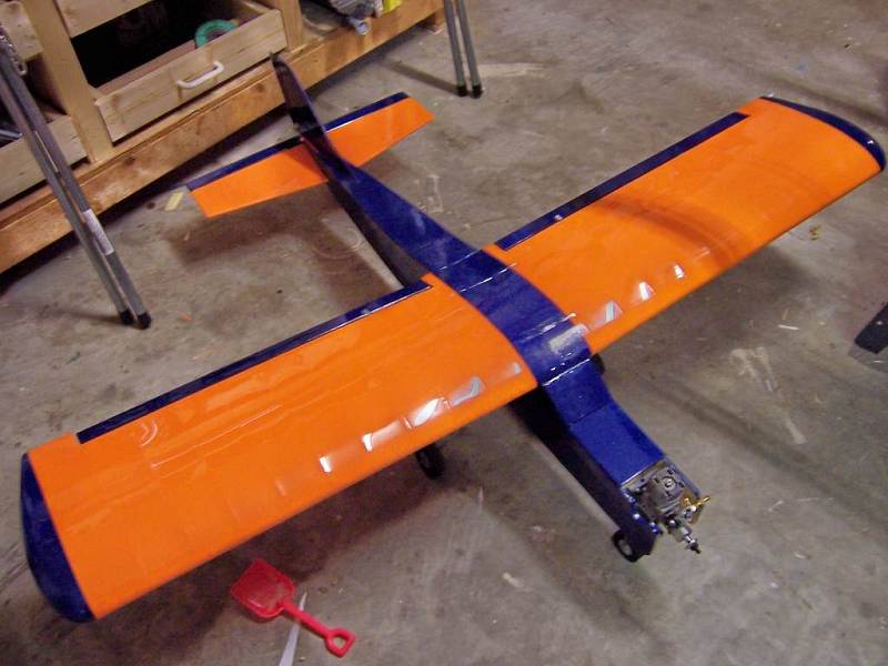

I add rounded wing tips from to all my planes... I think it looks nicer.. tear drop shape with the widest part at the spar location... I usually hollow them out so not to add the extra weight so far out on the tips.... never had any issues with performance.
Mike

I believe your modification will produce adverse roll (dutch roll) from rudder input, i.e., right rudder input will cause the left wing to lower instead of raise.

Go for it I did the same to my old Telemaster 40, may It RIP (student did it in). The mods didn't change a thing. The Telemaster is very forgiving to say the least.
As the 40 size flys well with a 40-46 size 2 stroke (had a 52 4 stroke on mine) what kind of gasser are you using, that might be something to consider as this plane does not require a lot of power.
