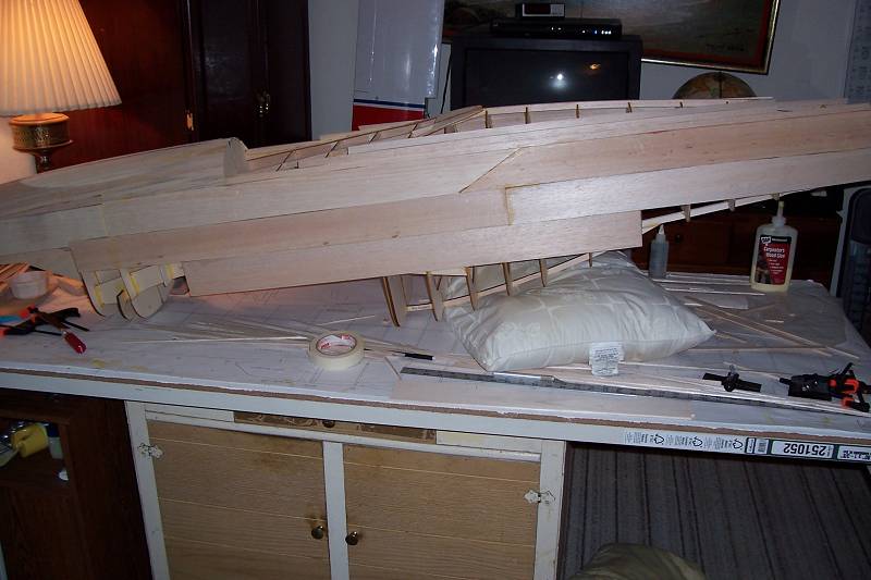

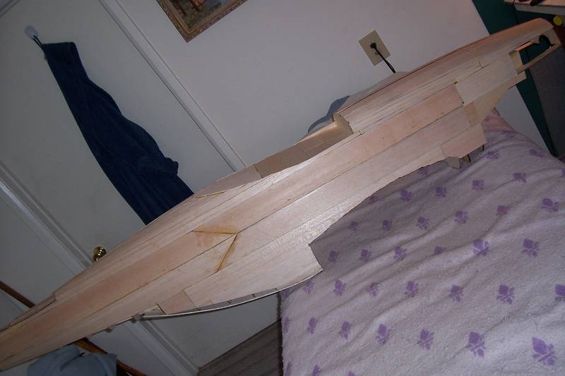

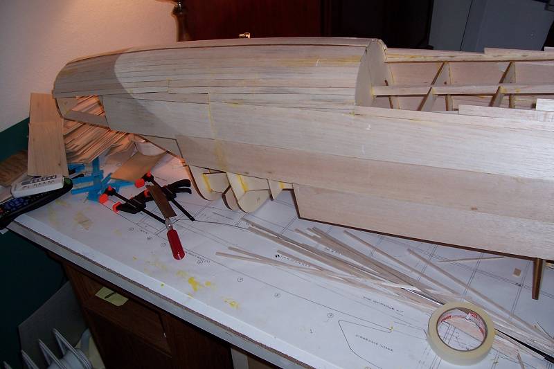

Well, it's beginning to look like a Mustang fuselage. Just a little minor sheeting left on the fuse. and I have the fin and rudder about half done. Next the stab and elevator. About 35 or 40 hours so far. I'm a happy camper! Am waiting for my hi torq servos to get here, so I can set up the tail installation.
Richard.
It's kinda BIG!!
Richard.
It's kinda BIG!!

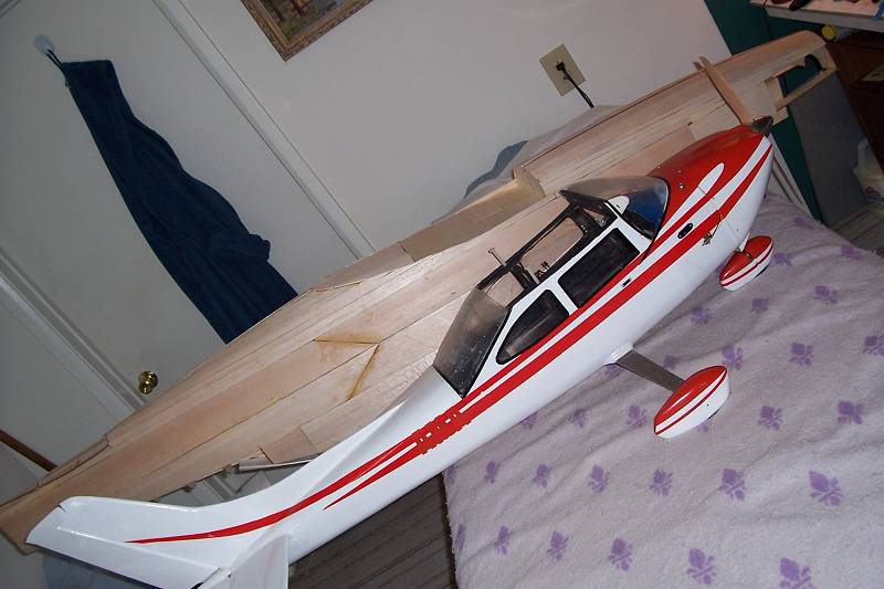

I have left the sheeting on some of the bottom for access to wireing and servos and attachments of tail feathers etc. It doesn't look like much since last pix, but the fin and rudder and filling the little places with strip planking/sheeting, has taken me about another twenty hours. Still haven't started on the stab and elv. Some times the smallest things!!!! But it's coming along.
My 83inch TopFlite Cessna 182 is for size reference again.
It doesn't show so much in the pix. but the Cessna looks like a toy beside the 51, when viewed live.
#40
RE: Don Smith P-51D
Hehe is doeslook like a toy and the fuse isnt even finished lol
But looking good, are you going to do a scale cockpit rich. would look nice
Thants one big rudder and fin lol, have you stated on the stab and elevator..
Still havent got mine yet, hoping this week .
So whats next for the build...
Lee [8D]

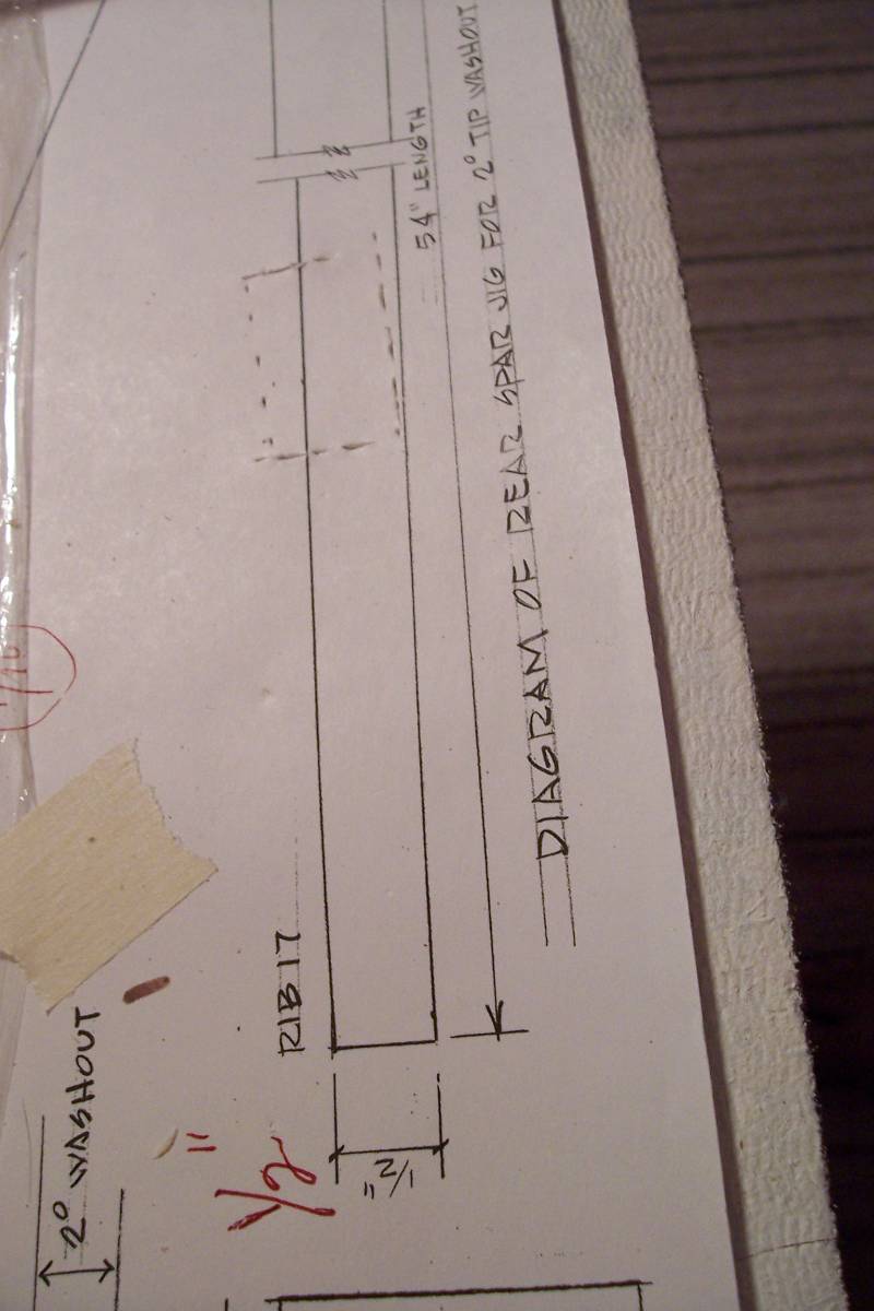

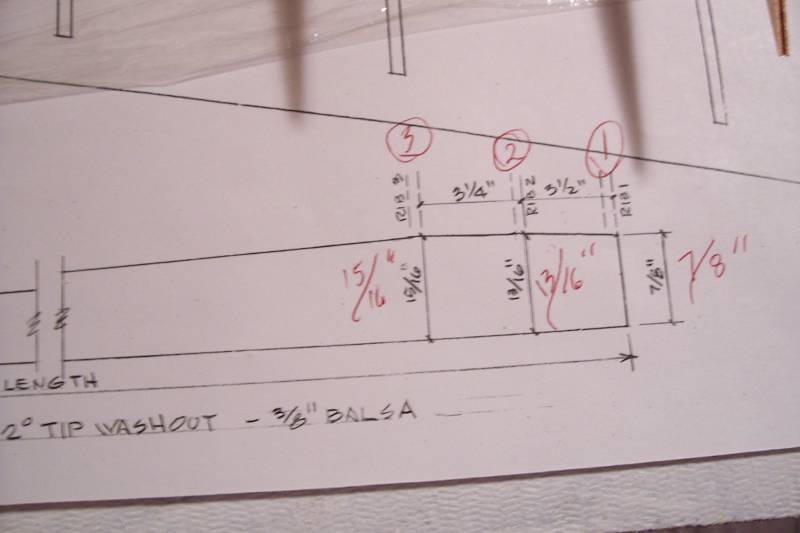

I wonder, would one of you guys take a look at your wing plan, and tell me just how the ail. LE. is suppose to be installed. The plan says to build and cover wing complete. Then cut out ail. and flaps. So if you do it that way, you would have to have the LE. cut into pieces to go between the ribs. If you install it while building, but are suppose to make it a one piece install, you have to cut out some of the ribs, and this is not indicated on the plan, or on the ribs. And at just what angle are you suppose to install the ail. LE? Do you notch it for the one eighth by one quarter front top spar, or does it go under that, and lean back toward the ail. spar?
Something has either been left out here, or I am missing something.

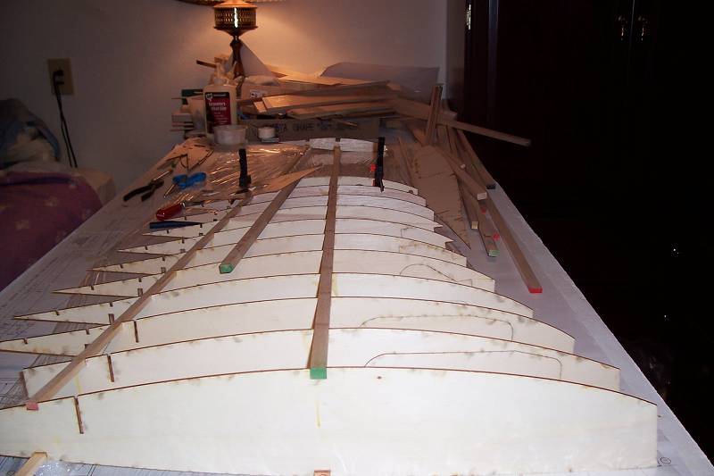

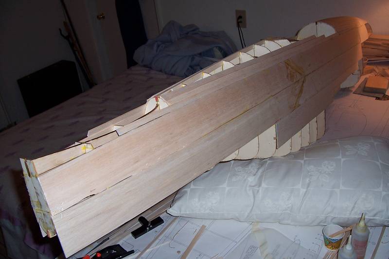

I am trying to post some pix. Not going well. I'll try again. I have started on the left wing. I have about half of it layed out and glued. I am up to where it breaks for the three piece wing panel. I shot a pix of the "jig", that is shown under the wing layout, to get the right amount of washout built in. I was kinda stuck, as I got rid of my real tool a long time ago. So I couldn't make a quality cut from the 1/2 inch end to the 15/16 end over the length of approx 48 inches with six more inches with three other measurements, and all I have left is a hand saw. ha ha ha. So, I went to the local craft store and got a piece of one inch thick by twelve inch by thirty six inch styrofoam and cut it very carefully with serrated kitchen knife. It worked pretty well. If you can see in the pix. It was much cheaper that way then having a carpenter shop cut it. I wrapped the foam with cling wrap to keep it in shape for the other wing.
The pix of the fuse, is just to show it in the corner where I have to keep it, standing by a door and my accordion.
When you look at the end rib, it sure looks like a lot of wash out to me. But that is what the print says.
