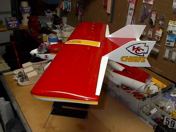

Well,let me explain first. After my first two Wonders ended up becoming my friends favorite plane to fly when the winds kicked up at the field,they all wanted one ....but did not want to build it?? they are ARF boys,anyway I like building out of a box of sticks,so I was elected to build them (i don't mind thats what friends do ..right??) So I have 4 Wonders to build and just finished up the first one,what can I say hes a KC Fan? so take a look and tell me what ya think?

Looks good. Are you building these all from kits or scratching them from your previous kit plans?

John,
These are Sig Kits,and the cost is only about $35.00 so its not a bad price......but by the time you finish them you still have about 250.00 +
but what the heck they are a blast to fly.....cheaper to just buy the kit.IMO

Nice...
Looks like 3 more fuses in the background? You ARE chargin' $20/hr., right?

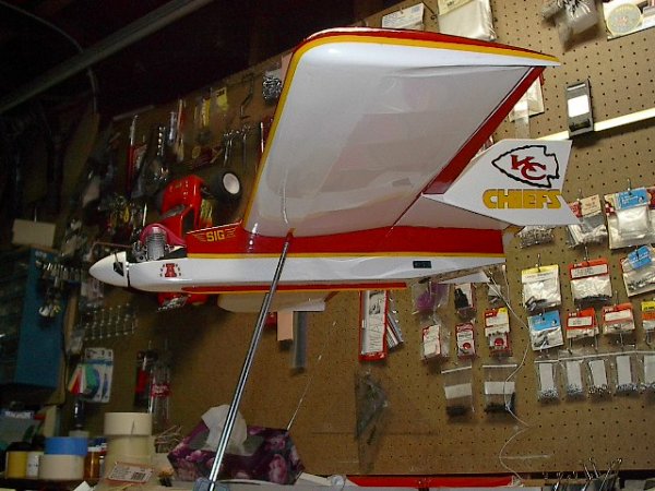

hey flyboy....does this looked Balanced???

Well,I took out the KC Wonder this past saturday for the maiden...what can i say this is a fun plane..the only trim needed was two clicks down. yoy know it still feels great when you build a plane and the first flight is perfect.WOW

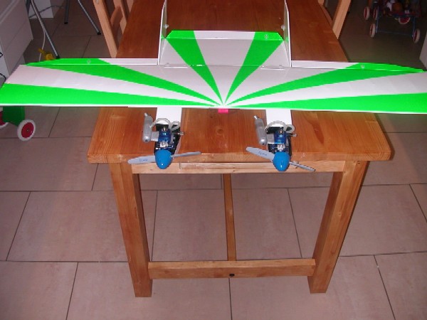

I fly this one, I bought it to a friend
he made a thread on rcu when he builded it, it's a blast

that thing is great!! im new to this sport and am learning all kinds of stuff, especially how many types of fun planes there are.
i want to get one of those, i think the twin engine is cool too, is that a customized version of the Sig Wounder or a totally home-made replica?? ether way it looks like a fun way to start with twin engine models

the wonder twin is a unique plane, it has been build by a friend of me, he used 2 wonder kit.
the plane is bigger in wingspan than the normal wonder, has two fuselages and a enlarged tail group.
all infos about the wonder twin project are here.

the wonder twin you see above fall from the sky in inverted flat spin like a frisbee and when fly by a good 3D pilot (not my case) is able to hover. we compensate the lack of rudders efficiency due to the short tail moment by mixing the rudders with the engines and we use assymetric power in aerobatic
