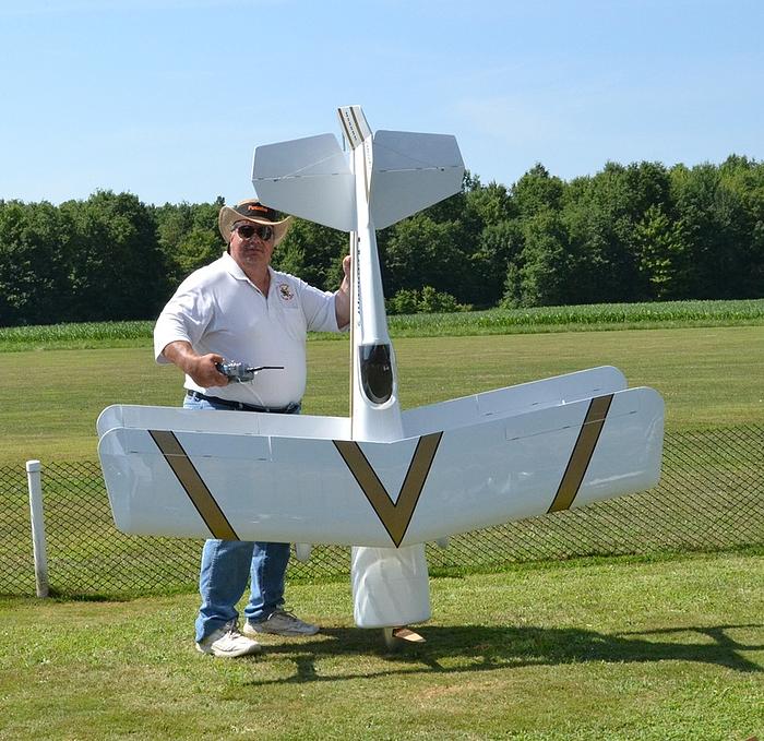

I fly it's BIG brother. I t belongs to a friend of mine who bought it from Miles Reed. It was the last plane he built. Miles had it ready to cover.
I knew Miles when I was a little kid.

Damn that's a pretty plane!

I'll let Bob K. now. He owns it and REALLY knows how to cover. I'm teaching how to put it through it's paces. I did a string of 27 rolls, Bob counted, w/o much up/down needed. It snaps and spins very well.
These are well balanced planes.
I'm more into classic (ballistic) pattern but is fun to fly an IMAC bird.
