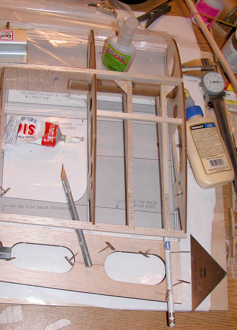

Some more pictures, notice the notch on the rear spar where the ribs join to them,and another with the shear webs are installed

Well got the servo mounting rails installed and I am now ready to sheath the top of the wing. When all was said and done I have moved the mass for the servos inboard by 8 inches. The mass of the servo has been moved from 11 ½ inches from the axis to 5 ½ inches. I am curious as to how that will affect the roll response???
I also manage to glue up the aileron for the left side, so at this point all of the internal structure of the wing is built. I had thought about installing blocking to support the aileron pull/pull guide tubes, but opted instead to use fairing on the guide tubes to secure the tubes to the sheathing after it is installed. There is more than enough room to fish them through the wing after it is sheathed and secure them to retainers near the servo mounts. Both of the servos and linkage will be accessed by a hatch installed on the lower side of the wing, which will be installed after the top is sheathed and the wing can be flipped over to have the bottom sheathing installed.

Work continues, on the wing panels left wing is sheathed and the right wing is framed up and ready for sheathing. If you look closely you will see the blocks added for the hinge point mountings. Given that I up sized the rear spar/aileron mount they may well be overkill but I added them anyhow. In the course of this build I have made the decision that the ailerons need to be shaped to fit the contour of the airfoil better. In order to do that I will be adding a carbon fiber rod to the rear of the Aileron/Flap sections that will be used as a guide to sand the ailerons to shape before a 1/32 thick sheathing is applied to them, to which the carbon fiber veil will be applied after. Given the stressed skin construction I am looking to do this should not adversely effect the overall strength of the aileron or flap pieces, and remove a lot of weight and drag that I would have had with the slab ailerons. The best part of this is that now I am closer to being able to start on the construction of the fuselage, to which I intend to make many modifications to enhance overall performance as well as add side area ahead of the COG in order to improve Knife edge performance. A good portion of the added side area will be due to the inverted engine mounting, full cowl and hot air exhaust that will be added to the lower forward portion of the fuselage. As Red B. said in a post regarding the knife edge performance on a thread asking about Something Extra Mods. the real solution is to add side area rather than just increasing fin and rudder area which is a stop gap solution to the problem.
One additional note.
In the manual they say that when the top of the wing is sheathed and removed from the board it is easy to twist. I am not sure if it is the boxed spar, additional framing for the servo mounts, or the full sheathing; but the left wing is very stiff and resist twisting. Now I still intend to support the wing as they instruct in the manual when applying the bottom sheathing, I am very pleased at how rigid the wing is even befor the bottom sheathing is in place and how light it feels.

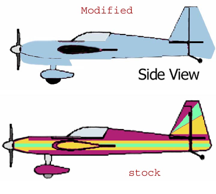

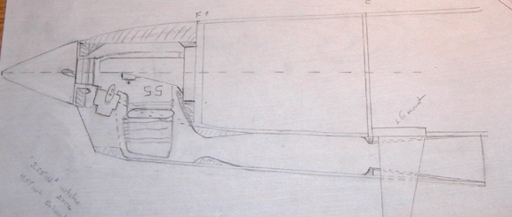

Finished up gluing skins together and am now sanding before sheathing wings.
In the meantime, I have sketched out the rough side view of the cowl and cooling exhaust. This arrangement will add approximately 16 inches in side area to the fuselage, most of which is ahead of the stock COG. While I am fairly sure this will make the KE performance much better I am concerned this may affect spiral stability. Although adding more rudder area should negate this (I hope).
Because of the mount and the OS 55AX engine I will be using the prop mount is about 5/8ths of an inch forward of the stock location. After I get the fuselage framed up I am going to have to do some weight and balance work to see if I am going to have the COG close enough.
#41

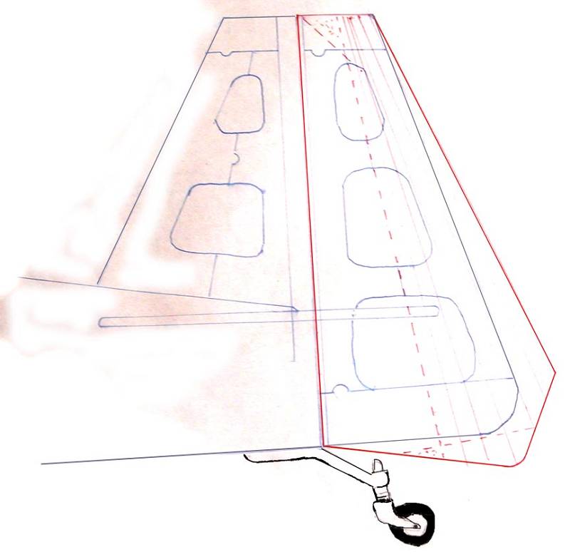

Still working on sanding and sketching out the mods to the fuselage and tail feathers, man I hate to sand...
Anyhow, I have added the sketch that shows both the cowl and cooling ductwork that I plan to add to increase the side area of the fuselage and rudder. The blue shows the fin and rudder as on the plans the red is the added area along with where it will be tapered.

I too have toyed with the idea of a pipe enclosed in the fuselage, but it does not look like it will be in the cards.
Thanks for that somegeek!!!
Bob and Imd,
I am going to start out with a 12/6 for the maiden and first few flights, and then go down in pitch from there. I understand that this is designed as a slower aerobatic airplane think that it will perform a lot better using a low pitch prop in the long run.
The only reason I am using the OS 55ax is that I have the engine and it is real close in weight to a 46. I do have a 70 fl four stroke that I could use but we are talking more weight, although there is a flex header I could use to run the exhaust out of the cooling duct.
