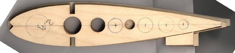

Well tonight I actually started work in earnest. The first thing that hit me as I was separating the plywood ribs from their sheets and labeling them was the weight. W1, W1A and W2 were very heavy in my hand. I set them aside and continued to separate the rest of the balsa ribs from the sheet. After I glued up the spars with their doublers I pulled out the digital scale and weighed the plywood parts. They weighed a total of 4.8 Oz. Now I am doing a lot of modifications to this plane one of them being that it will be sheathed, and then finished using carbon fiber veil applied and then finished with dope. By doing so I hope to gain some strength without adding a lot of weight to the finished airframe.
It is going to have hard points on the fuse for carrying both payload and weight, one reason is for utility purposes and the other to work on my skills flying a plane with high wing loading.
Now with this having been said we go back to the weight thing. I want to maintain the flying weight target of this plane at the design range of 4 to 4.5 lbs. That is a total weight less fuel and payloads, so I have a 64-72 oz. range. The engine I am going to use (OS 55ax weighs a total of 18.6 oz. So let’s take that right off the top that give me 45.4 to 53.4 oz left for the airframe, servos, receiver, landing gear, and battery. So now if we look at that 4.8 oz we can see that that is roughly 10% of my total remaining weight.
I figure I can lose some of the “slab of wood†by adding some lighting holes to the ribs. So I marked them off tonight and will drill them in the morning on the drill press.

Know the old adage measure twice cut once?
Well save myself some problems by just doing that...
Had I just drilled out the hole as I intended I would have just missed the hole for the wing dowel used to prevent the wing from turning about the Spar Rod. Also by double checking it gave me some time to map out a better idea for reducing weight of the components.

Paul congrats for the new project.
In my opinion, don’t drill too many holes because a hole is a point of stress concentration, from my experience drilling holes for weight loss is a lot of work for a very small gain.

Alex and Dave,
I have the same concerns as you regarding removing some of the ply from the root ribs. But if you noticed the markings on the photos above, I have allowed a lot of "meat" to remain adjacent to the high stress areas. Also rather than using monocoat or plastic covering I am going with a fully sheathed wing covered in carbon fiber veil (tissue .02 oz./sq. yd. ) and am looking at that to form a stressed skin to add overall strength to the build. Now you mentioned the area adjacent to the wing tube I have a question about this I did not note any mention about filling the area between the wing tube and spar with shear web or balsa. I would think that you would want to tie the spar as directly as possible to the wing tube possible. I intend to fill this area with webbing anyhow to maximize the bond of the spar to the wing tube. Another critical area you mentioned is the dowel socket, where I am going to use fairings or fillets between the wing and fuselage, the load on this dowel should be reduced by a large percentage (I hope). One other change I am making to the wing is to sub. a 1/4 X 3/8" rear spar/Aileron mount notched to go around the rear of the ribs, instead of the 1/4 X 1/4 butt joined spar/aileron mount called for in the plan.

All good points.
Also, if I remember correctly sheet balse is stuck over the two tip ribs just to finish them off. I see no reason why that shouldn't be left off completely to reduce weight.

You intend to put there a very strong motor, don’t be worried by weight, it will rocket up.
As for stress, general idea: mechanical stress treated best if you spread it, instead of one point better to spread it onto an area.

Ok so here is an update:
The original weight of the ribs W1-W2 was 4.8 oz, after drilling out the ribs as drawn they now weigh 3.3 oz. That is a savings of over 31 % in the weight of these 6 components. Originally the weight of the ribs for the wing panels would have been 6.8 oz, now we are looking at the component weight total being 5.5 oz I would not call that insignificant at all. Total time for drilling cutting and sanding was less than ½ an hour, not bad pay back, and just here I have more than compensated for the adding of two HS-81 servos for the flap function on this build.
