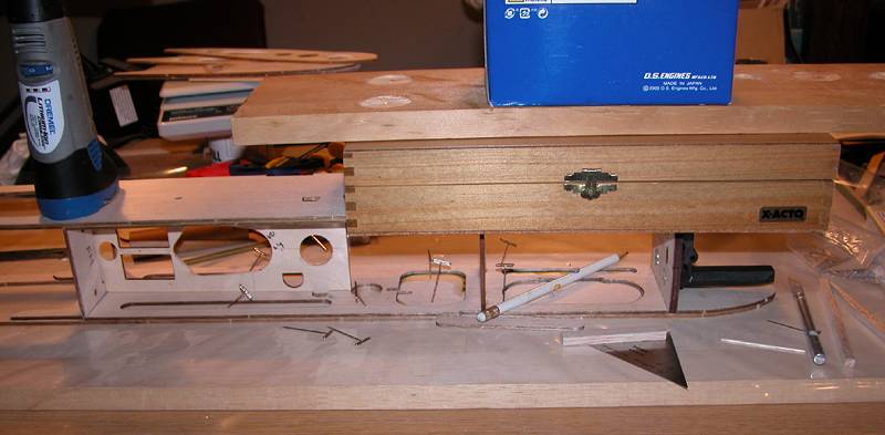

Well finally got back to building tonight and as I was waiting for the fuselage side doublers to dry I started to read through the manual again. Every time I got to pg 13 and read step 48 I got a bit more concerned. The reason for that is if there is any problem with the relationship of the wing panel roots to the fuselage that must mean that something is out of square. Since the wing panels are built on the plans lets assume for a moment they are square, so what does that leave? That only leaves the fuselage itself as the issue any misalignment of the formers and you’re going to have one side or the other out of line and that will skew the fuselage sides making the wing tube no longer 90 deg. to the fuse, and create a problem with where the root meets the fuselage. Now by the looks of it only the formers and the servo tray serve as the means to keep the fuselage sides in the proper orientation to each other.
Given that we are working with wood and it is not an absolute perfect medium how much of an issue is this?
Am I being overly concerned with something that is not that big or common of a problem? I notice that they make no mention of what you can do to correct the problem in the manual, and I have read of others using fillers sanded to shape when they encountered this problem.
But my trying to think ahead has come up with a whole myriad of problem this can cause down the line up to an including having a twist in the fuselage as you build up the tail by adding formers and the top and bottom. From what I see they look at the components and there installation as being the thing that keeps the fuselage square and straight. As a matter of fact I recall that when I built the lt-40 for my wife this was the case. During the course of that build you assembled the fuse with rubber bands and tape and did not glue it till all of the components were in place and it had been checked for being straight and true. After all of the stick building I have done, this seems to be a bit of a leap of faith as far as building the plane and wonder if it is a real issue, or as usual I am getting stressed over a very minor detail.
Looks like no fly weekend for us, that is, unless your into some wind chill....

I am really not trying to be critical here, I just think that it would be far better to not glue up the servo tray, landing gear block, or the reinforcements for F1 prior to fitting the wings to the fuse and make sure it is square before every thing is set in stone by gluing them up.
And I wanted to get opinions of other builders are far as their thoughts on it, before I proceeded. Perhaps it is not as much of an issue as i think and I am just bing to fussy about the whole thing.
As far as the tail, I intend to build over the plan so that I will be able to keep in in proper alignment, and where I am making some changes to the structure such as adding longerons to the bottom of the Fuselage so I can round it out on the lower edges rather than leaving it square or only the edges rounded out. I wanted to get some input from others whom have built these before and their thoughts about the build.

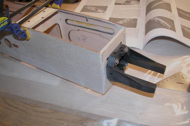

Well got the formers glued up then installed the second side.
I did not glue the servo tray in place yet, I will do that when I square up the wings and fuselage, before I install the tri stock behind the firewall. You may note that the servo tray has been lightened up a bit, the servo for the throttle is going to be relocated, save another .2 oz. here. I know it may seem I am obsessed with weight but a little here and there adds up over the course of the build.

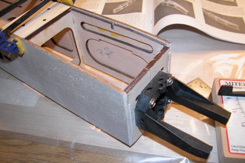

Got a bit side tracked today watching the Pats v Chargers....
But I did get a few things done despite the distraction.
As I mentioned before, I put the wing tube and dowel into place and test fit the wings. The joint between the wing and fuselage looked good, so I glued the servo tray and wing tube into place. I then went on and installed the hatch mount plate, and the landing gear block. You might notice the cheeks were cut off the fuselage now where I am going to build a full cowl they are just in the way at this point. I also added a bit of wood to the bottom of the firewall, this was shaped to fill in the small void of where the fuselage bottom would meet the firewall. I need to beef up this area a bit where cowl cheeks have been removed and there is a larger engine that is going to be use in the plane. Add to that the fact that the engine is going to be inverted and because of that the plywood tank floor can not be use as I need to bring the tank down as far as is possible to match up with the engine setup. I also included a shot of the tri stock I added to the landing gear mounting plate. Since I am not using the stock gear, I am going to use the Du-Bro Cat#789 setup so I can use larger than an 11 inch prop with out having to weed whack with it.
