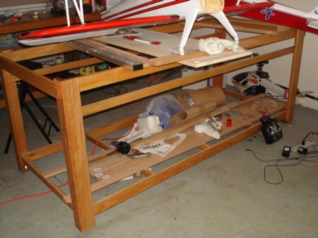

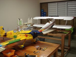

My building table is 7'x3' and the glass that I ordered is 1/2" thick and tempered. I will be using the magnet systen that is on the airfield models web site. I ordered the magnets and the wood needed to make the fixtures and just waiting for everything to arrive. I'm not worried about breaking the glass table, I'll use my ARF table for anything other than laying down sticks
. Here is a photo of the table (the one in the back) before the glass and the two shelves. I'm still in the process of putting my shop together but not having it completed hasn't stopped me from having planes, it's a work in progess.
AJ
. Here is a photo of the table (the one in the back) before the glass and the two shelves. I'm still in the process of putting my shop together but not having it completed hasn't stopped me from having planes, it's a work in progess.AJ

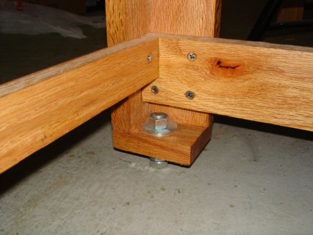

I like Ken's table frame, very simple and sturdy. I want to add for the leveling, you can buy adjustable furniture feet at Home Depot (Lowe's, Rona, etc.) that you drill a hole into your leg (or support frame or whatever) and then a threaded socket goes into the hole and a threaded foot screws into the socket. Use about 6-8 of these around Ken's frame (with the feet pointing up to support the top) and you can perfectly level and support whatever building surface you choose to use. They are infinitely adjustable and allow you to re-true everything as often as you want in only a few minutes.
Mark

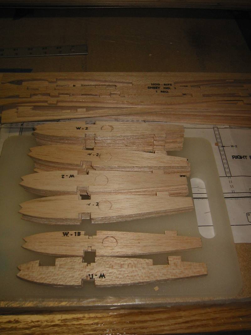

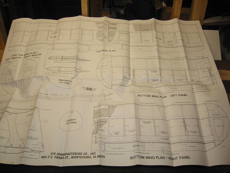

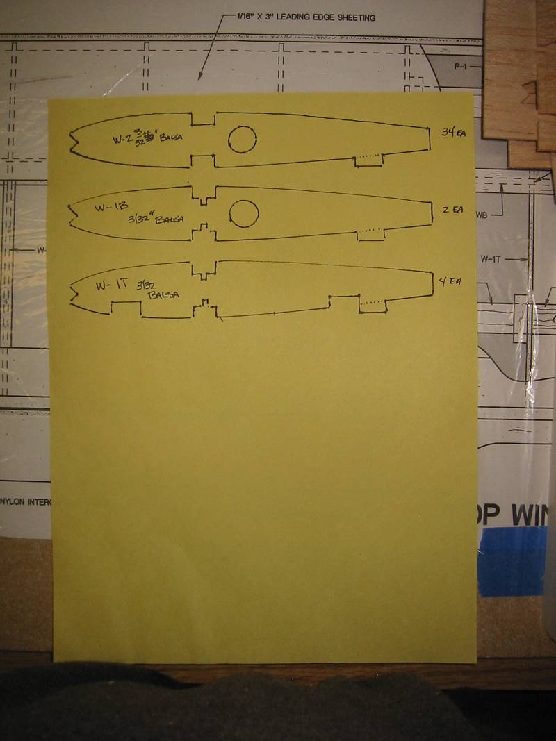

So I identified the wood pieces and marked each so I could later identify. This also got me familiar with the kit contents. This always takes more time than I think its going to, but its worth it later so you don't mistakenly use the wrong wood. Everything starts to look the same once the balsa dust starts flying ... this gives me a fighting chance that I'll at least be using the proper sized wood if nothing else
Since I don't yet have the Saito, I am going to start with the wings. Heck, there are two of them so I might as well start here ... I'll be seeing ribs for a while! The Hog Bipe is not completely laser cut like some of the other Sig kits. The ribs are die-cut and you need to be careful popping them free. There are tabs on the ribs that are made to break free once framed up on the building board - because they are designed to break, they can/will snap off if you're not careful. I found that working out the end with the tab first saved me a ton of frustration. Overall, it was much easier to extract the ribs than I figured - I only used a blade a couple of times and I only had to CA 2 tabs back onto their respective ribs (very small amount - tack glue only).
At the end of this, I called it a night. Hey, I'm pacing myself! I've got a club meeting tonite and will likely get back to the build this weekend. CA will meet balsa very soon! [8D]
Picture1 - Ahh, the beginning of the build - pristine bench, crisply folded plans, nothing but balsa, ply and some hardware - feel the anticipation!
Picture2 - Wing Plans
Picture3 - Die Cut Ribs
Picture4 - Progress. My little pile of ribs
Picture5 - A little tip. I am preserving an outline of every part so I can later scratch build a Hog - if I am so inclined. Capturing the outline of the part and the size of the wood is all I'll need. I'll scan this sheet when I'm done so I can electronically store it.

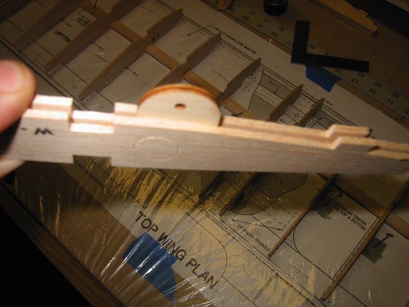

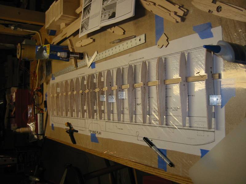

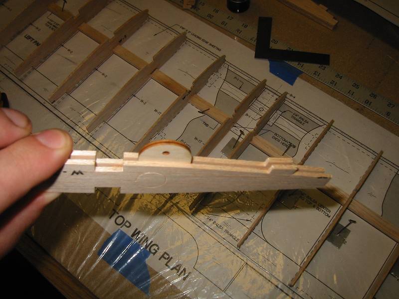

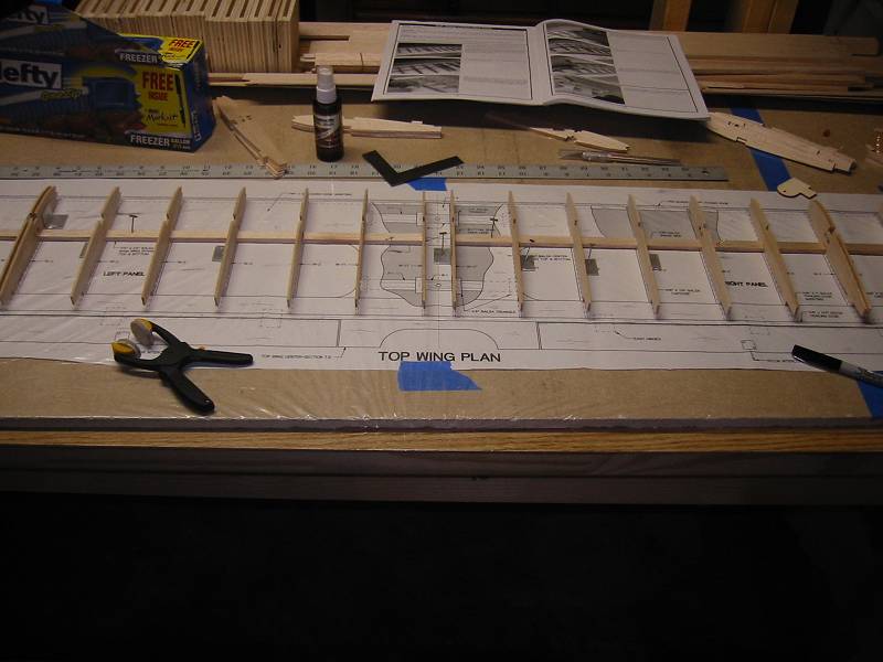

I got a bit more work done last night ... not much, but any little progress is just that - progress.
I note for others building this kit - don't blindly pop out the circular die-cut disks in all the Ribs, you only need those removed between the bottom wing center extending out to the aileron servo - if you're doing the dual aileron servo mod. This is so the servo leads can pass through the wing. After popping out 2 disks, my spidy senses started tingling and I re-evaluated "why" I was doing what I was doing. "Hey the top wing has NO servos smartguy"! Fortunately, I realized the error of my ways. Maybe this saves someone else some grief.
Below are some progress photos
Pictures1&2 - Top wing, ribs in place and CA'd down
Pictures3&4 - Towards the outer portion of the wing, you have to space 2 ribs between part P2 (Ply Connection to Strut). Took me a few minutes to find this on the plans. Anyway, this is what it looks like - oh, and yeah they're upside down in the picture
Picture5 - Do do not glue in P2 at this time, so I clamped the 3 parts together, CA'd the ribs to the spar and removed P2.

Concerning removing the center hole in all the ribs. It is a good idea to remove them all.
The reason is that when you applying the monokote, the iron will heat and expand the air inside, between the ribs. With the holes in the ribs, the heated air will move into other areas of the wing and not present a problem by 'puffing' the monokote between each rib like a balloon.
This is also true on a hot day when the plane heats up due the sun.
It really is standard and not a problem to remove them.
Nice pictures and great documentation of your build!

Cubfloater: I was a little "weirded out" when i built that part of my hog bipe as well. However, that is what the manual calls for. There are a few other things later in the wing building that beef that part up including a solid top spar, a wing joiner as well as two cabane mounts the span a couple of ribs. All said and done, the center of the wing seems to be pretty strong. I still plan on fiberglassing the center section on both wings given that this plane is a real performer!

ORIGINAL: FlyBlueSkies
It would be great to have a copy of your outlined ribs...
ORIGINAL: Cubfloater
I couldn't help but notice that you don't have a continuous spar through the center section of the top wing. Isn't it supposed to be? I built one a couple years ago but can't remember. It looks like I see where it's supposed to be on your plan. If I'm wrong please forgive me just can't remember.
ORIGINAL: *JCB*
