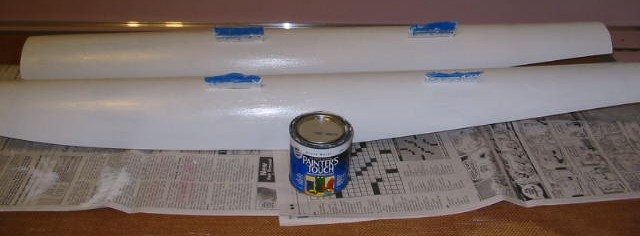

Originally posted by 4*60
Painter's Choice hasn't even "dried" in days on epoxy resin/glass floats. Got some good advice on these here fiorums I must say.
It is a rust-oleum product. I am talking about the water based stuff in the pint and quart cans that you brush on.
I think there is a version of it in a spray can that is solvent based. I could see that not "sticking" to epoxy resin floats.
No idea what "Painter's choice" is.
My Feedback: (41)
OK OK so it's Painter's Touch. I thought I picked up PC. Anyway, it's the solvent based spray paint. I guess I have lived on another planet all my life. I thought the spray would be the same formula as the other.
I wish I would have read solvent vs water based before using/purchasing.
