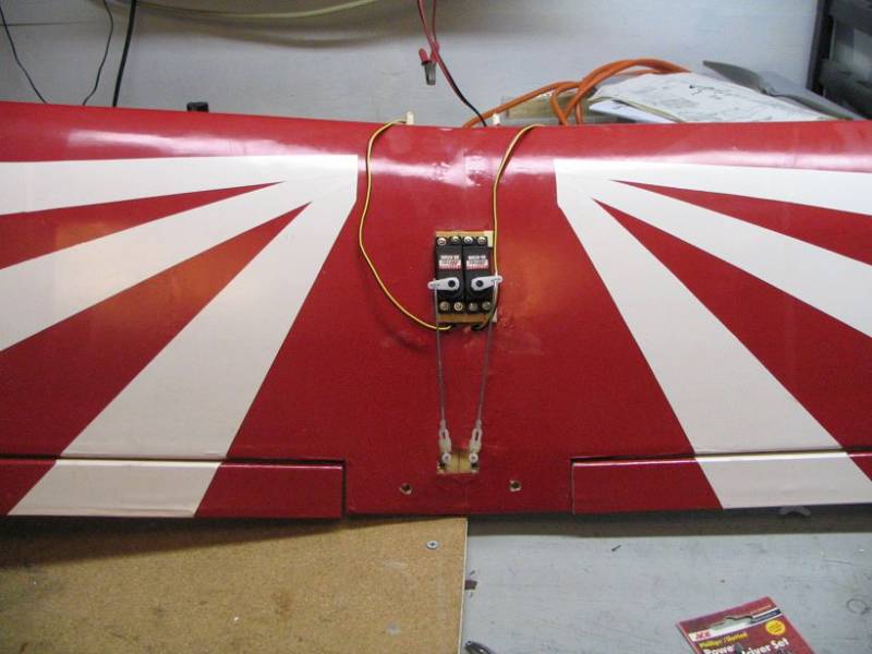

I found this picture here in RCU, its from an astro hog build
What do you think about this aileron servo setup compare to:
1) one servo in the middle.
2) Two servos, one inside each wing
I figured its easy for me now to change the wing into this.
Alex

It would be good for mixing flaps and such. Also in case you had a malfunction you could still turn the plane. I have never seen one done like this. Most of the time dual servos are mounted more towards the middle of the wing. I will have to remember this one.

That's the easiest way to retrofit an existing plane with torque rods. You gain torque, redundance and can mix in flaperons, plus you don't have servos out in view. The downside is that you still are using torque rods, driving the surface from the end instead of the middle.

I did a conversion like this on a quicke 500 I have. The orginal standard size servo was mounted at 45 degrees to the wing, I replaced it with two mini servos (got an additional 10 in/oz total torque also) It worked out very well. I only ran into one problem, if the throttle was in the stop position, the extra rod protruding from the servo conectin was locking out the left aileron. I found this on a dead stick and as I started to make my final turn, it just wouldn't turn. When the engine flamed out, I cut the throttle and was having a nice aproach until the speed dropped enough that I needed both ailerons to bank it into a turn. I was so taken back I forgot about the rudder.
The quicke 500 has a very tight radio setup and the two small servos helped quite a bit in this case. I'm rebuilding the wing now after another crash and this time I'm going to put the mini's outboard a bit. That will give me additional clearance inside.

Ok so its not a bad idea I guess
And if it wont interfere with the throttle that’s what im gonna do.

The original Astro Hog just used a single servo where your picture shows 2. This definitely makes it easier to set up the ailerons using a modern computer radio with more than 4 channels.

Are you going to center the left hand servo? Otherwise you're building in a little differential.

Actually that's the Sig kit. The orginal Astro Hog used a single servo with pushrods that went to bell cranks in the wing with rods that went out to the barndoor ailerons.

It works. I've done it. But only once. I hate torque rods. If I want to convert a wing to dual ailerons, I'll just cut open a bay in the middle and do the work to mount them out there.
But, nothing wrong with the pictured way of doing it. It does work.
