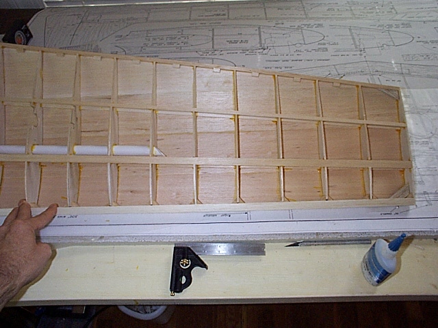

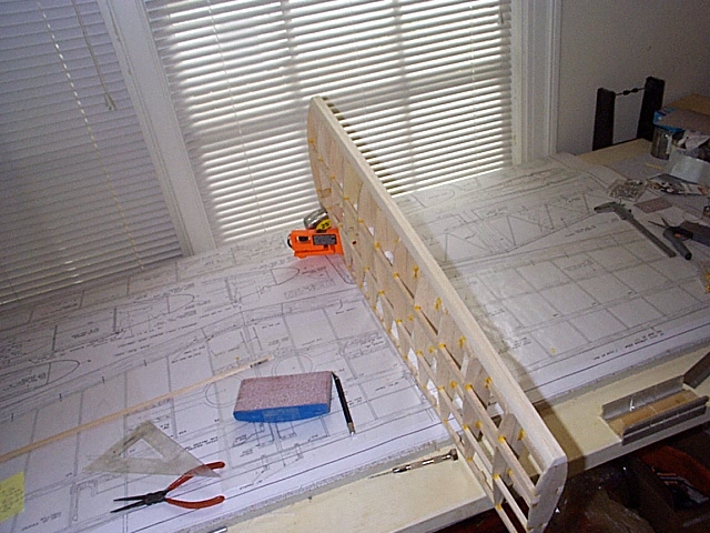

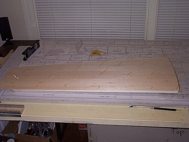

I began sheeting the top of the wing panels yesterday. I'm not sure if it's the best way but it worked.
First, I carefully sanded the leading edge bevels using the guide lines I scribed on the balsa leading edges before the wing was built.
Second, I pinned the wing panel to the plan top side up with the 1/4" stick in place so the wing wouldn't have any twist. At this point I glued from the trailing edge to the main spar and just pinned the sheeting to the leading edge. After that was dry I removed the leading edge pins so I could reach in and take out the pins holding the wing to the board!
Third, I glued everything else including the leading edge. While pushing the sheeting down tight against the leading edge using the building board as a straight-edge, I tack glued the sheeting to the l.e. with ca glue.

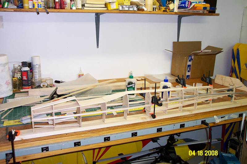

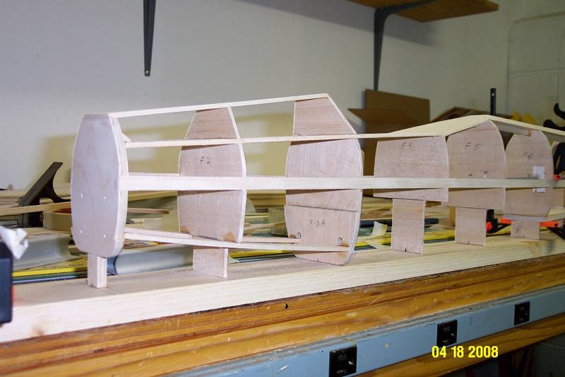

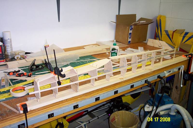

I have good news, today I started building my Duelist....
I decided to start with the fuselage first, I bought a pine board (1" x 3" x 6') for a building fixture and glued all formers F-1 through F10 on the board. It definetly helps to keep everything aligned, next I installed 1/4" x 1/4" stringer on top of formers from canopy back to F10, next I was going to install crutch on both sides but decided to wait untill I have both pushrod tubes installed, don't know if I should glue them in permanently yet or wait untill the 1/8" sheeting is dry fitted?
Tomorrow I will install the crutch on both sides....
I'm using Tibond Carpnters glue so it is going to take more time waiting for the glue to dry, I try to stay away from CA Glue if possible, fumes are getting to me.
I'll try to post a picture tomorrow.
So how is your project coming along it has been very quiet here latley...

Mike, here is a picture of my project, hopefully it will look like a Duelist when done...
Question for you Mike, did you get any written building docmentation with your plans?
I'm working strictly off the plans, some of the detail isn't clear especially the front half of fuselage, but thanks to your pictures it has helped me quite a bit, Thanks....
I'm dreading when the time comes to prep the fuselage for the side sheeting, there is some sanding shaping of the top and bottom 1/4" sheeting that runs from the canopy and back and from the trailing edge of wing to the back.
Did you cut out the wing saddle and cokpit area out of the sheeting before you glued it to the fuselage?
I'm open for any sugestion that you might have, by the way this is my first build working strictly off the plans...

#63
Ulf,
Nice! I just reread my fuselage sheeting description and it's not real clear the way I wrote it. I beveled the top and bottom pieces of the fuse before attaching them to the fuselage but thats probably not critical. I would suggest marking light guidelines with a straightedge so your sanding ends up nice and straight. After making the sideskins from sheet stock I marked two points on each that I could locate on the plans and on each side of the fuselage. I chose the center of the crutch at F3 and F6 bulkheads. I also marked a reference line the full length of the sideskin to mark the center of the crutch so I would know where to place holding pins and to help establish a reference line later when I set the wing and stab incidence. Next, I traced a paper template of the wing saddle off the plans that included those two points, lined up the points of the template with the same on each sideskin and cut the saddle out before attaching it to the fuselage. I didn't do any other trimming to the sideskins prior to attachment because I felt I would need something to grab onto while coaxing the skins around the bulkheads. If you are using 3/16 sheet it'll be much easier than mine was and you might find it convenient to trim some off the lower part of the tail. Still, have thin CA and rubber bands on-hand and soak those skins good! I trimmed off excess sheeting as I went. When you align the sideskins to the fuse press a long straight pin through each reference point on the skin, then with the skin an inch from the fuselage, get the point of the pin into the fuselage at the same reference point. This makes the wing saddle line up nicely with the fuselage on both sides. Mine came out perfect (much to my surprise). I wish the wing ribs....um, nevermind.
There was a two page article with my plan but it had nothing in it regarding construction. It was all about what inspired him and some of the things he did when developing the thing. If you PM me a fax I can try and send you a copy.

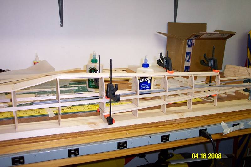

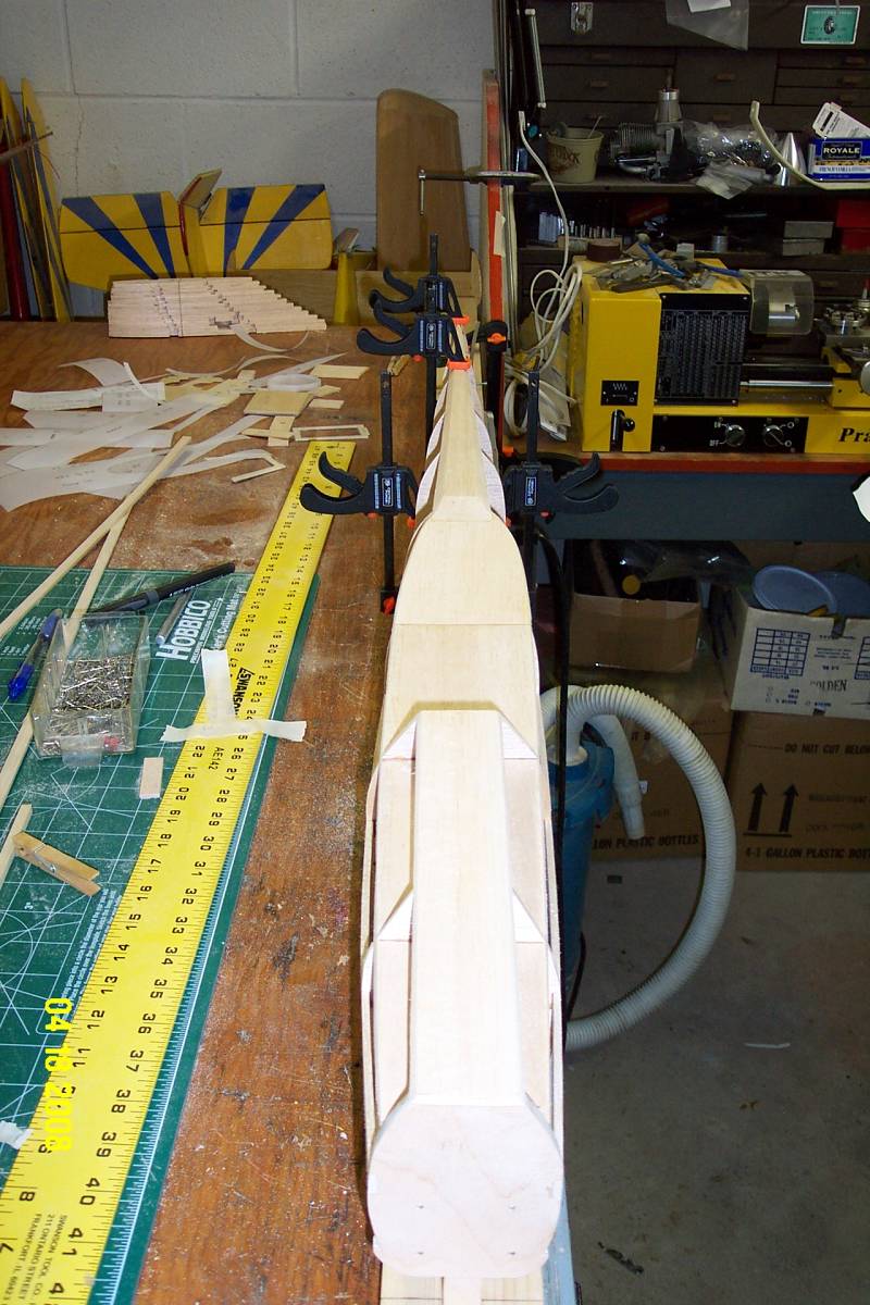

Here is a few pictures of todays work...
I'm getting a little closer almost ready to skin the fuselage.
I made a test sample using 2 types of wood glue, I'm gluing together 3 pieces of 1/8" balsa together and then I'm going to soak them in water and see what happens when I bend the sheeting.
Titebond 2 = Weatherproof according to the manufacturer.
Titebond 3 = Waterproof according to the manufacturer.

Ulf, your doing a great job. My main concern when sheeting the fuse was keeping the thing straight. There is a lot of force required to bend everything together even in a soggy state so you must have the structure attached to the board and bend each side at the same time to cancel out the forces acting on each side of the plane. I started at the saddle and pinned along the crutch toward the tail, then turned around and pinned toward the nose. next I forced the sides together just aft of the cockpit area and while holding it in one hand, tack glued it in place with thin CA. I repeated this toward the tail, always pulling on each side with equal force. You will probably want to trim away excess sheeting as you go so you can see where your tacking. I also felt better checking eyeballing the fuse from the tail periodically to make sure I wasn't building a bannana!
In regard to 1/8" sheet, if you have light stuff it's probably no biggy. Much of mine was kinda heavy and stiff so I really had a tough time with it. My fuse is built like a tank! Let me know how that Titebond III holds up in the soak, I'm running low on II and will switch if your happy. Regarding spars, again, my wood was on the heavy side so I put the densest balsa on the lower spar and the less dense on the upper. (Airplanes pull more positive G's than negative during their service life.) Instead of spruce, you might put some 1/16 shear webs on the back side of each main spar pair with the grain vertical. That would be lighter, much stiffer, and possibly stronger than spruce substitution. One place that should be strong is the stabilizer leading and trailing edge. At high speed soft balsa can allow flutter to tear/break it off. This occurred on an upsized 2/60 version of this same plan a couple seasons ago.

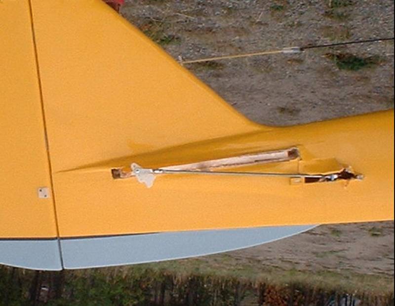

I'm glad you mentioned about the tail being a possible weak spot, I'll have to see what I'm going to do to beef it up a little, I have the same concern after building my CG Extra 300 that is now just about completed, it seems flimsy and is only sheeted with 1/16" balsa (very soft balsa sheeting used), I kind of regret not beefing it up more, but it is too late now...
I just finished the testing of Titebond glue, I soaked the test piece for about 35 minutes in warm water with amonia and none of the glue disolved when rubbing my finger on the glue joints so that is good.
But I'm afraid my test wasn't very sientific, I started to bend the wood and it held up good enough to follow the contour of fuselage but the Titebond 3 did snap the glue joint first, but that part of the wood was definetly harder wood than the glue joint of Titebond 2, it felt much more flexiable but it also snapped after bending it some more.
I do like Tiebond 3 best for building, but I did not test with CA Glue so I am still undecided which way to go.....
Thanks Juan, yes I'm going back to work so my building is going to slow down some, I hope to have the fuselage skinned this coming week if I can decide what type of glue to use.
