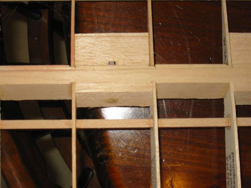

Here are a few pics. I've tried to show how I added extra balsa in which to attach the Robart Hinges. Also there's a pic of my new fiberglass parts I just recieved.

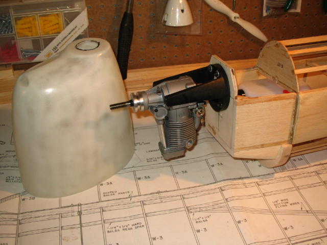

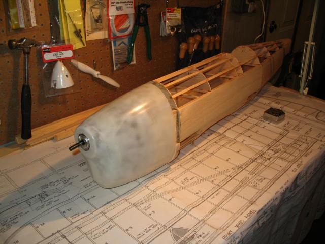

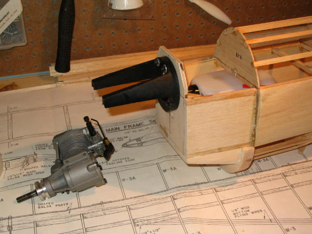

I finally was able to work on my Ryan, I wanted to go 4 stroke, settle on a Magnun XL 91, I used a Dave Brown mount 90FS-9004.
manufacture recomended a 5 ply for firewall. and I moved the firewall back 15/16". I ended up installing some of the front blocking on the bottom, out of step of the directions. was having trouble centering firewall. this made it easier for me. it should be dead center now.
I need to fasten gas tank, I am using 14 ounce DU-Bro manufacture says 12 or 14 ounce. not sure on how, I saw a thread that talk about fuel foaming, will use some foam around tank. and velcro. (any suggestions). need to run line for throttle, then I can close fuse[ up with sheeting. I I'm going to try to list pic's.

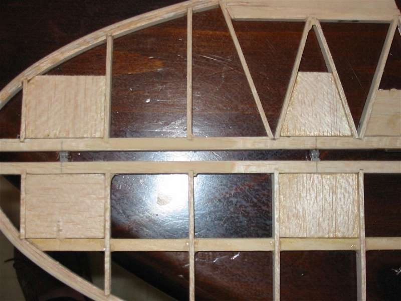

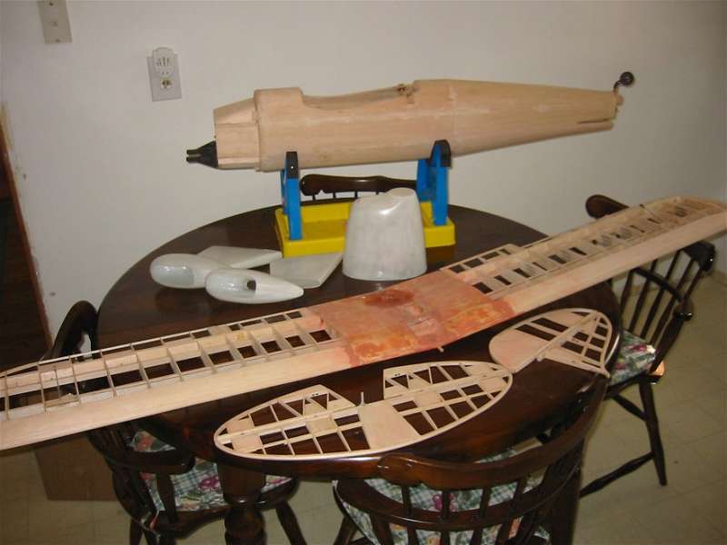

I haven't been very busy on my Ryan, and there hasn't been any new post's, I have gotten the bug again, my fuse is close to being done except tail wheel area. need to assemble it. elevator, and stab and rudder rough out, need to install robart hinges. wings about 1/2 done.
it was neat to laminate the curve area's on the rudder and elevator, stab. need to install the wire on the elevator pieces.
will have to make one. kit short part. pick up piano wire. I was wondering about what to cover the Ryan with, Fuse, wings, tail area's.
mono type covering, silk, (glass? for the fuse). would like to do the red and white. lots of plastic parts to paint. ???.
any suggestions. Thanks Chris.

Hi - my comments would be based on the other relevant subject : weight!!
Id cover the wing in film - nothing heavy. The Fuz would be nice glassed - but only if you can do it light - maybe also keeping your construction & gear as light as poss.
The wing area on this bird is not tremendous because of the narrow cord. I also fly with the os90 four stroke - although you have more oomph with yours being a surpass!
I need to weigh mine to give people an idea!!
